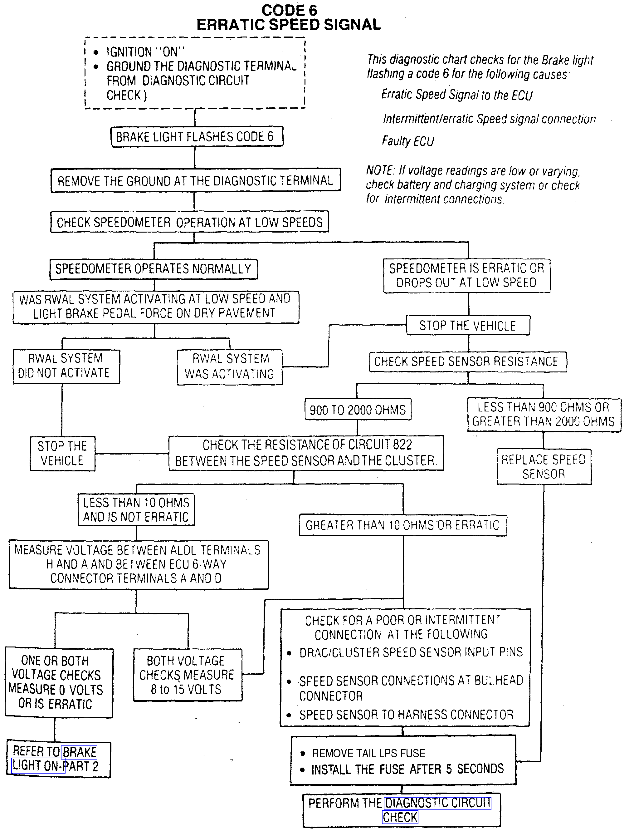

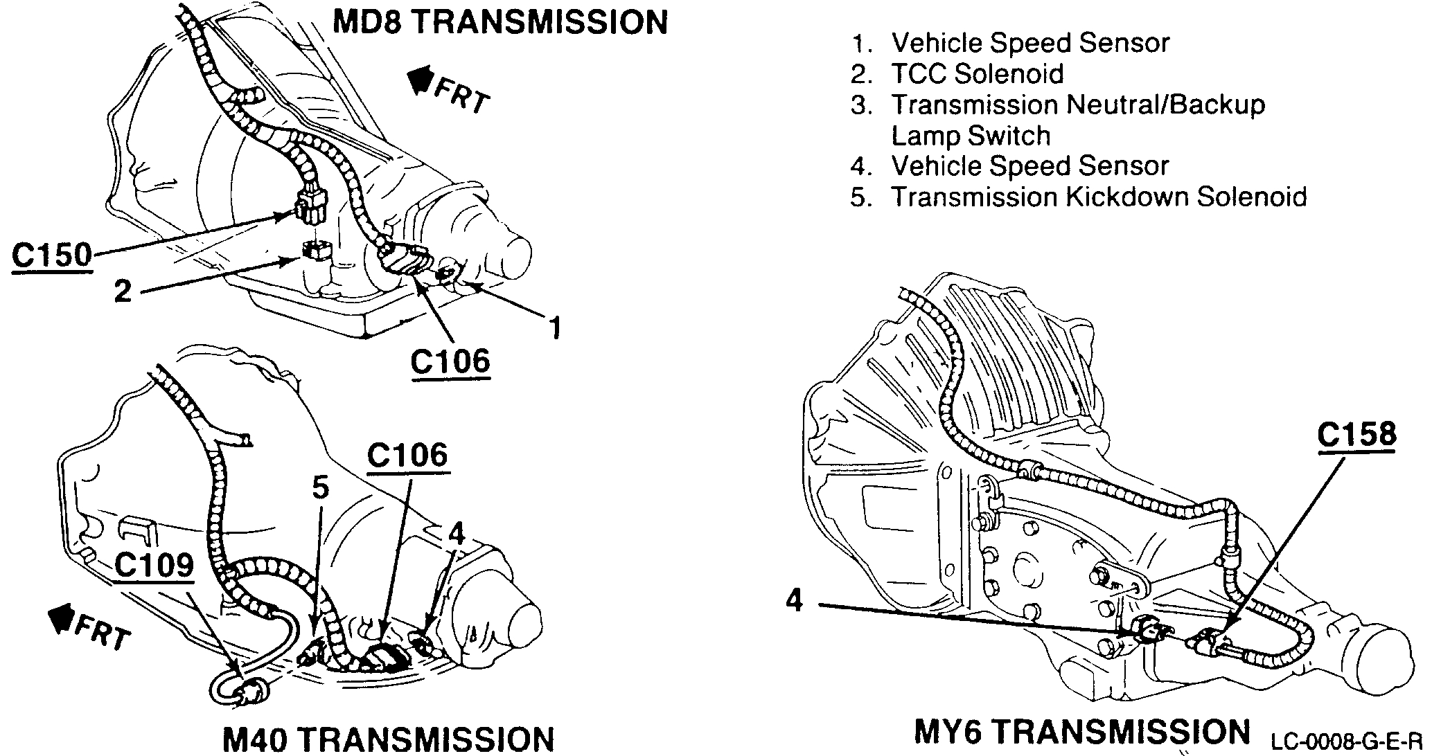

Brake light in dash flashes a code 6, which according to chart, is a bad speed sensor. My van is a g3500, 350 v8, 400 turbo transmission. I do not know where speed sensor is located. Can you help?
Oct 21, 2018 at 11:33 AM
  • 110,240 POSTS
The code indicates an erratic signal in the speed signal. It could be a bad sensor, partially disconnected sensor, or damaged wiring/connector/corrosion. I attached two pictures for you. The first one indicates the location of the sensor (left side of transmission). The second is a diagnostic flow chart.

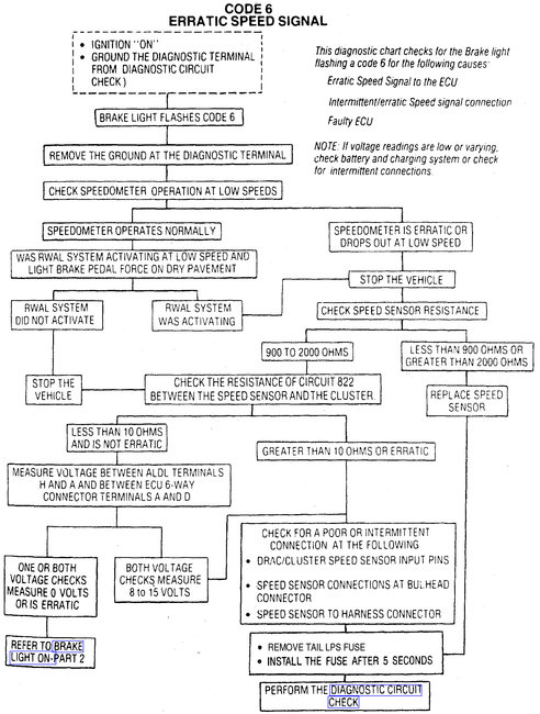

Let me know if you have other questions or need additional information. Also, ignore picture 2. For some reason I cannot delete it.

Thanks a lot. I now know location of sensor. I will check it out Tuesday. Again, thank you very much and I will use 2carpros again.
