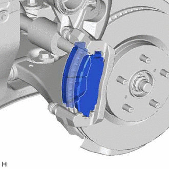

Recently i have noticed on my car when i got on highway speed when hit the brake the brake vibrates especially when i am driving from hill to down. Is this related to rear rotor I think I need new brakes can you help me do the job?
Jun 5, 2020 at 3:22 PM
  • CAR REPAIR CONTRIBUTOR
  • 110,190 POSTS
The vibration you feel is likely due to warped rotors. It can happen when they overheat. As far as replacing the front brake pads and rotors, it really isn't too hard. Also, you are right at the average mileage, 25,000 miles, for them to need to be replaced. The good thing about doing it yourself is you can get lifetime parts at a parts store. That way, you won't have to pay for parts again while you own the vehicle.

CAUTION:
Be careful not to get pinched by the front disc brake cylinder assembly or other parts when removing the front disc brake pads.
After lifting up the front disc brake cylinder assembly, secure it in place before performing any work on it.
pic 1
The front disc brake cylinder assembly could fall, pinching hands or fingers and causing injury.

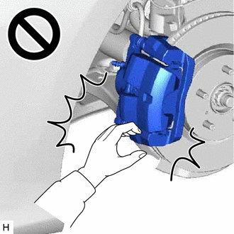

Hold the front disc brake cylinder slide pin (lower side) and remove the bolt.
pic 2
NOTICE:
Do not kink or damage the brake line.

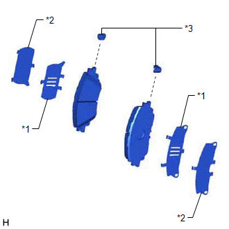

Pull the front disc brake cylinder assembly upward.
Remove the 2 front disc brake pads from the front disc brake cylinder mounting.
pic 3

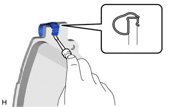

REMOVE FRONT DISC BRAKE ANTI-SQUEAL SHIM KIT
Remove the front No. 1 disc brake anti-squeal shim and front No. 2 disc brake anti-squeal shim from each front disc brake pad.
Using a screwdriver, remove the front disc brake pad wear indicator plate from each front disc brake pad.
pic 4

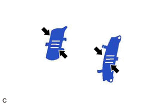

INSTALL FRONT DISC BRAKE ANTI-SQUEAL SHIM KIT
NOTICE:
When replacing worn front disc brake pads, the front disc brake anti-squeal shims and front disc brake pad wear indicator plates must be replaced together with the front disc brake pads.
Do not apply disc brake grease to the lining surface of the brake pad.
Install the front disc brake pad wear indicator plates in the correct position and direction.
Install the front disc brake anti-squeal shims in the correct position and direction.
Apply disc brake grease to both sides of each front No. 1 disc brake anti-squeal shim .
pic 5

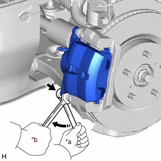

Install the front No. 1 disc brake anti-squeal shim and front No. 2 disc brake anti-squeal shim to each front disc brake pad.
pic 6

Hold the front disc brake cylinder slide pin (lower side) and install the front disc brake cylinder assembly to the front disc brake cylinder mounting with the bolt.
Torque : 34.3 Nm (350 kgf-cm, 25 ft-lbf)
