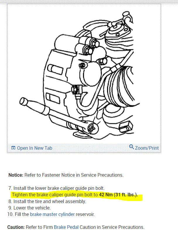

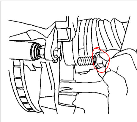

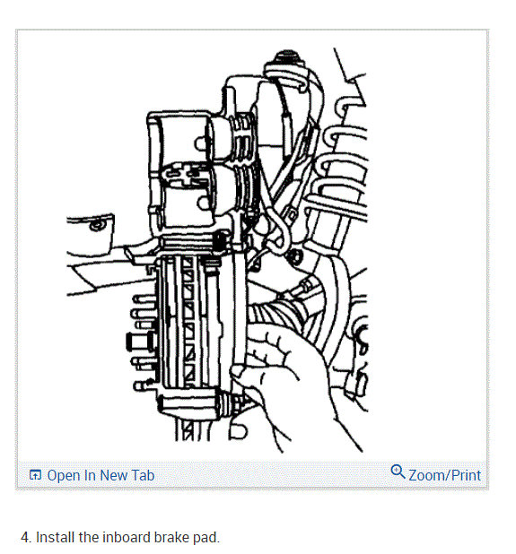

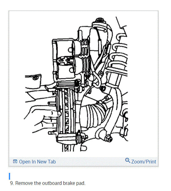

I am going to change the front brakes and rotors on my vehicle listed above but don't know the torque specs for the caliper itself and the mounting bracket. Can you please tell me the torque specs for all brake calipers and all mounting brackets? Thanks in advance

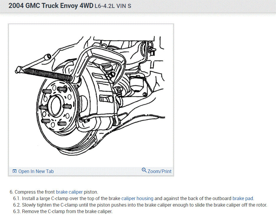

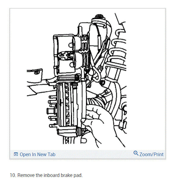

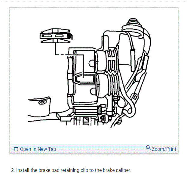

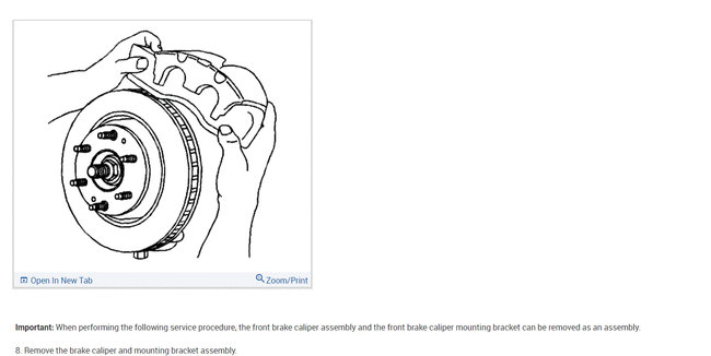

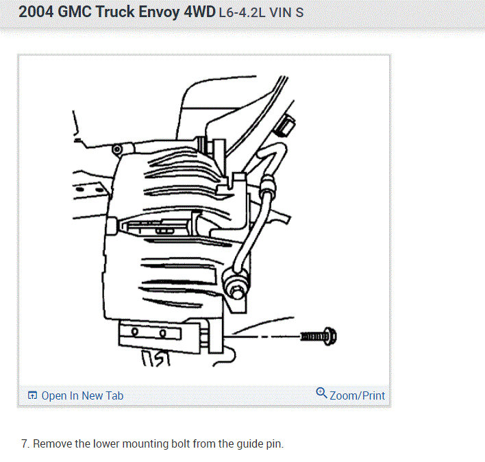

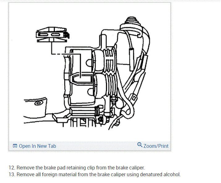

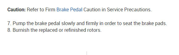

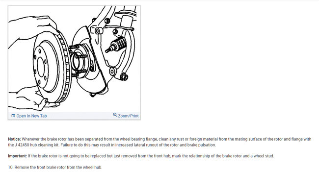

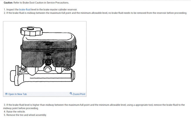

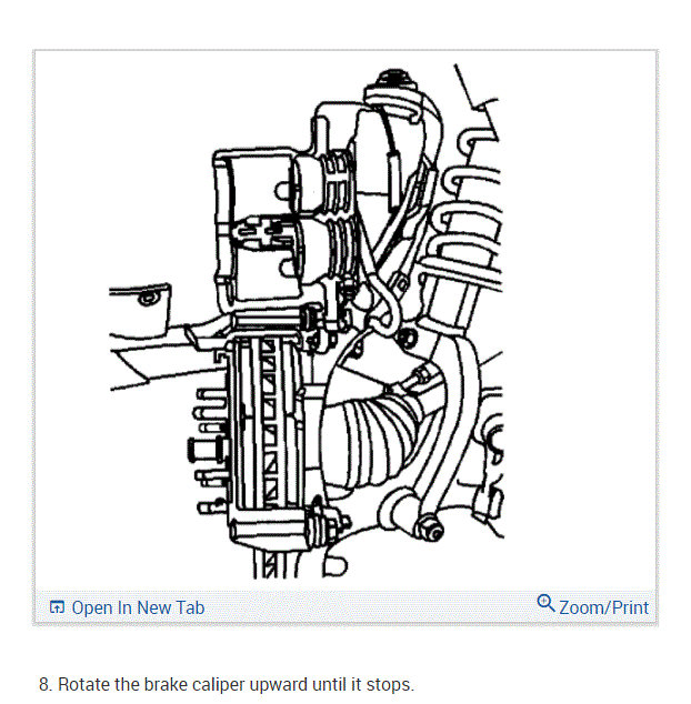

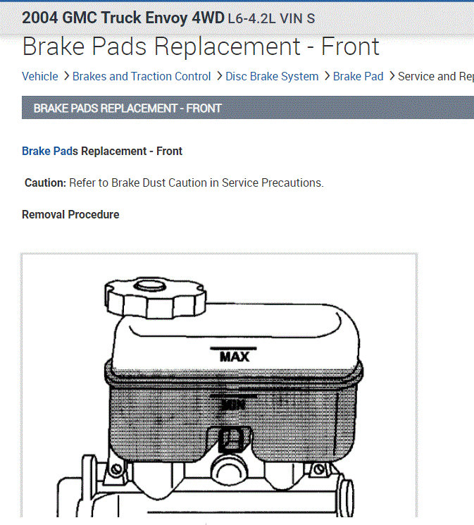

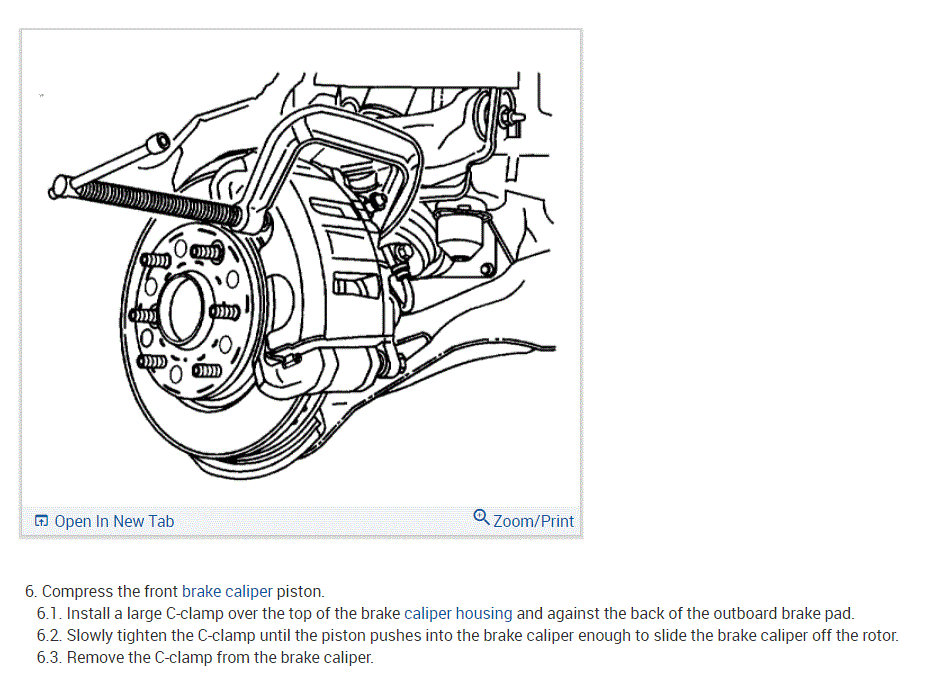

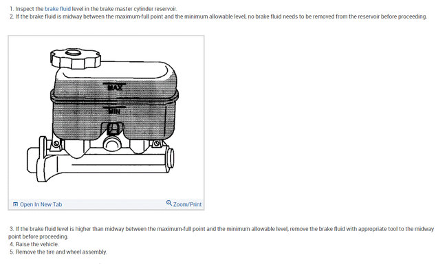

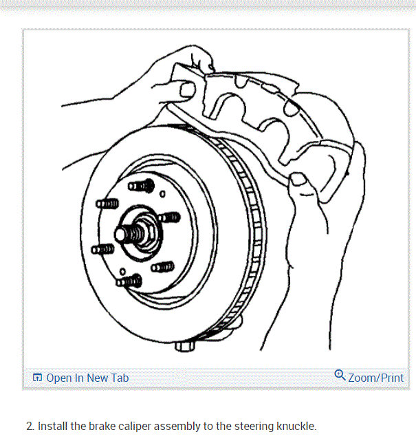

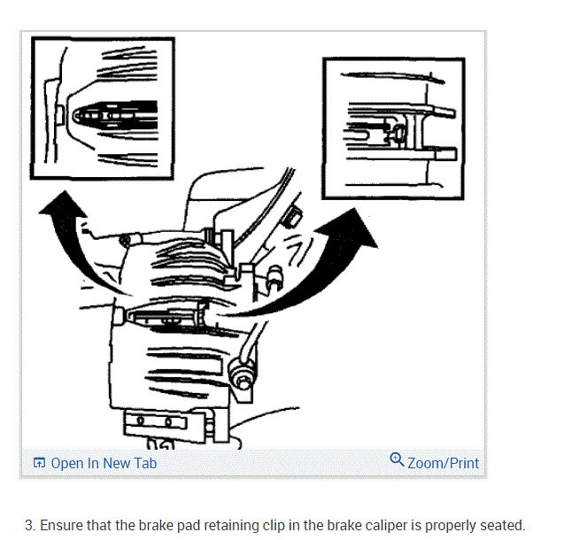

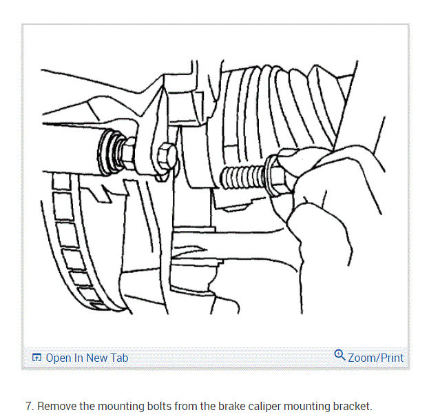

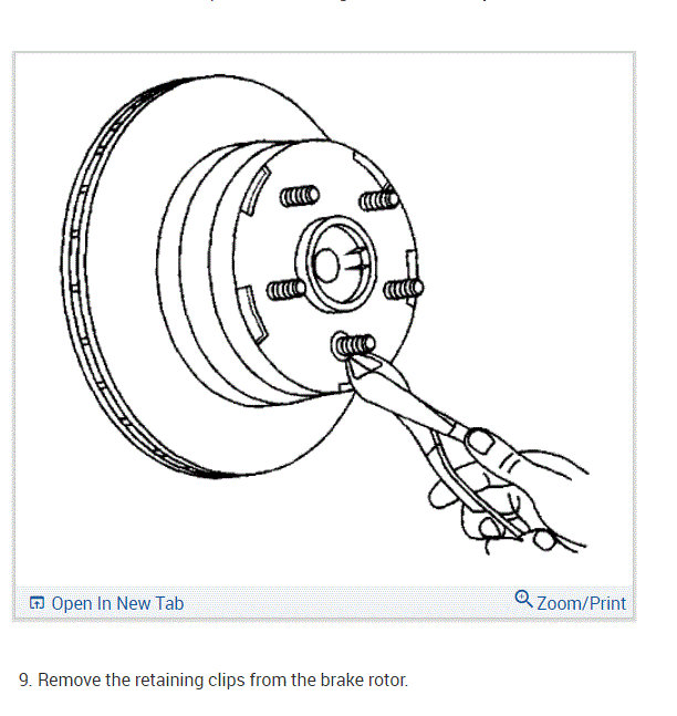

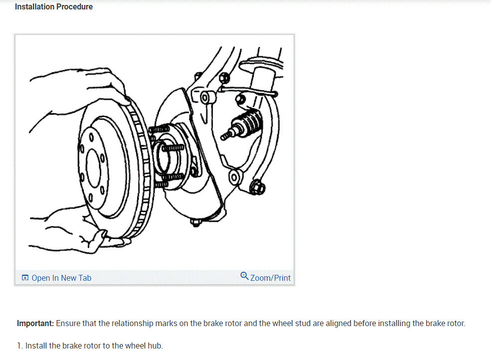

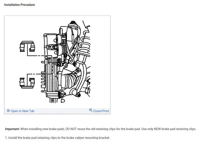

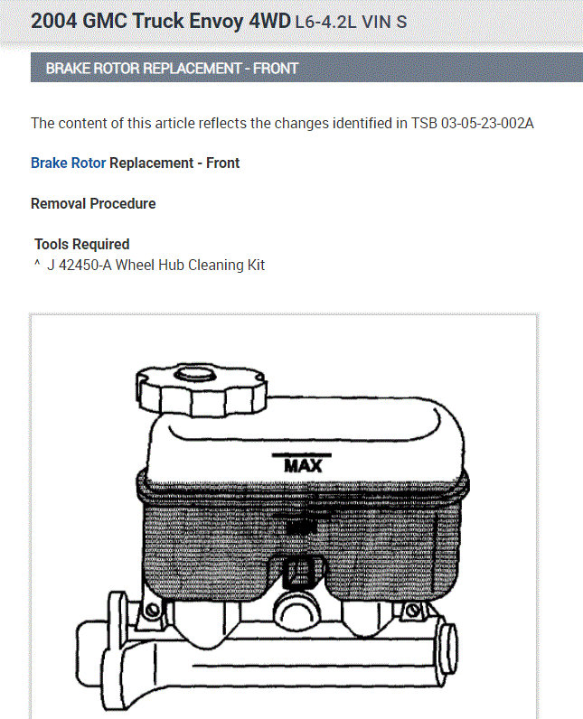

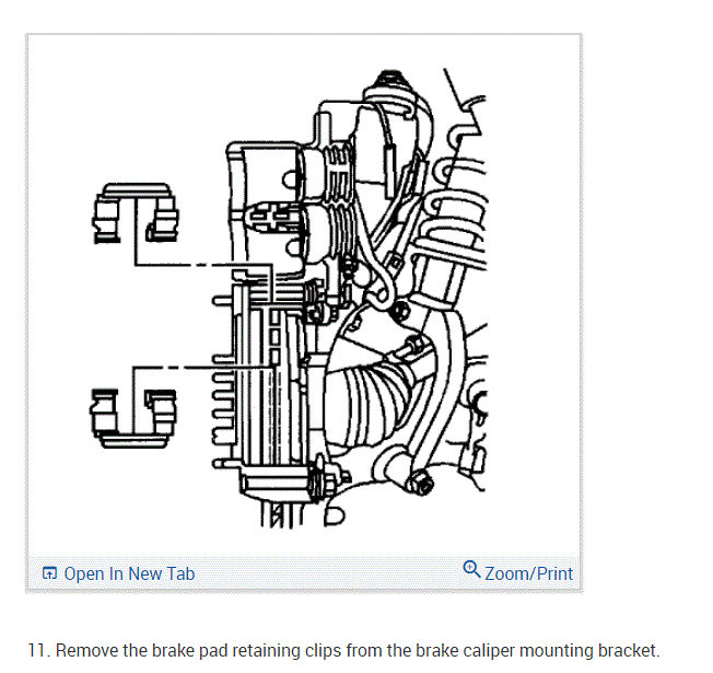

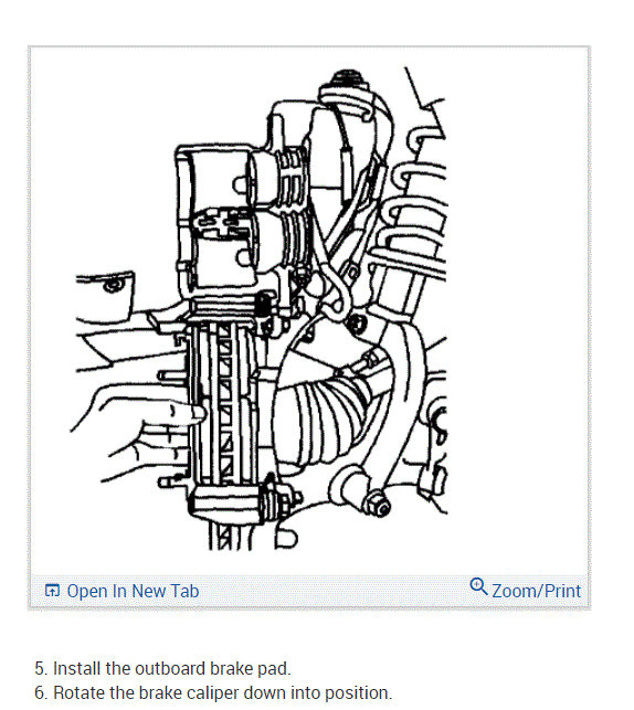

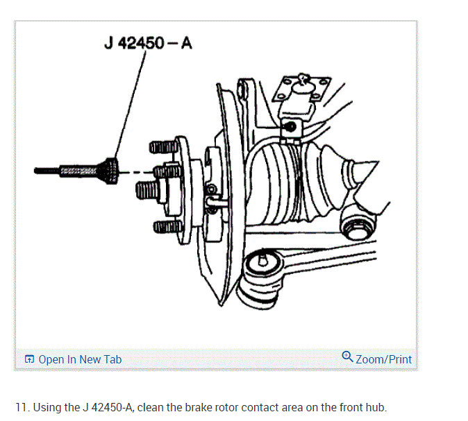

Replacing the brakes and rotors really isn't too hard. To get you started, here is a link that shows in general how it is done. You can use this as a guide.
The directions and pics below are specific to your vehicle. Torque specifications are included in the directions. I highlighted them.
Note: Pics 1-15 are pad replacement. The remaining pics are for the disc rotor.
I hope this helps. Let me know if you have other questions. Also, the pics below contain everything.

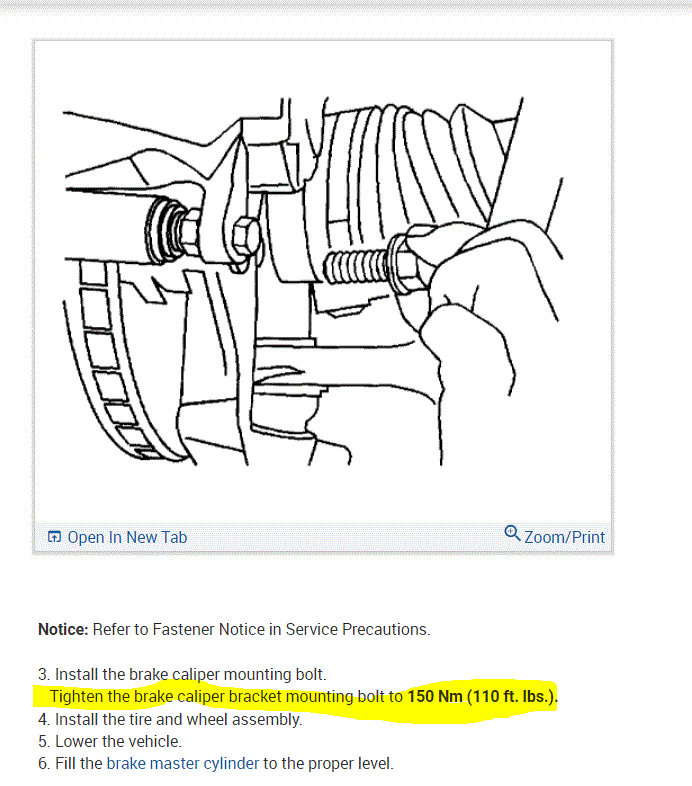

I need the torque specs for the caliper itself and the mounting bracket.

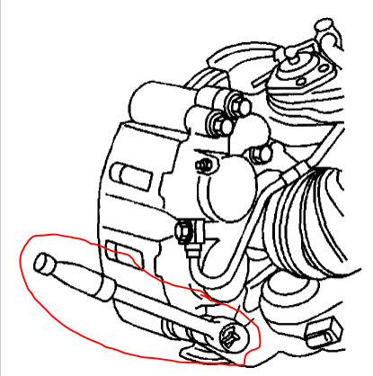

Sorry for the confusion. The torque specifications are always included in the related photo instructions we include. The torque for the brake caliper to caliper bracket is to be 42 NM (Newton Meters) or 31 ft. lbs. The brake caliper bracket to hub-spindle assembly is to be 150 NM or 110 ft. lbs. I've attached pictures for you below for your vehicle. Hope this helps and thanks again for using 2CarPros.
