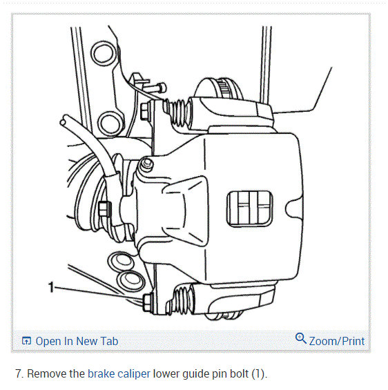

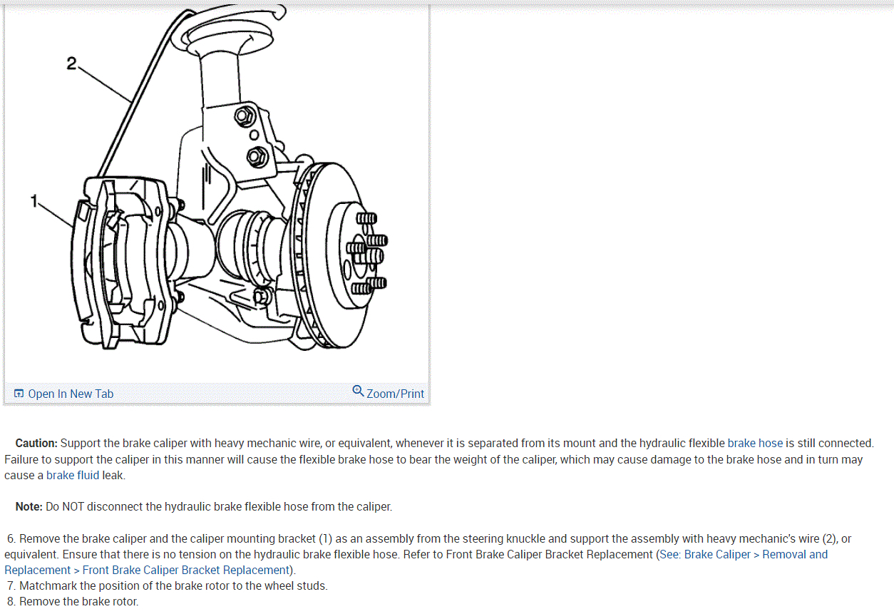

My brakes were grinding for a week. Why does my car sound like it needs new brakes again and can you help me change them out?
Mar 16, 2019 at 7:12 AM
  • 110,244 POSTS

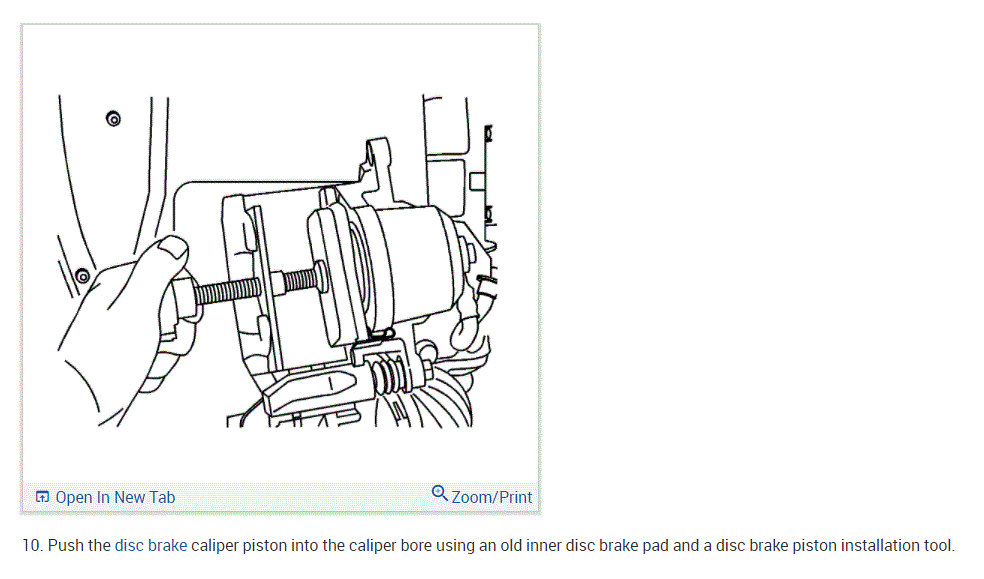

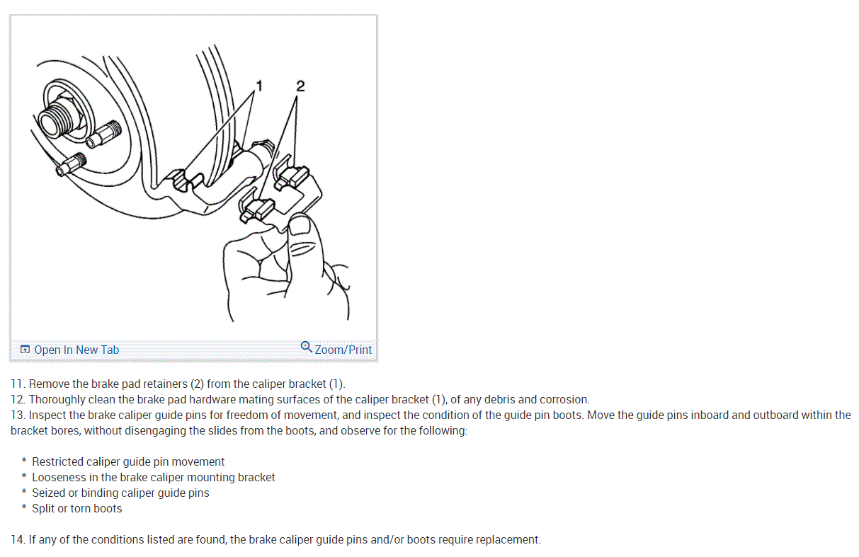

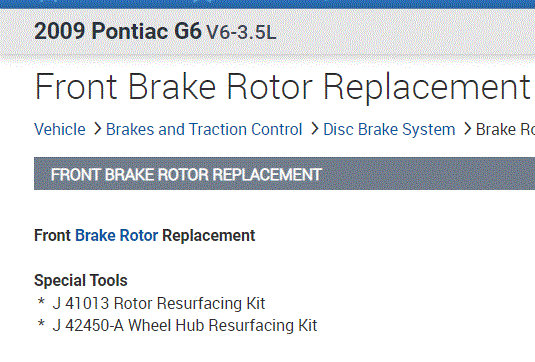

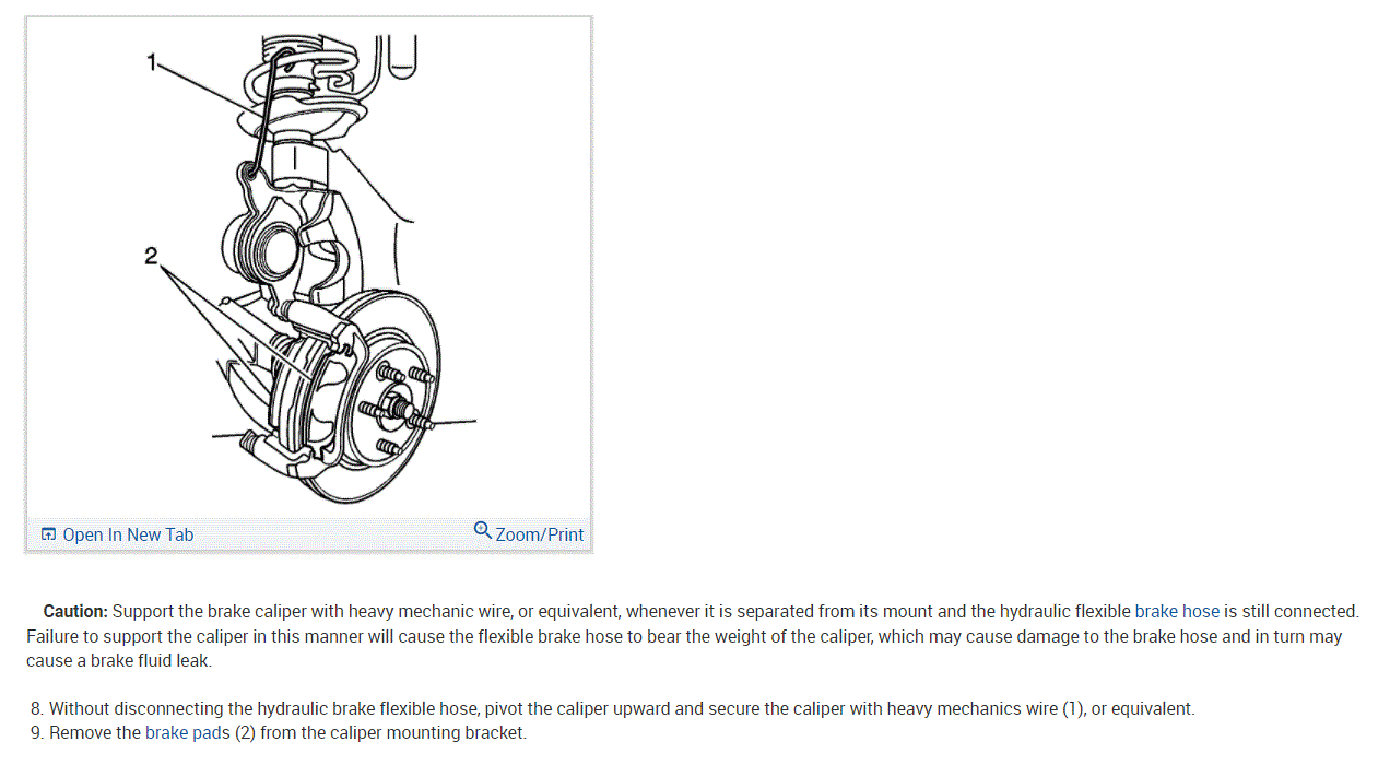

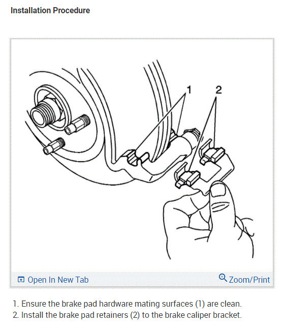

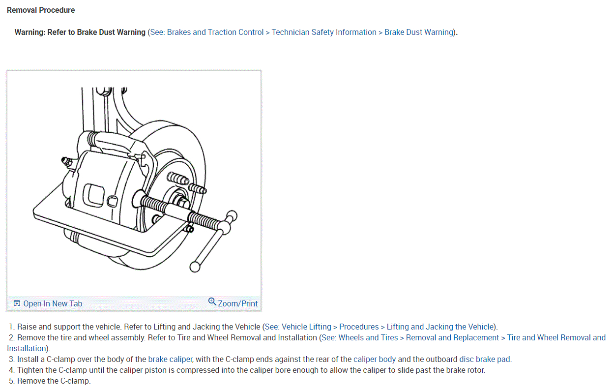

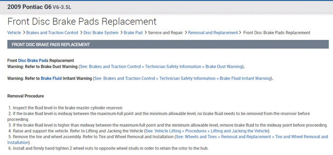

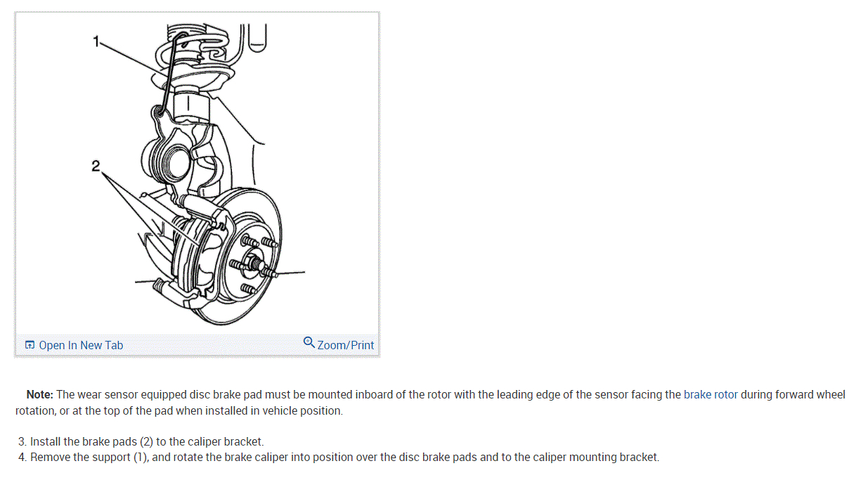

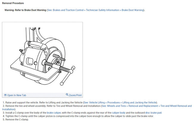

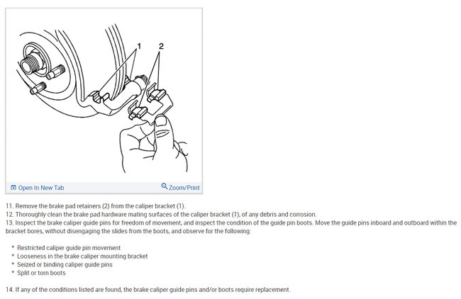

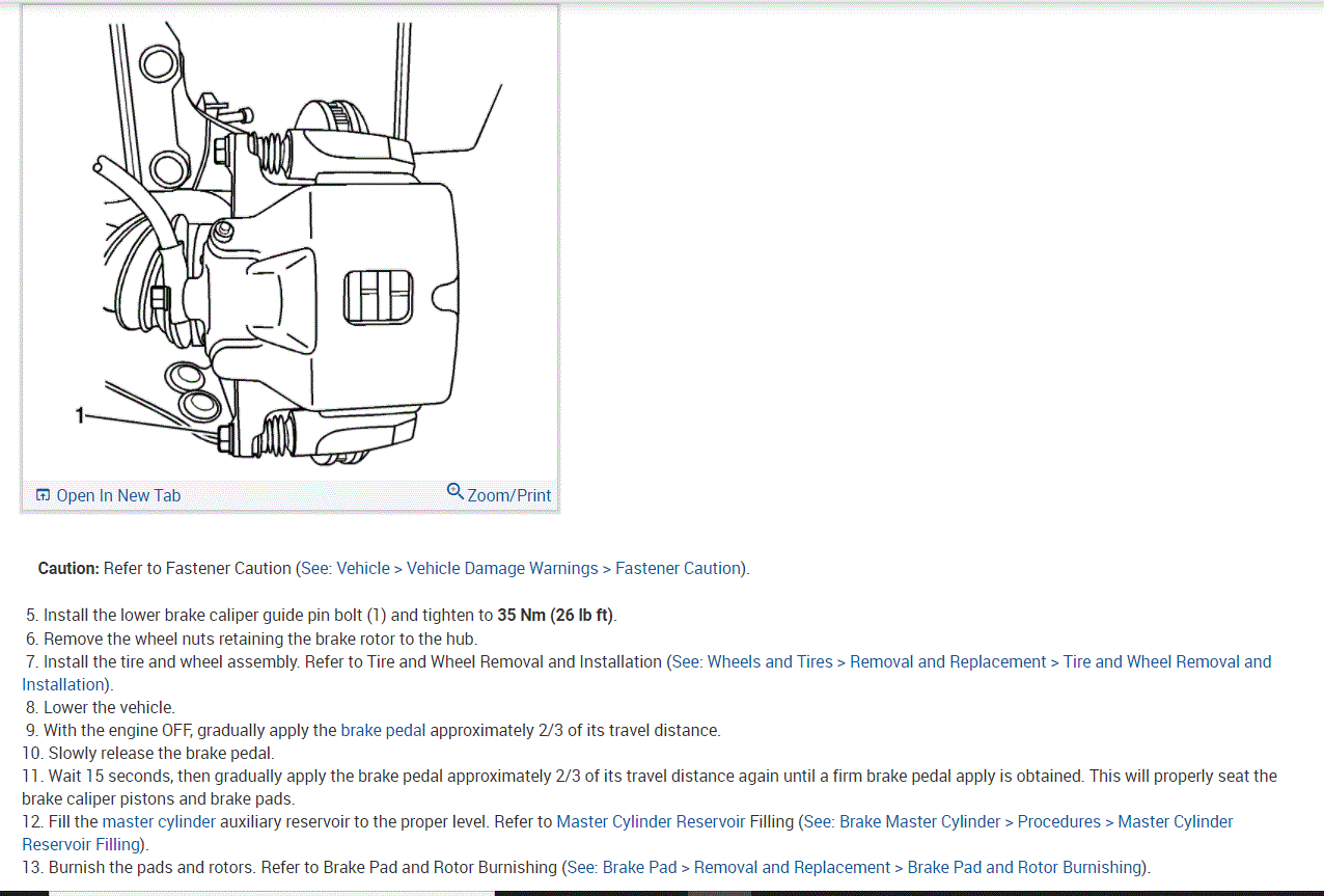

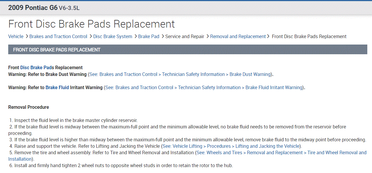

Front brake pads commonly last approximately 25,000 miles. That can vary based on terrain and driving habits. As far as replacement, they are easy to do and can save you money if you do it yourself.
To get you started, here is a link that explains in general how the procedure is done:
Also, here is a video showing the procedure being done on a Chevrolet Cavalier. Although it is a different model, the procedure is very similar.
https://youtu.be/CrTaafbfk0s
If you look at the attachments below, they include directions and pictures specific to your vehicle for brake pads and rotor replacement.
See pics below
