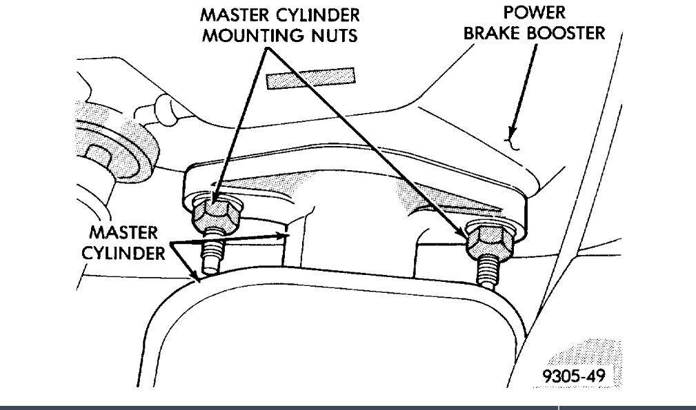

I want to see if anyone can help me. I needed to press down hard on brake pedal to get car to slow down and stop. So, I replaced master cylinder,
I replaced Power Brake Booster I bench bled master cylinder before installing.Brakes then worked good until today.
Now, once again, I need to press down hard to slow down/stop car. Brake fluid level is fine.
Did the Re-manufactured Brake Booster I just installed, fail?
Bad ABS Module?
Air in brake line? I read I can't bleed ABS brakes. You need a scanner.
Only Check Engine Light code is P0160
For O2 Sensor.
I did see Traction Light turn on briefly then it went off.
I tested brake booster by pumping brake pedal 6-8 times with engine off then keep pressure on pedal while I started engine and pedal dropped.
What say you?

From your description, it does sound like the new booster has failed.
You can change just the booster with taking off the master cylinder.

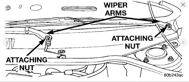

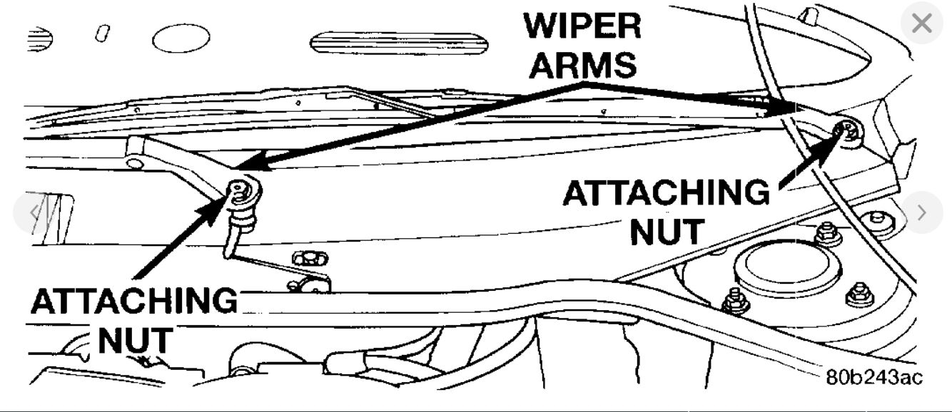

Wiper Arm Attachment To Pivot
2. Remove caps from both wiper arms at the attachment to the pivots to expose the wiper arm attaching nut. Remove the nut attaching each wiper arm to its pivot.
3. Remove the wiper arms from the pivots. Wiper arms are removed from the pivots by rocking them back and force on the pivots until they can be pulled off the pivots.

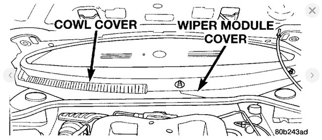

Wiper Module And Cowl Cover
4. Remove the wiper module cover and cowl cover from the vehicle.

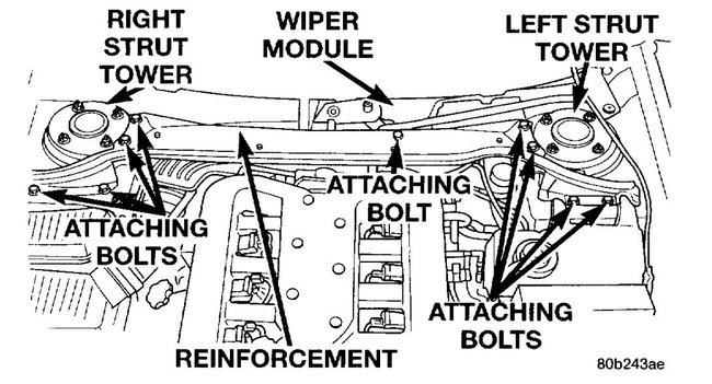

Reinforcement Attachment To Vehicle
5. Remove the 8 bolts, attaching the reinforcement to the strut towers and the 1 bolt attaching the wiper module to the reinforcement. Remove the reinforcement from the vehicle.
6. Disconnect the wire connector from the brake fluid level sensor on the right side of the master cylinder reservoir.

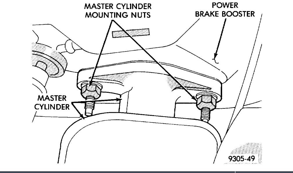

Master Cylinder Mounting
7. Remove the 2 nuts attaching the master cylinder to the vacuum booster.

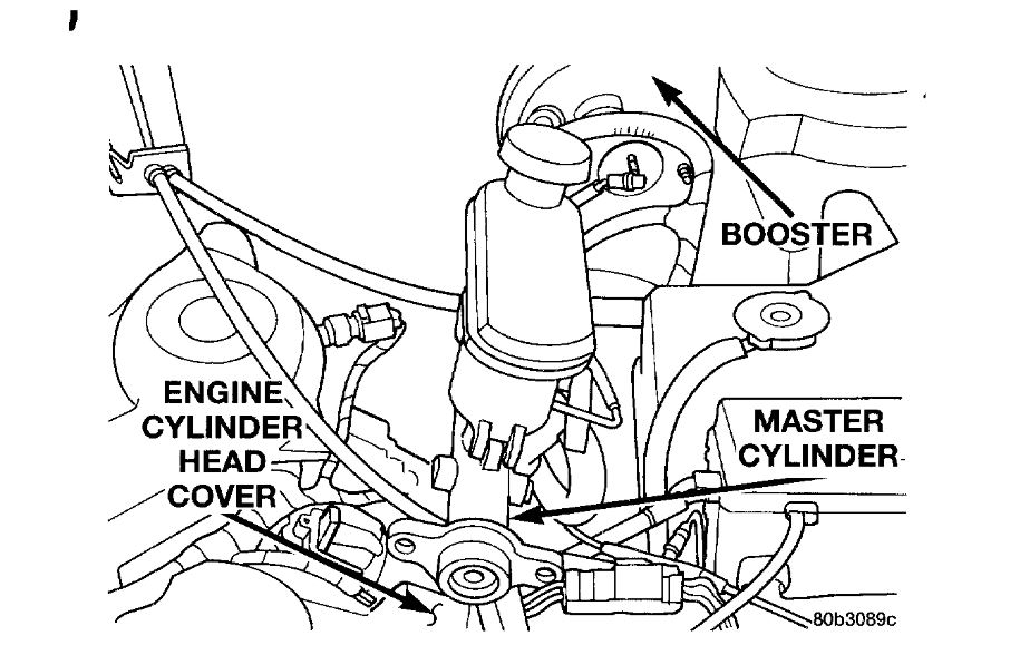

Master Cylinder Positioning
8. Carefully slide master cylinder off vacuum booster with brake lines attached, and position it backwards, on top of left engine cylinder head cover.

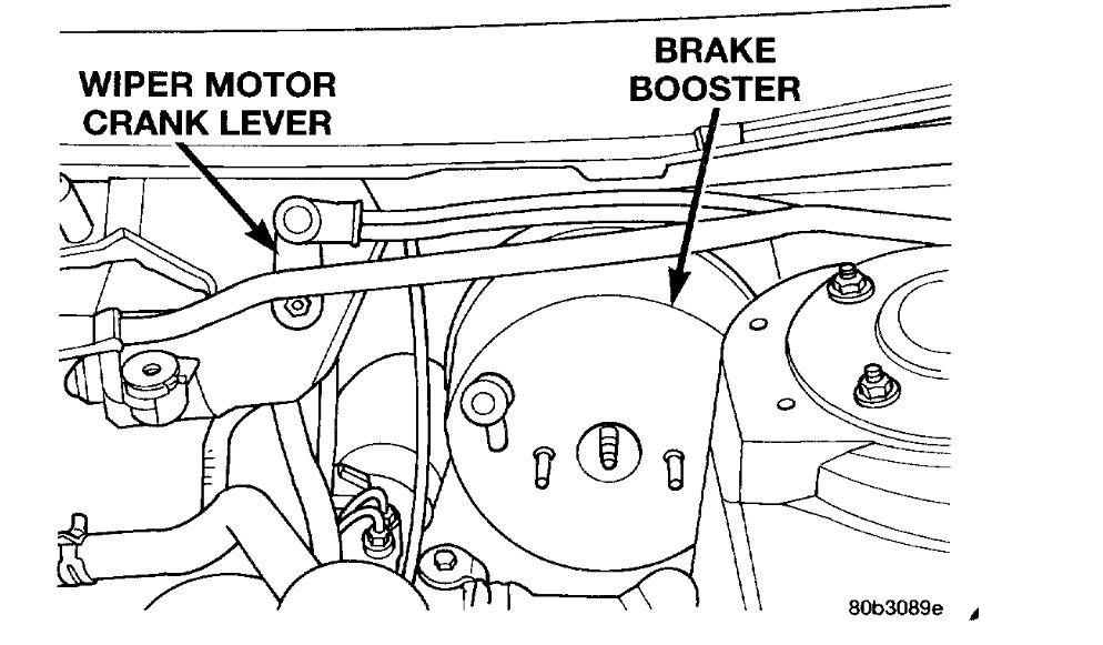

Wiper Crank Lever Positioning
13. Rotate the windshield wiper motor crank lever until the crank lever points in the 12 o'clock position.
14. Slide the vacuum booster out of the dash panel, and remove from vehicle.
