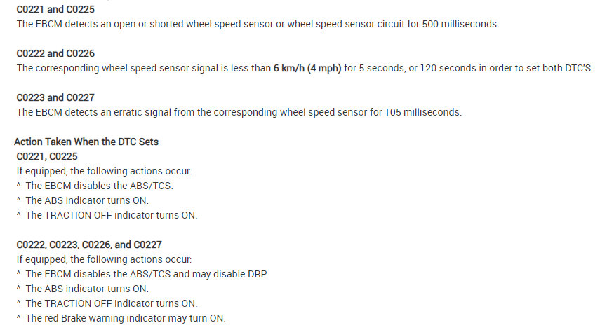

I went to AutoZone and their code reader says I have CO223 and CO223. Right front wheel speed signal erratic and left front wheel speed signal erratic. At times I would get the ABS light in the dash. I ran new brake fluid through both back wheels which cleared it and still want to do both front wheels. I'm not sure if this helped but it did get rid of the ABS light.

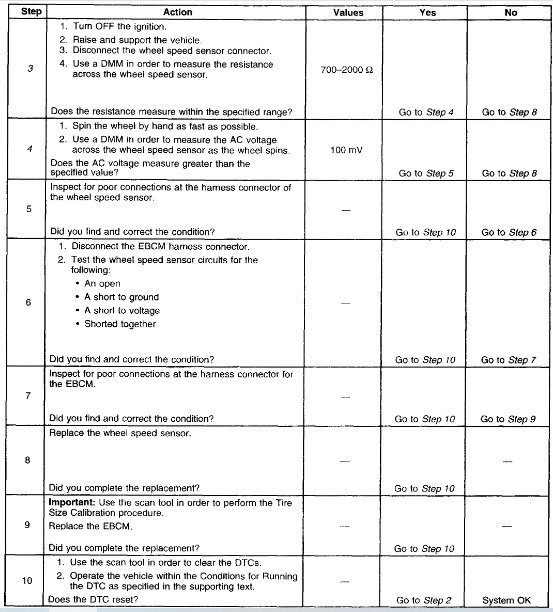

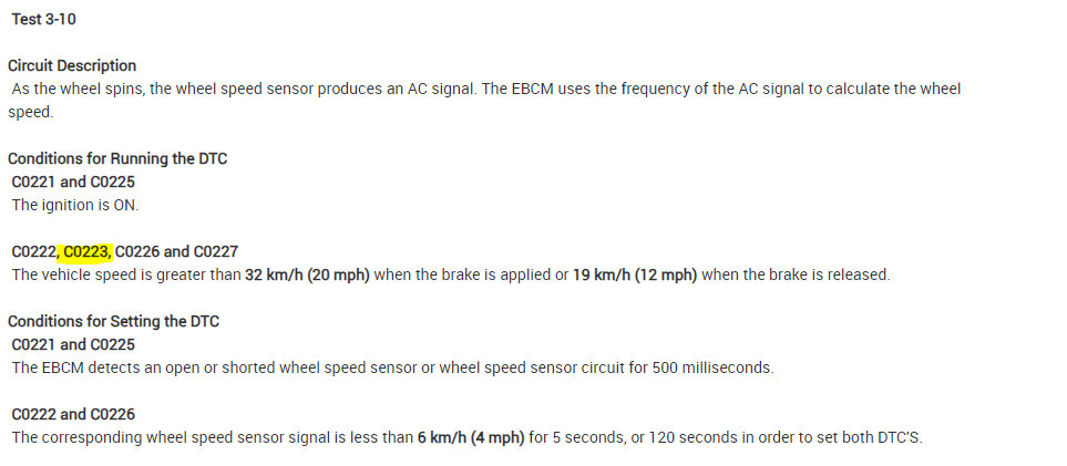

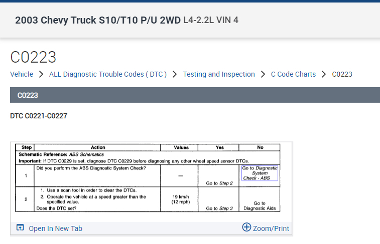

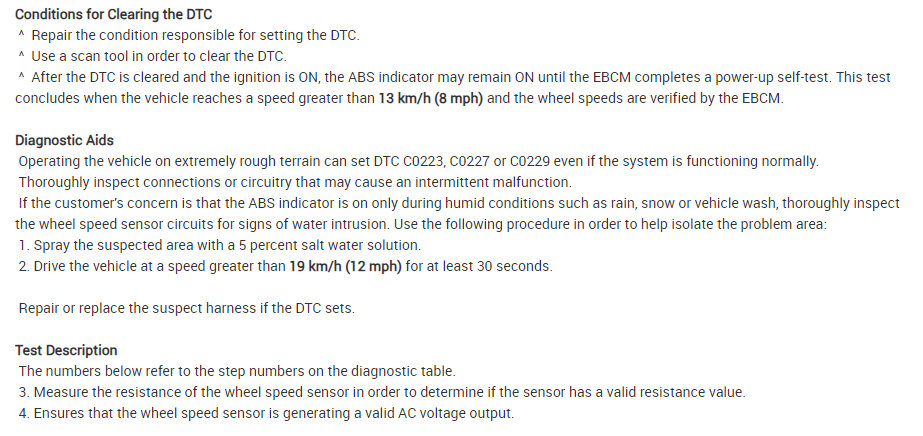

I suspect it is the sensor that is failing. As far as the brake fluid is concerned, it has nothing to do with the speed sensor.
If you have a live data scan tool, you could watch the signal from each wheel to see if one is off. That would help narrow things down.
As far as the code is concerned, I attached information and diagnostics below for you. Take a look and let me know if it helps.
