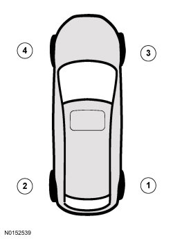

6. Bleeding steps must be followed in the order indicated in the graphic.

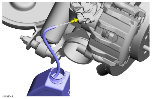

10. Loosen the bleeder screw 180° and leave open until clear bubble free brake fluid flows and then tighten the bleeder screw.

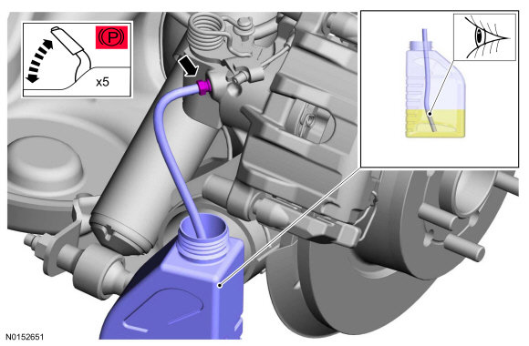

Vehicles with rear integral parking brake calipers
11. NOTE: Due to the complexity of the fluid path within the rear integral parking brake calipers, it is necessary to press and release the parking brake during the bleed procedure.
Apply and release the parking brake 5 times. Loosen the rear bleeder screw. Leave open until clear, bubble-free brake fluid flows, then tighten the rear bleeder screw.
- Repeat until clear, bubble-free fluid comes out.

I read that you've bled them, but I have helped a lot of folks with the same exact issue and if the procedure is not done exactly as Ford shows to do it, you'll forever have issues unfortunately! The only way that they are still spongy is because of the air in the system, they are a pain to bleed but pressure bleeding them at the pressure spec that I gave you should get the job done. The brake fluid circuits are too complex! another ford bright idea!
