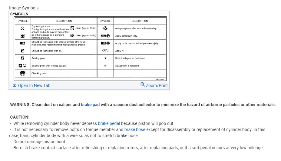

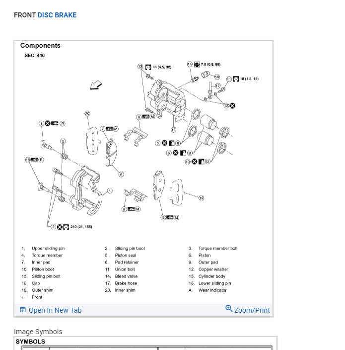

This is surely to be telling you that you need to replace the brakes. Most likely the front but both front and rear should be checked.
What is happening is the brake light is just a monitor on the fluid level in the reservoir. So when the light comes on, that means the fluid is low and this could be due to a leak or the fact that the pads are worn and it takes more fluid to apply the pads because the piston in the caliper has to travel further now that the pads are worn. Add in the noise that they are making and it tells us they need replaced. Do not just top off the brake fluid. This should never be done because there is a reason it is low and that needs to be found or you may find yourself with no brakes and that is not good.
Here are some guides that will walk you through how to change them:
https://www.2carpros.com/articles/how-to-replace-rear-brake-pads-and-rotors
Let us know what you find and we can go from there. Thanks
