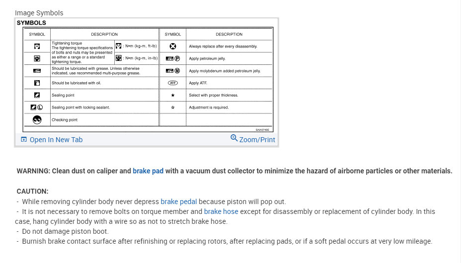

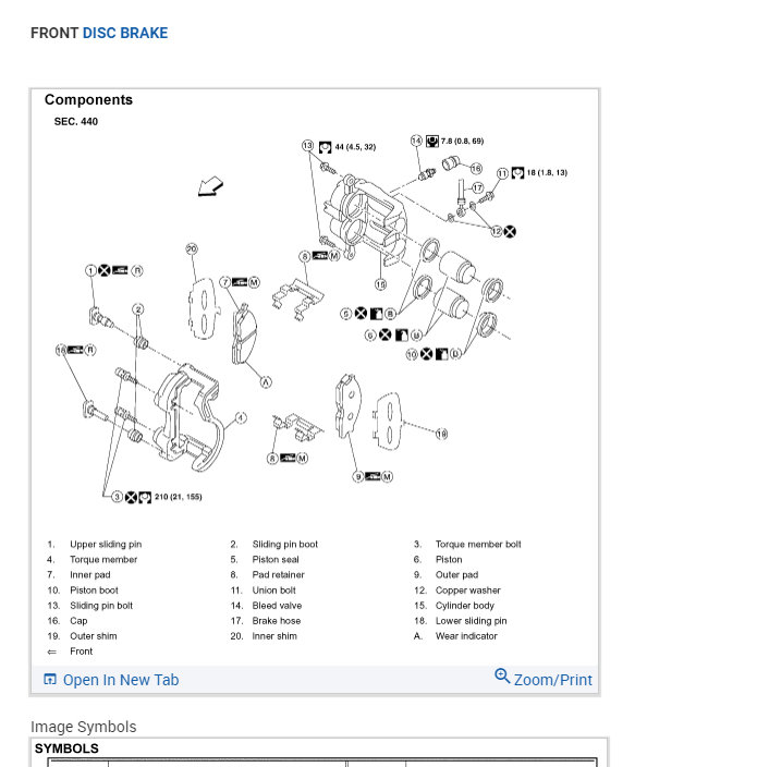

Here are some guides that will walk you through how to change them:
https://www.2carpros.com/articles/how-to-replace-rear-brake-pads-and-rotors
Let us know what you find and we can go from there. Thanks
