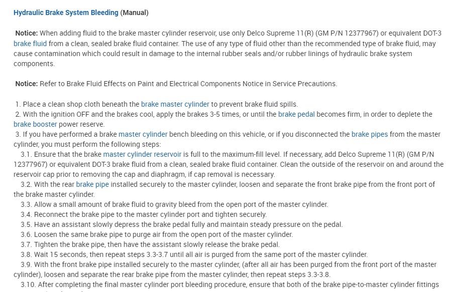

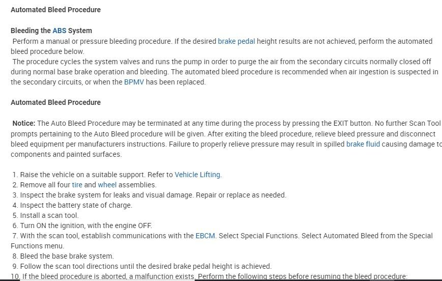

My rear passenger side brake hose broke.. So I replaced it with a new hose. My pedal goes to the floor. After a few (3) pumps.. It'll stop a little. How do I bleed it, and what are the proper steps to reset the ABS so I have brakes?
Jan 5, 2020 at 11:36 PM
Good morning,

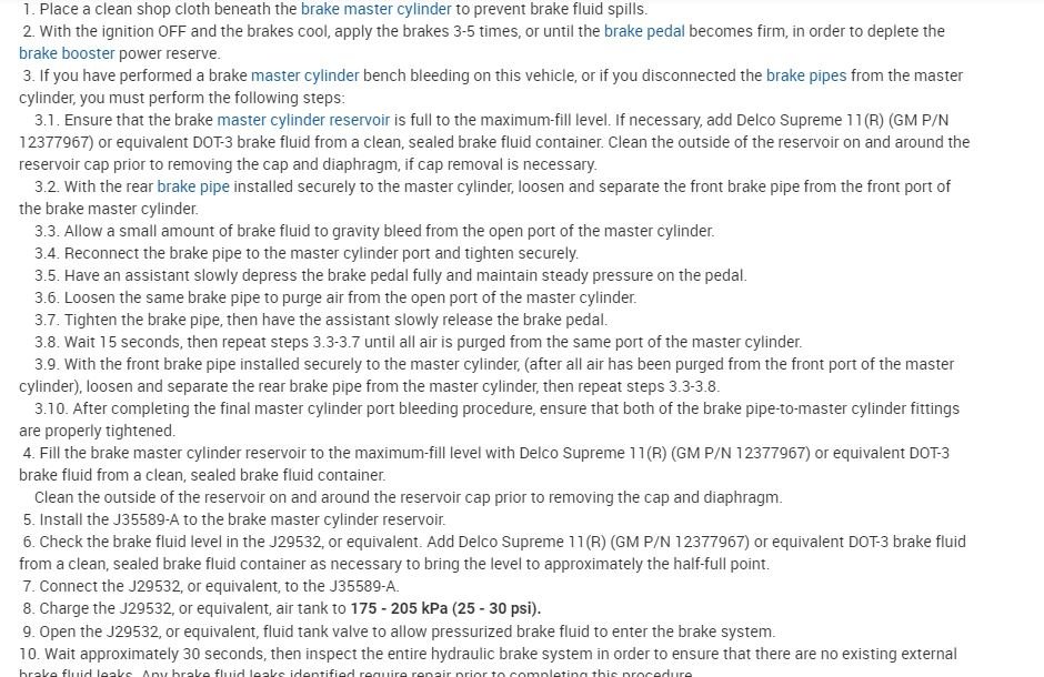

You need to bleed the system including the ABS unit.
https://www.2carpros.com/articles/brake-pedal-goes-to-the-floor
I attached the procedure you to follow.
https://www.2carpros.com/articles/how-to-bleed-or-flush-a-car-brake-system
