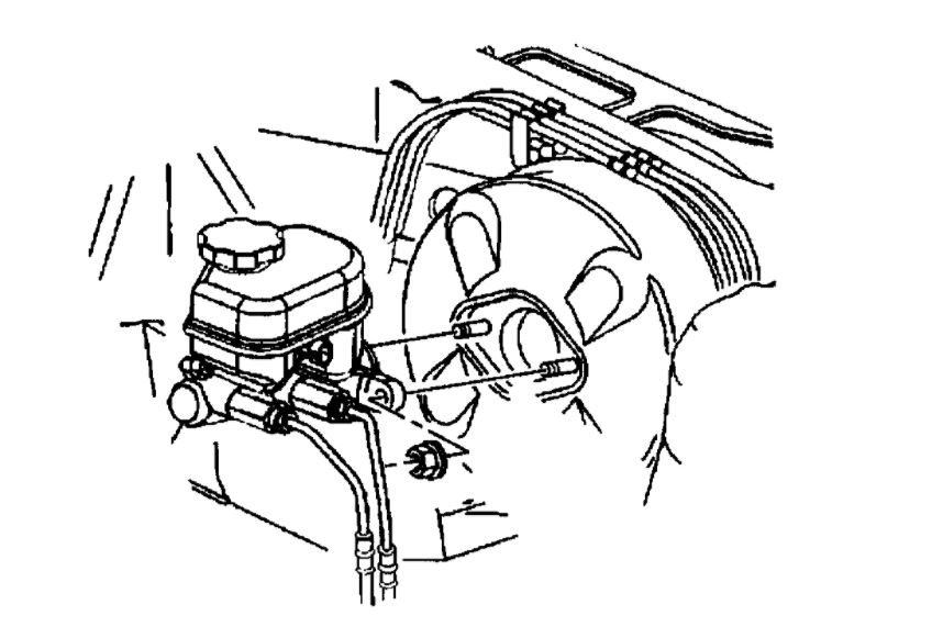

In the event it is the master cylinder, I attached the procedure for replacing the cylinder and the bleeding process if you have ABS.

Master Cylinder Replacement
Removal Procedure
1. Disconnect the electrical connector from the brake fluid level sensor.
2. Disconnect the brake pipes from the master cylinder.
Important: Install a rubber cap or plug to the exposed brake pipe fitting end in order to prevent brake fluid loss and contamination.
3. Plug the open brake pipe fitting ends.
4. Remove the 2 master cylinder mounting nuts.
5. Remove the master cylinder.
6. Remove the reservoir from the master cylinder if it is to be reused on a replacement master cylinder.
