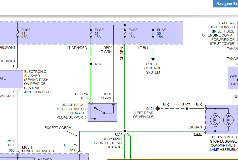

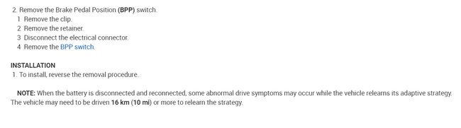

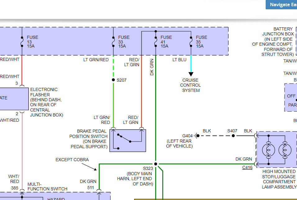

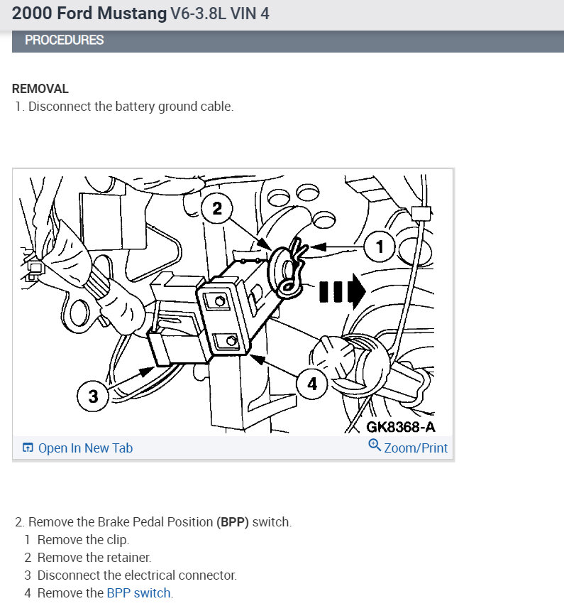

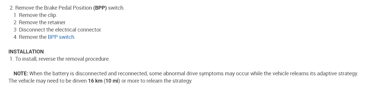

Yes, I was wondering what would be the best way to put on a new brake light switch connector. The wires are eaten up to the connector.
Oct 11, 2022 at 11:43 AM
  • 55,224 POSTS
You will need to get a replacement pigtail and then wire it in. Here are the wiring diagrams so you can see how the wires go. Check out the images (below). Please let us know if you need anything else to get the problem fixed.
