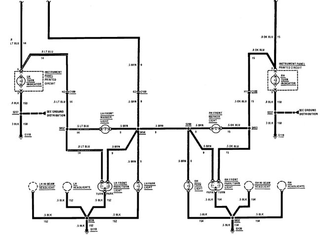

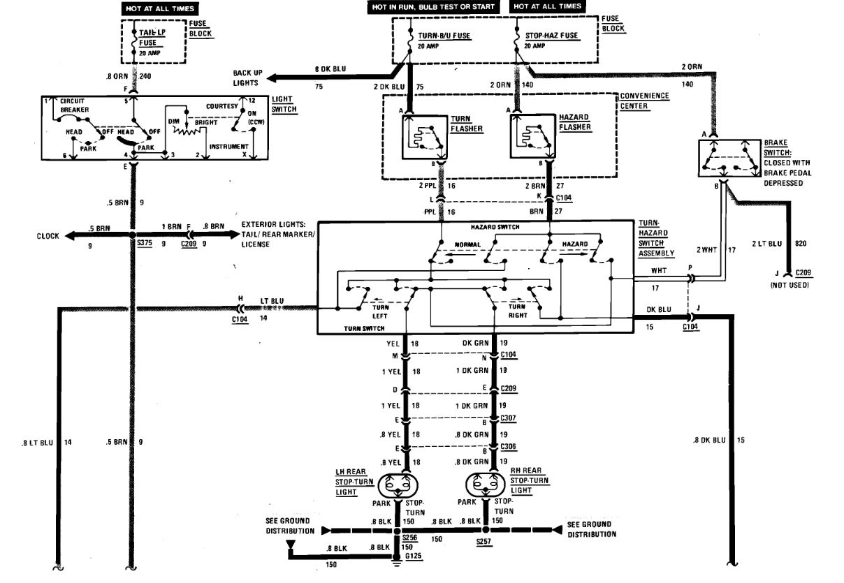

I just need to know the brake switch wiring diagram / schematic. Because I don't have brake lights on my vehicle, lol all fuses and bulbs are good, tail lights work, just no brake lights. Thank you
Jun 6, 2024 at 6:17 AM
  • 55,402 POSTS
Sure, here is the factory wiring diagrams for the brake light and blinkers as requested, you are welcome. Check out the images (below). Let us know if you need anything else.
