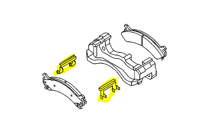

I think something may be trapped between disc and the pads. check the pads metal holder if installed properly. check picture.

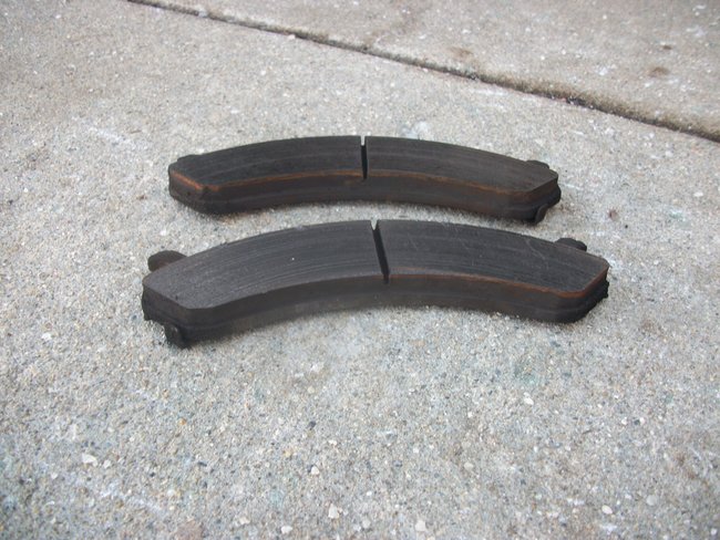

Can I have some pictures of the rotor and the pads?
Feb 5, 2019 at 12:27 AM
SEVAG P
  • 405 POSTS
Because some types of pads have metal particles inside it. you must drive until the pads rough surface is gone.

Also a video or noise record please. if it's normal pad squeaking you can use anti squeak compound at the back of your brake pads, that will eliminate the noise.
Feb 5, 2019 at 11:29 PM
CONRADISH006
  • 53 POSTS

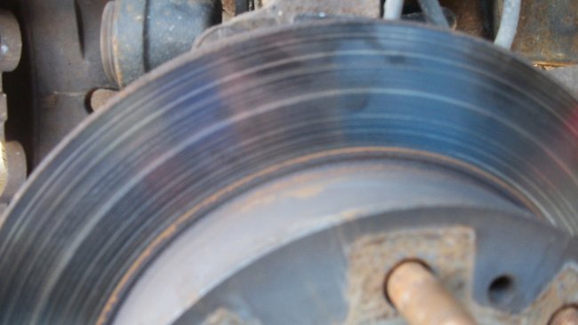

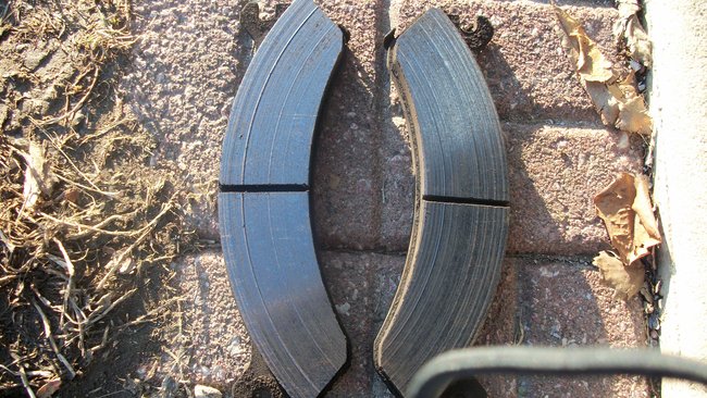

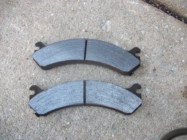

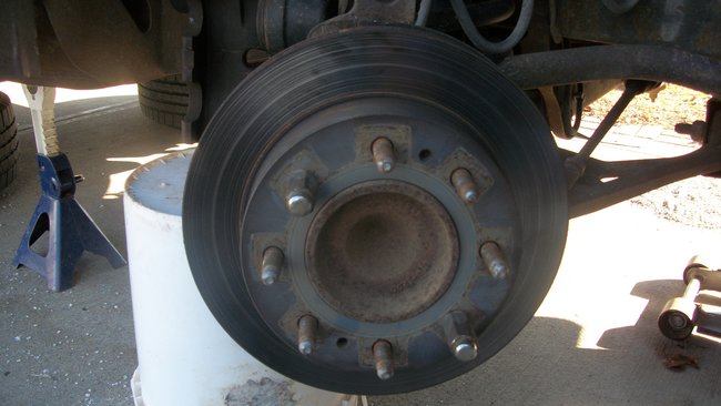

Here are the pictures:
Feb 16, 2019 at 4:50 AM
CONRADISH006
  • 53 POSTS

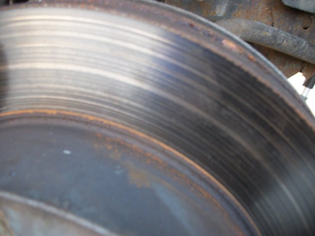

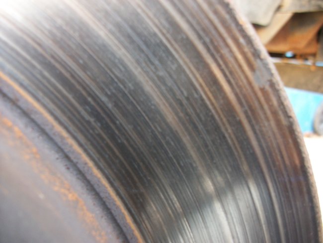

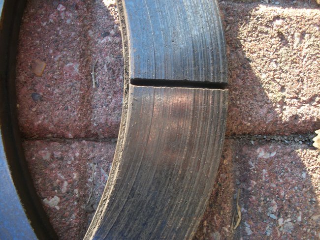

Here is the other side.

Also, this sound when turning the rotor is weird.
Feb 18, 2019 at 12:22 AM
SEVAG P
  • 405 POSTS
Hello
It seems the noise heard from the wheel hub bearing when turning the brake disc's.
Also brake disc's are badly scored that can be from bad brake pads quality.
Feb 20, 2019 at 12:40 AM

I got Carquest Wherever Platinum Professional pads and rotors.
Feb 20, 2019 at 7:50 AM
  • 55,456 POSTS
This is typical of ceramic brake pads I would change over to semi metallic. Ceramic pads last a long time but are sometimes squeaky grumbly. Here is a guide to help you get the job done correctly:
thanks for the pics and video. Please let us know what happens..
