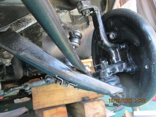

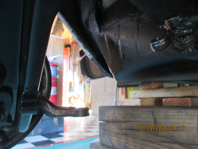

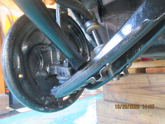

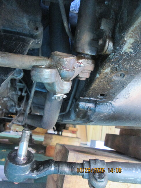

I had to swap the front brake spindles on my 65 Mercury Caliente Convertible from 4-lug to 5-lug. To do this, I used brake spindles from a 65 Mustang. Now I can't find the correct inner and outer tie rod ends. Help!

When swapping Mustang spindles onto an early Mercury Comet, the tie rod ends can be a little tricky because the steering arm taper and steering linkage need to be compatible.
The good news is that this conversion has been done before, and compatible steering components are available.
There are a couple of things I need to know before recommending the correct tie rod ends.
Are the 1965 Mustang spindles from a six-cylinder or V8 Mustang?
Does your Comet have power steering or manual steering?
Are you retaining the original Comet center link, pitman arm, and idler arm?
These details are important because the V8 Mustang steering components differ from the six-cylinder versions, and power steering can also affect the tie rod ends and adjusting sleeves.
If you're using 1965 Mustang V8 spindles, there are conversion components available from suppliers such as MustangSteve and Falcon Parts.
Here is a conversion kit for reference:
https://mustangsteve.com/products/falcon-comet-6cyl-to-v8-steering-conversion-kit-1960-1965-all-with-falcon-v8-spindle
Also, could you upload a picture of the spindle steering arm and your existing tie rod assembly? That would help us identify what you're working with.
Once we know which spindles and steering linkage you have, we can narrow down the correct parts without guessing.
Let me know what you find.

ve attached a few pI hahotos per your request.The spindles are from a V8 65 Mustang. I plan to keep my manual steering, retaining originalk center link, pitman arm and idle arm.

So, the problem might be the taper on the tie rods and center link on the 4 lug set up, they are a little smaller, you might need to change the rest of the steering components as well.

Sure, in other words, the entire steering system on our car now is for the 6 cylinder, (4 lug - smaller than the V8 which is 5 lug) which is larger is size including the steering components tapper fits. So unless you change all of the steering parts, pitman and idler arms, drag link and tie rod ends and spindles you will need a mismatch problem, I did this on my mustang when I was 16 with my dad, so I know what you are going through :o) hope this helps. Have a good weekend.
