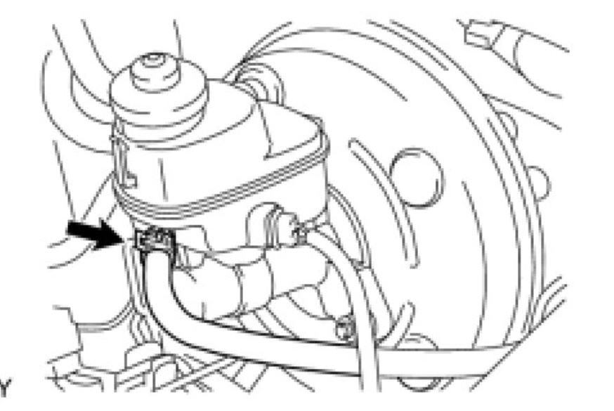

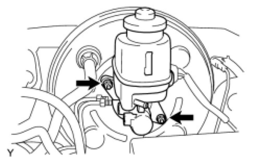

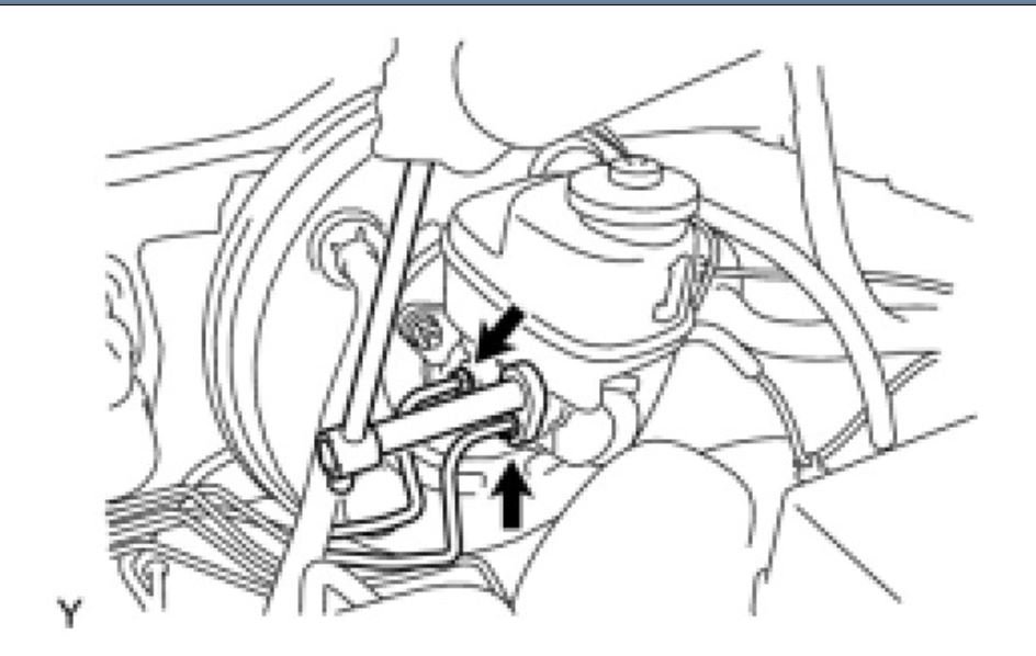

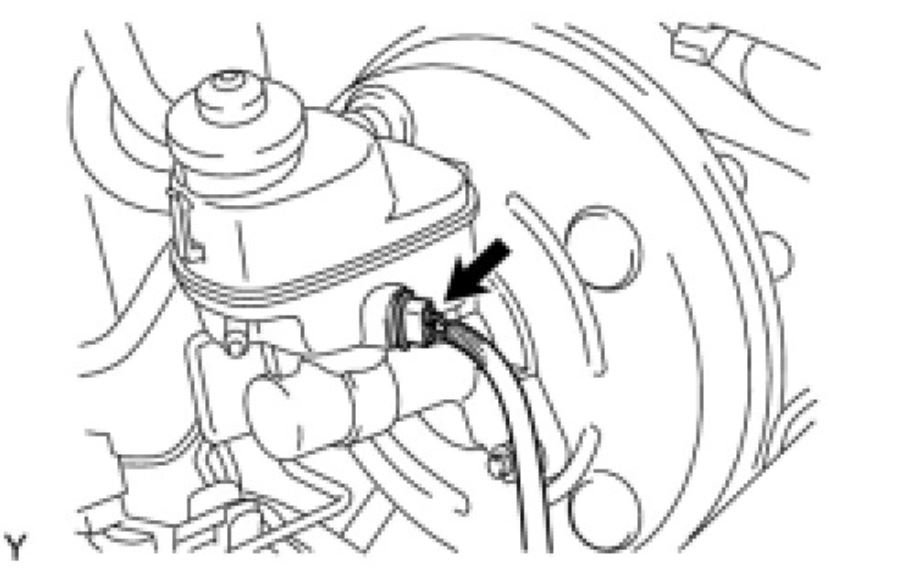

4. REMOVE BRAKE MASTER CYLINDER SUB-ASSEMBLY
(a)Disconnect the brake fluid level warning switch connector.
(b)Using a union nut wrench, disconnect the 2 brake lines from the brake master cylinder sub-assembly.
(c)Remove the 2 nuts, and then pull the brake master cylinder sub-assembly out of the brake booster.
(d)Remove the O-ring from the brake master cylinder sub-assembly.
