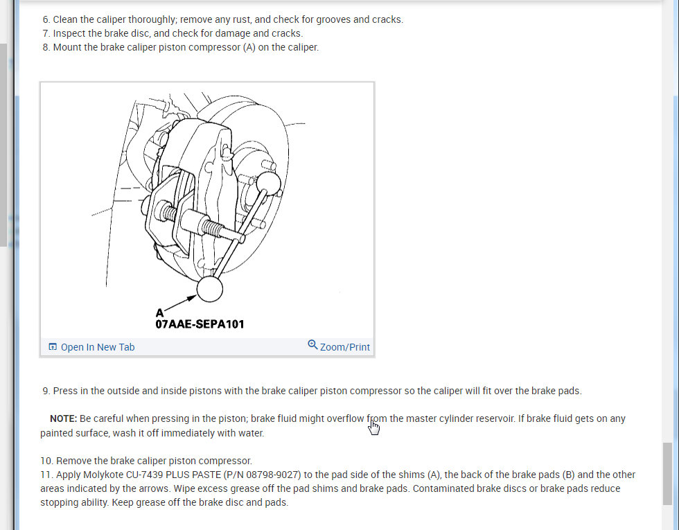

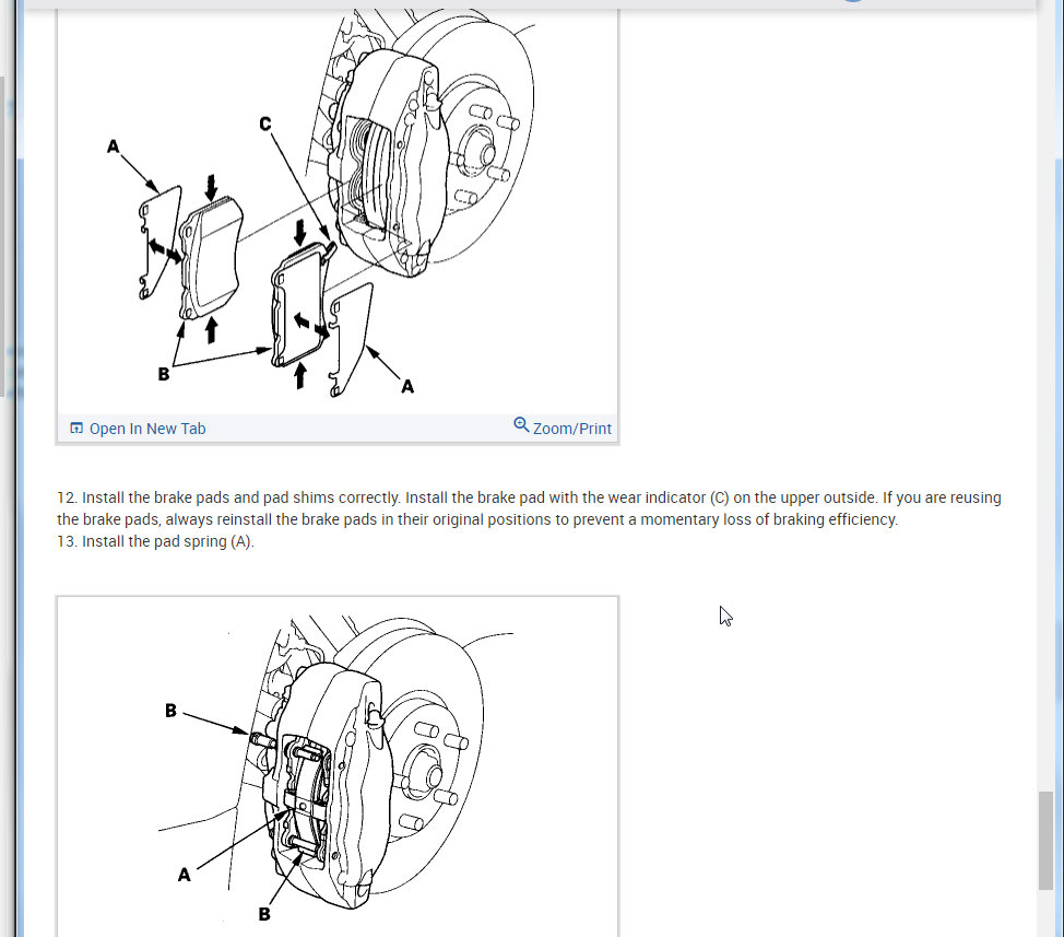

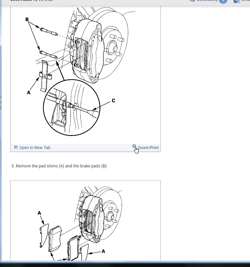

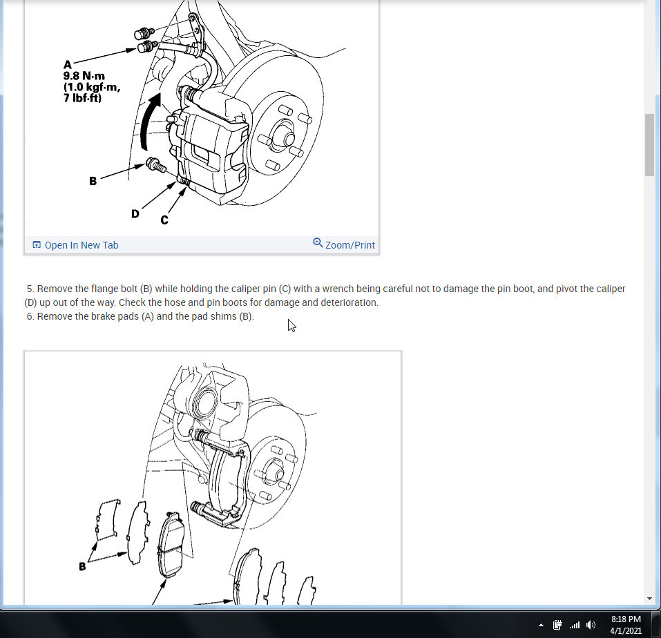

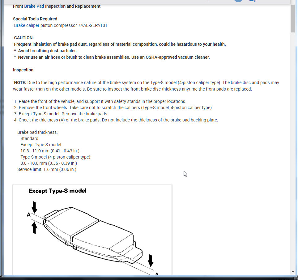

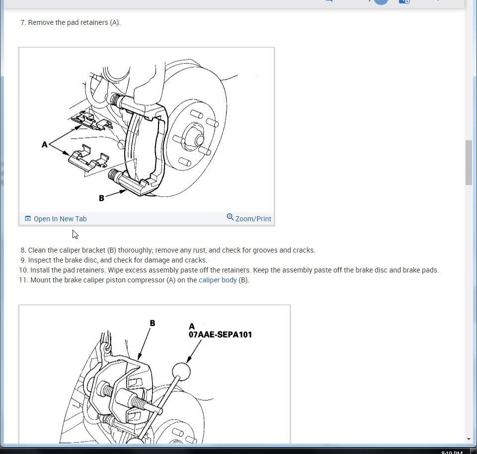

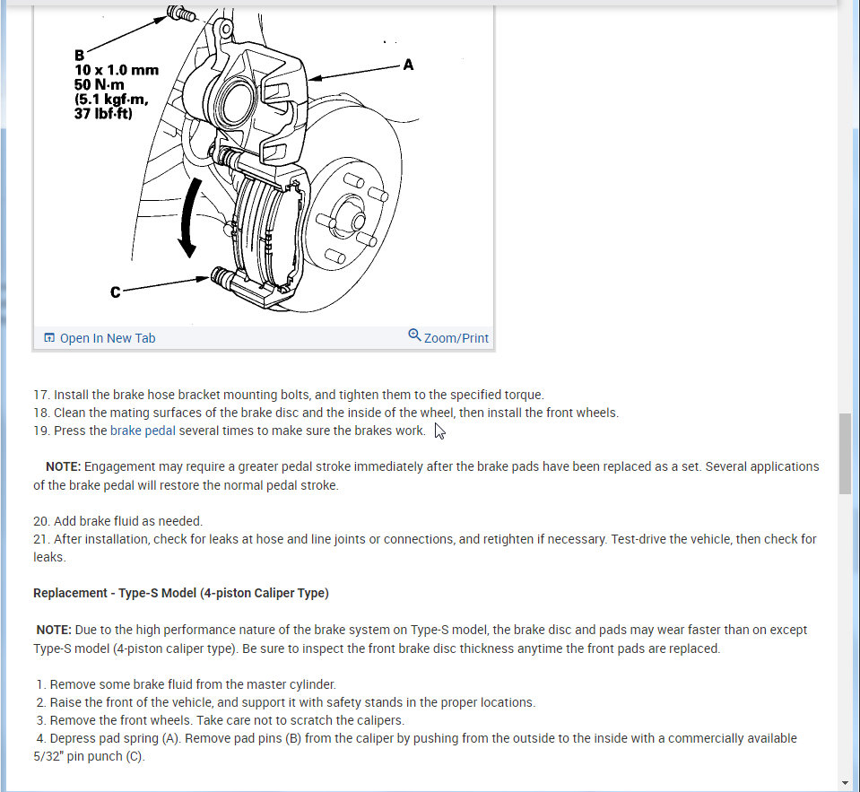

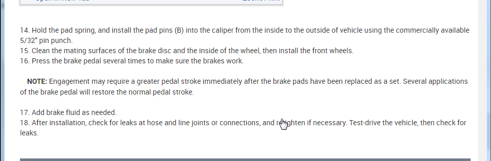

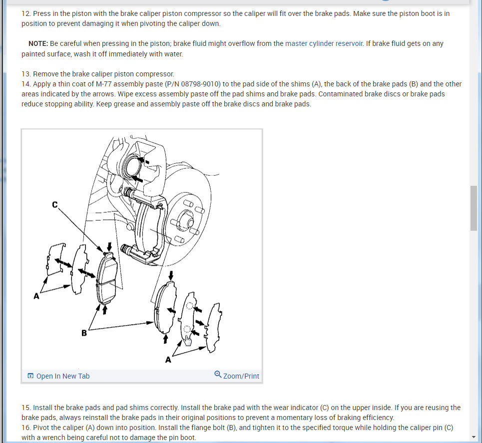

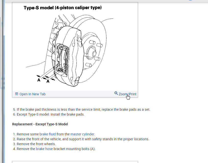

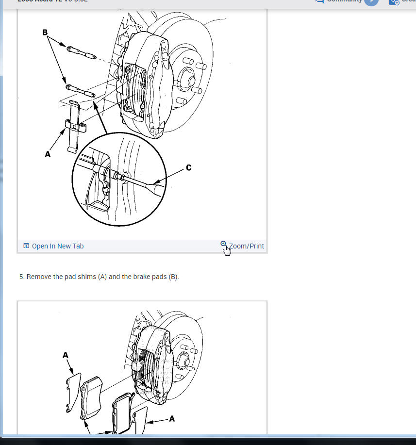

Here is a guide to help you step by step with instructions in the diagrams below to show you how on your car.
Images (Click to enlarge)
