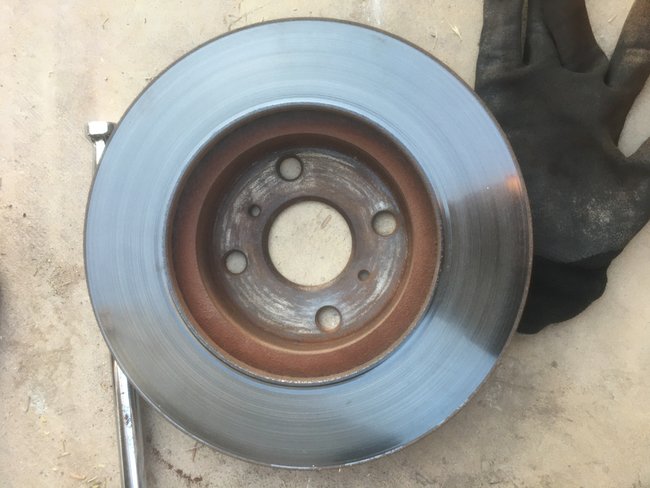

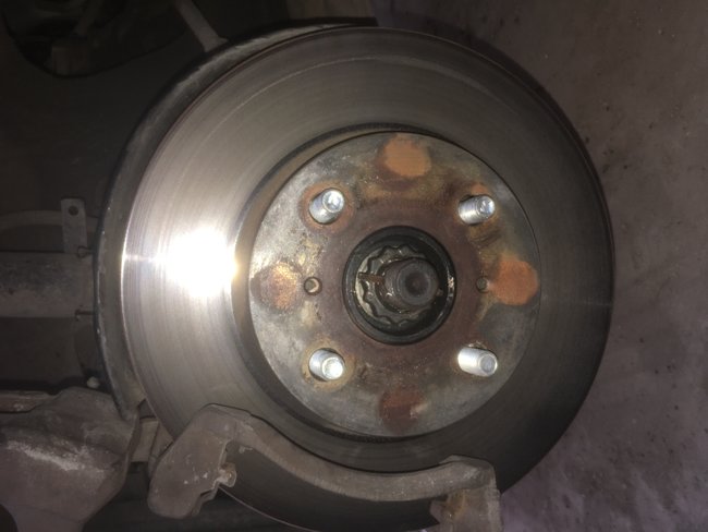

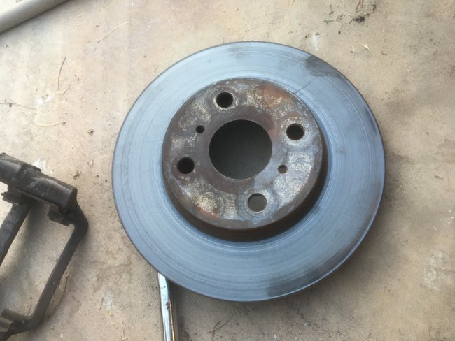

Hello all. Whenever I brake especially at high speeds, the brake pedal shakes in my car and the steering wheel does as well (the brakes look extremely well”). I have seen that the common issue are the brake rotors. They do look pretty worn and even the driver side has a deep weird groove. There is no minimal thickness shown inside the rotor. Judging by the pictures do they need to be replaced? Thank you.

The rotors look okay, but it's very hard to tell from a picture. For the price of new ones and as you have those off already I would clean the hub surface of any rust and put new ones on. However the issue could be two fold with the rear brakes causing the shaking pedal and a front tire out of balance causing the steering wheel shake.
First thing would be change the rotors, if the issue is gone then it is likely that those rotors are either bent "warped" or they have thickness variations. If the problem is still there rotate the tires and see what that does. If it's still there then you will want to look at the suspension for loose parts like ball joints or tie rod ends.

Okay, if the only issue is while braking, swap the rotors, replace the pads and make sure the calipers are good and moving as they should. Might be a good idea to check the rears while you have it apart, just as a precaution.
