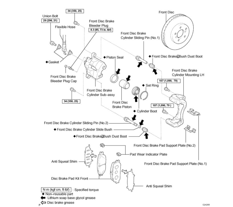

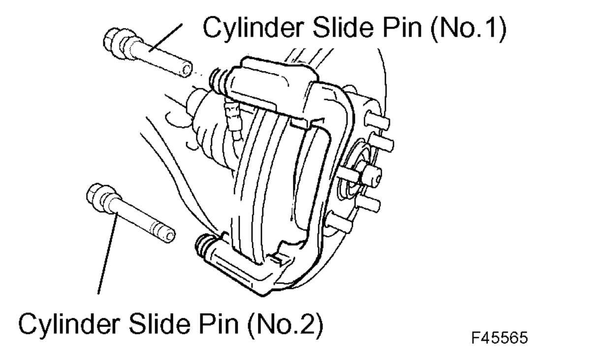

I've changed my brake pads and when it was time to change the brake rotors, I had purchased the wrong ones. What the shop did not to waste time, is sharpened the brake rotors that the vehicle had. I'm hearing screeching sounds and muffled sounds when I brake only. I assume it's the brake rotors. When sharpening brake rotors, how long can the rotors last and is it a good idea?
Now, I want to purchase brake rotors. What brand is good and how about pricing. Should I go with the most expensive ones or at the least expensive okay.

Good afternoon,
The finish is not correct on your old rotors and that is why you hear the noise.
I would replace them with new. Raybestos is a good brand to use. I have had great success with that brand.
I attached the procedure below for you of the repair.
FRONT BRAKE
OVERHAUL
HINT: Overhaul the RH side by the same procedure as the LH side.

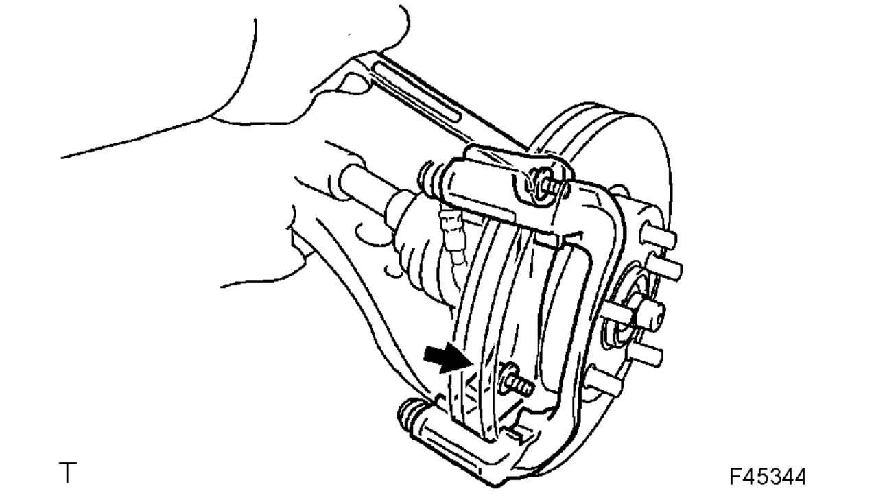

3. REMOVE FRONT DISC BRAKE CYLINDER SUB-ASSEMBLY
a. Remove the union bolt and 2 gaskets from the front disc brake cylinder sub-assembly, then disconnect the flexible hose.
b. Hold the front disc brake cylinder slide pin and remove the 2 bolts.
4. REMOVE DISC BRAKE PAD KIT FRONT (PAD ONLY)
a. Remove the disc brake pad kit front from the front disc brake cylinder mounting LH.
5. REMOVE ANTI SQUEAL SHIM KIT FRONT
a. Remove the anti squeal shim and pad wear indicator plate from the each pad.
6. REMOVE FRONT DISC BRAKE PAD SUPPORT PLATE
a. Remove the front disc brake pad support plate (No.1) and front disc brake pad support plate (No.2) from the front disc brake cylinder mounting LH.
7. REMOVE FRONT DISC BRAKE CYLINDER SLIDE PIN
a. Remove the front disc brake cylinder slide pin (No. 1) and front disc brake cylinder slide pin (No.2) from the front disc brake cylinder mounting LH.

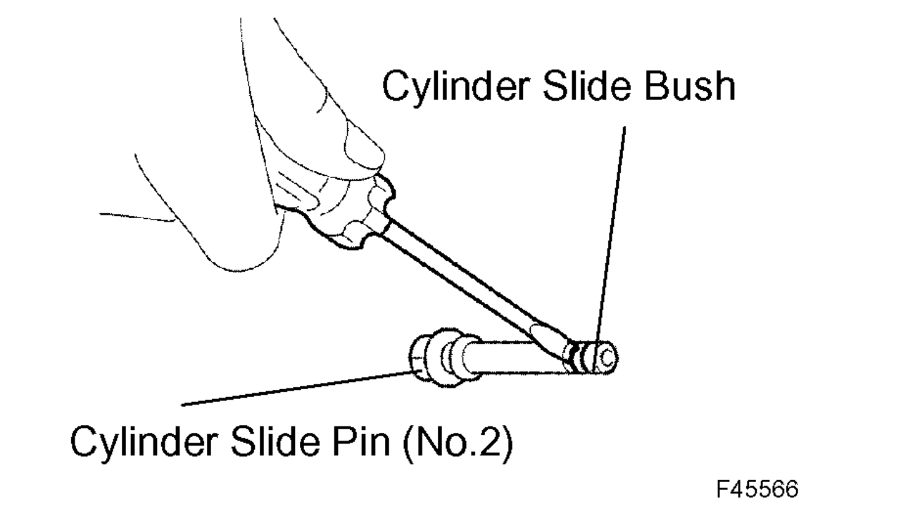

8. REMOVE FRONT DISC BRAKE CYLINDER SLIDE BUSH
a. Using a screwdriver, remove the front disc brake cylinder slide bush from the front disc brake cylinder slide pin (No.2)
NOTICE: Do not damage the front disc brake cylinder slide pin (No.2).
9. REMOVE FRONT DISC BRAKE CYLINDER MOUNTING LH
a. Remove the 2 bolts and front disc brake cylinder mounting LH.

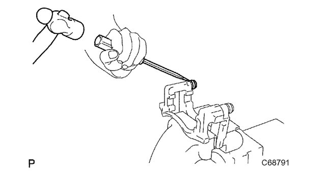

10. REMOVE FRONT DISC BRAKE BUSH DUST BOOT
a. Using soft jaws on the vise, hold the front disc brake cylinder mounting LH in the vise through aluminum plates.
b. Using a screwdriver and hammer, remove the 2 front disc brake bush dust boots from the front disc brake cylinder mounting LH.
11. REMOVE CYLINDER BOOT
a. Using a screwdriver, remove the set ring and cylinder boot.
12. REMOVE FRONT DISC BRAKE PISTON
a. Place a shop rug, between the front disc brake piston and the disc brake cylinder sub-assembly.
b. Use compressed air to remove the front disc brake piston from the disc brake cylinder sub-assembly.
CAUTION: Do not place your fingers in front of the piston when using compressed air.
NOTICE: Do not spatter the brake fluid.
13. REMOVE PISTON SEAL
a. Using a screwdriver, remove the piston seal from the front disc brake cylinder sub-assembly.
NOTICE: Do not damage the inner cylinder and cylinder groove.
14. REMOVE FRONT DISC BRAKE BLEEDER PLUG
a. Remove the front disc brake bleeder plug from the front disc brake cylinder sub-assembly.
15. REMOVE FRONT DISC BRAKE BLEEDER PLUG CAP

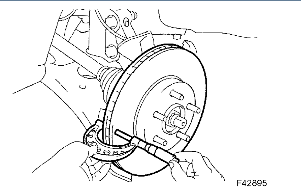

19. INSPECT DISC THICKNESS
a. Using a micrometer, measure the disc thickness.
Standard thickness: 28.0 mm (1.102 inch)
Minimum thickness: 26.0 mm (1.024 inch)
