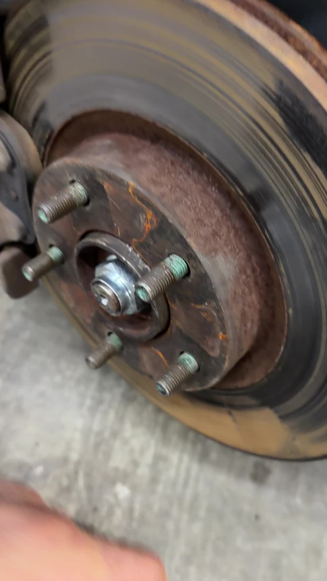

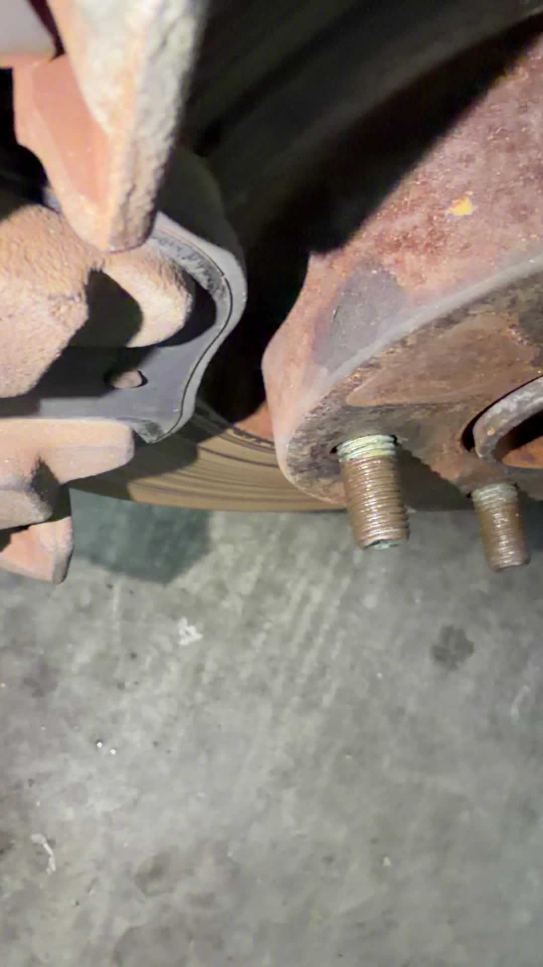

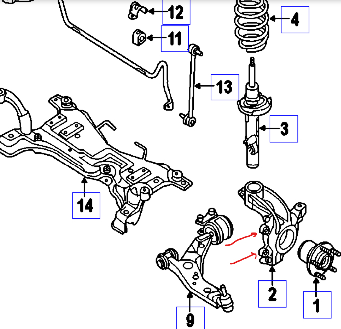

I replaced the left cv axle and whole knuckle assembly because bolts were impossible to remove.since then i noticed the front left was making a noise. I thought maybe the dust shield is rubbing. Took it for some ac work to one of my friends who is good at ac work. Got it back and jacked it up. Can't see anything but the fact that the rotor has some rust from the rain meaning the caliper is not even catching whole driving. Other side is fine. Got some videos for you. Can't see anything wrong. Do these have clips or anything the brakes sit on?

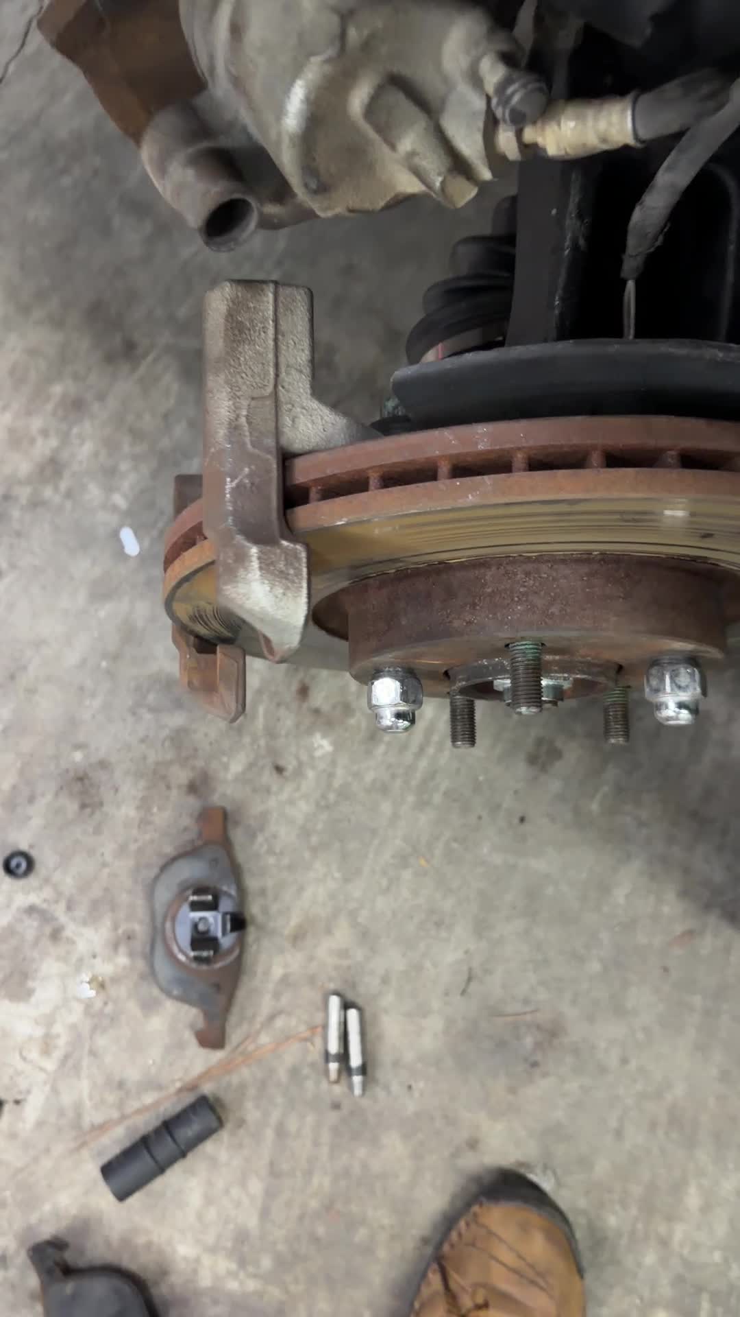

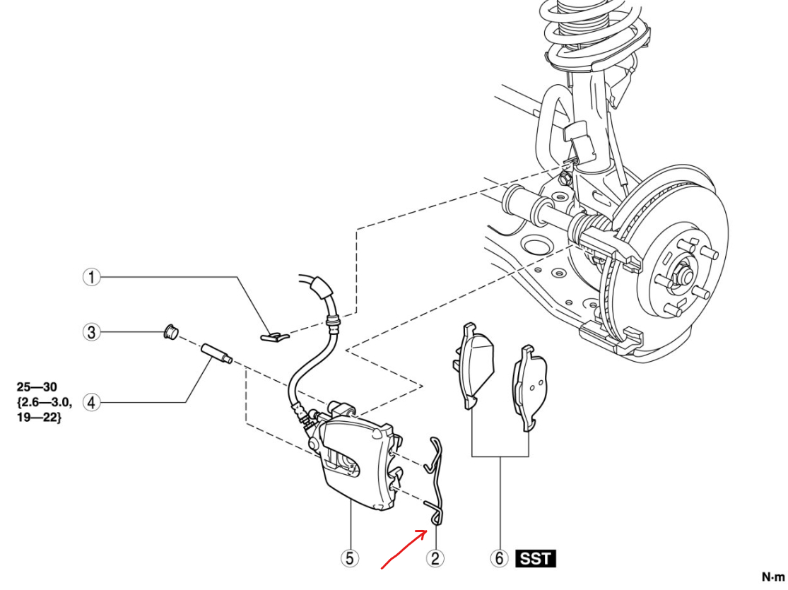

Yep, it looks like the caliper retainer is missing, also it looks like the caliper slides are worn out to the caliper or the slider pins got cross-threaded? Can you double check the fit to the caliper? Here is a diagram of the clip that is missing. Check out the images (below). Let me know what you find.
Jul 15, 2026 at 9:52 AM
BHAMDOC1
  • 423 POSTS
I ordered the clips. I will see how it goes after. Thanks

Are the caliper slides cross threaded?

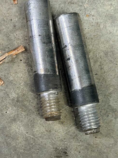

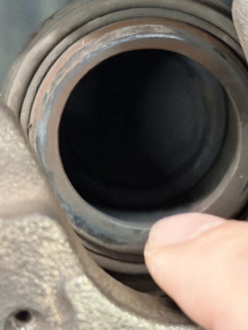

What you mean by caliper slides? The pins?
Jul 15, 2026 at 11:51 AM
BHAMDOC1
  • 423 POSTS
These?
  • 55,691 POSTS
The pins and the caliper look okay, it must be the clip that is missing that is causing that issue.

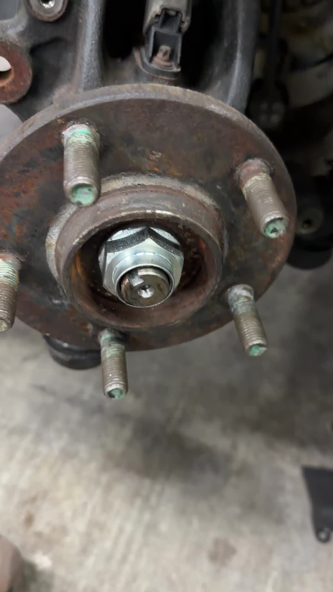

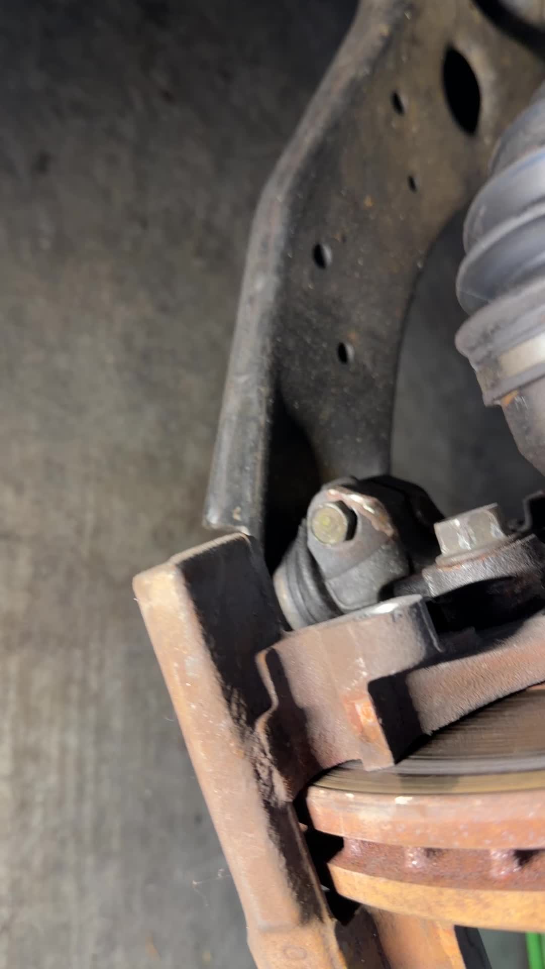

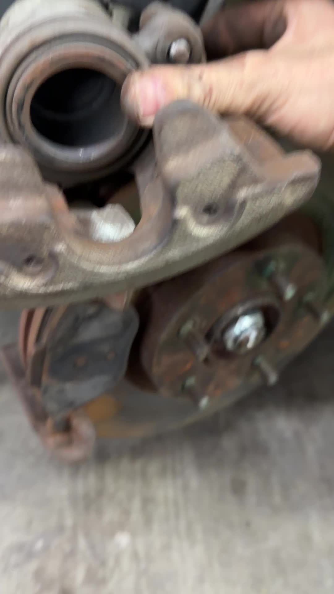

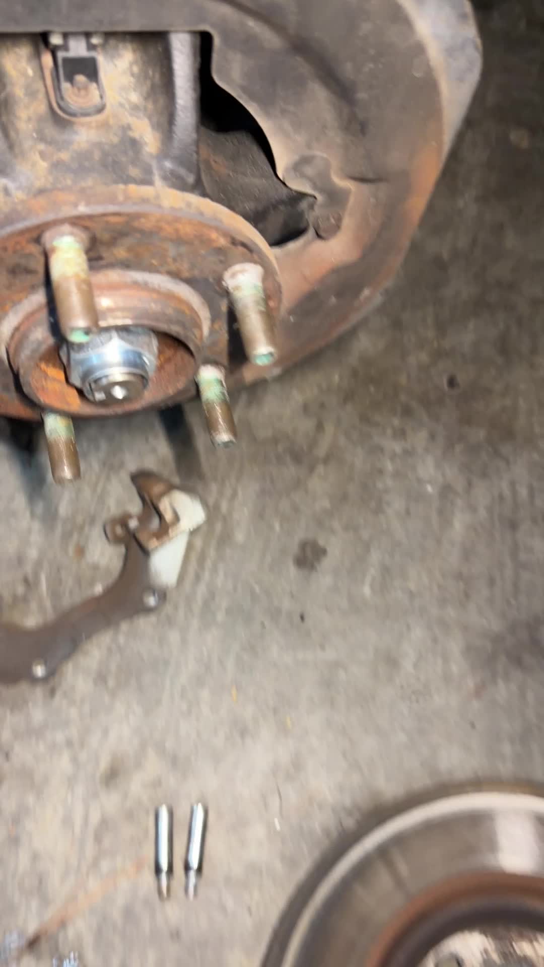

Here
Jul 17, 2026 at 7:47 AM
  • 55,691 POSTS

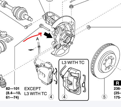

Yep, that makes more sense, it look like there were some spacers that were lost which is making the caliper mount or something is cross thread, not mounted correctly. not straight with the rotor. I would take it back apart to inspect the situation. Please check out the images below. The caliper clip will not help this problem fyi.
Jul 17, 2026 at 8:04 AM
BHAMDOC1
  • 423 POSTS
I didn't see any spacers when I moved it, and I installed the same bracket on the old knuckle without any spacers with the same bolts and it's not touching as you can see in the video
Jul 17, 2026 at 8:07 AM
BHAMDOC1
  • 423 POSTS
I got it. Not sure what it was.But I took everything off, cleaned the center ring of the rotor itself, cleaned the hub with a brush, lubricated the pins, tightened the top bracket bolt first then the bottom, could be that one of the bolts is a bit longer than the other, not sure, but all good now, both fronts were missing the retaining clips.
