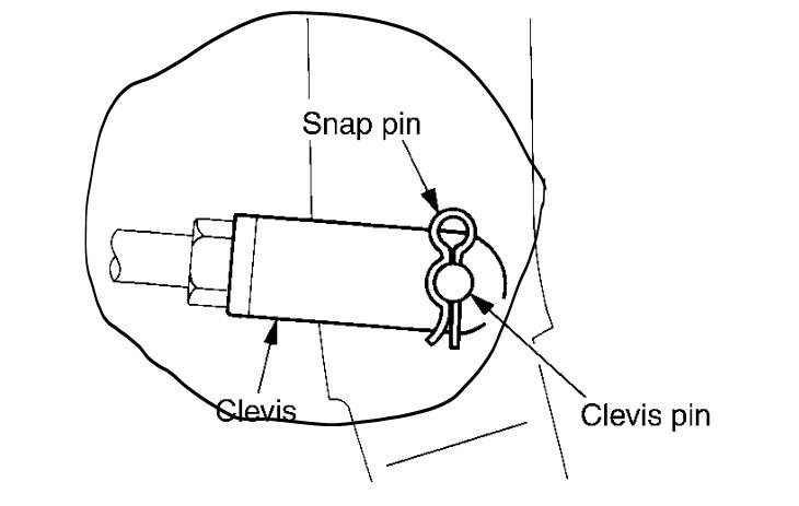

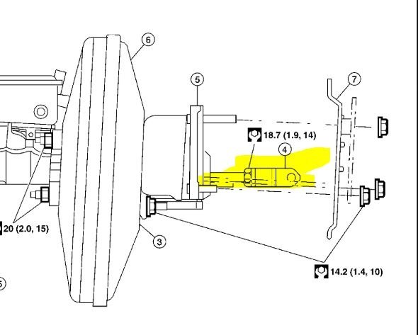

I took my brake and gas assembly off to replace my blower motor and when I put it back in the push rod won't depress.
Aug 17, 2019 at 12:20 AM
  • 110,241 POSTS
Welcome to 2CarPros.
I attached two pictures. Is the highlighted part in picture 1 what you are referring to? If it is, look at picture 2 and let me know if that is how you connected it.

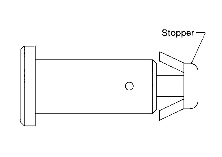

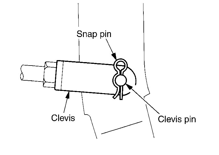

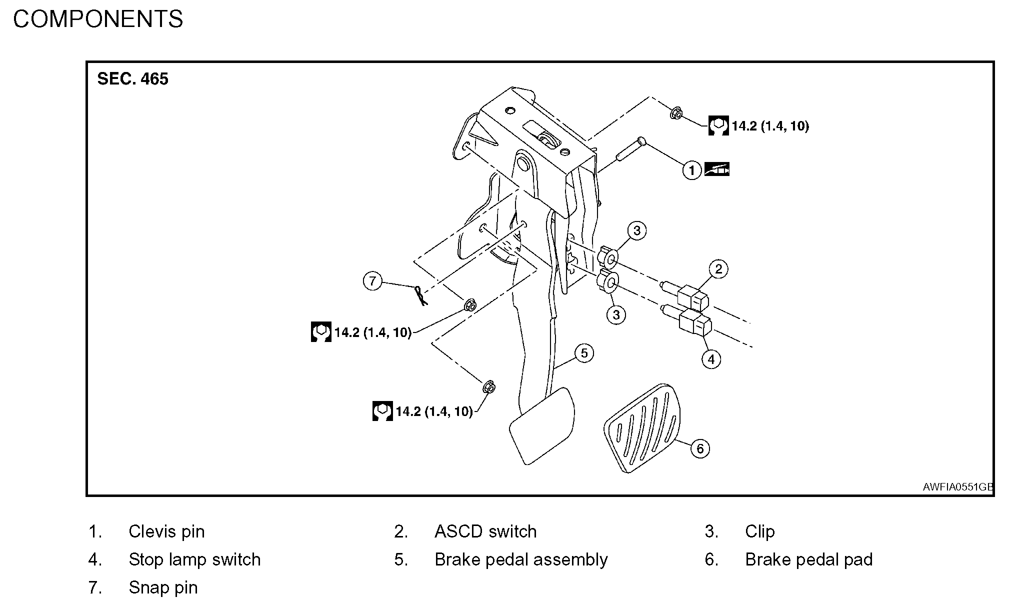

Here are the directions specific to your vehicle for removal and replacement of the brake pedal. See if you did what they explain. The remaining pictures correlate with these directions.
2009 Nissan-Datsun Sentra L4-2.5L (QR25DE)
Removal and Installation
Vehicle Brakes and Traction Control Brake Pedal Assy Service and Repair Removal and
REMOVAL AND INSTALLATION
BRAKE PEDAL
COMPONENTS
pic 3
NOTE:
The clevis pin must be installed from the right side as shown above.
REMOVAL
1. Disconnect accelerator pedal position sensor harness connector.
2. Remove stop lamp switch and ASCD switch (if equipped) from brake pedal assembly.
pic 4
3. Remove snap pin and clevis pin from clevis of brake booster.
4. Remove nuts from brake pedal bracket, and remove brake pedal assembly.
5. Remove accelerator pedal from brake pedal assembly.
INSPECTION AFTER REMOVAL
- Check brake pedal for bend, damage, and cracks on the welded parts.
- Replace brake pedal assembly if any non-standard condition is detected.
pic 5
- Check clevis pin and plastic stopper for damage and deformation.
Replace clevis pin as necessary.
INSTALLATION
Installation is in the reverse order of the removal.
- After installing brake pedal assembly, adjust brake pedal. Refer to See: Brake Pedal Assy > Initial Inspection and Diagnostic Overview > Inspection and Adjustment.
- After installing accelerator pedal, check accelerator pedal for proper operation.
NOTE:
The clevis pin must be installed from the right side.
Aug 17, 2019 at 10:36 AM
DAWNKLIEBERT
Yes, I watched a few videos and made sure to put everything back exactly as I took it apart. It turned out to be pressure built up in the master cylinder as soon as I reconnected the battery and started it it adjusted and works properly. My A/C however is still not working. Think I have to replace the switches. Thank you for your time and help i appreciate it.
