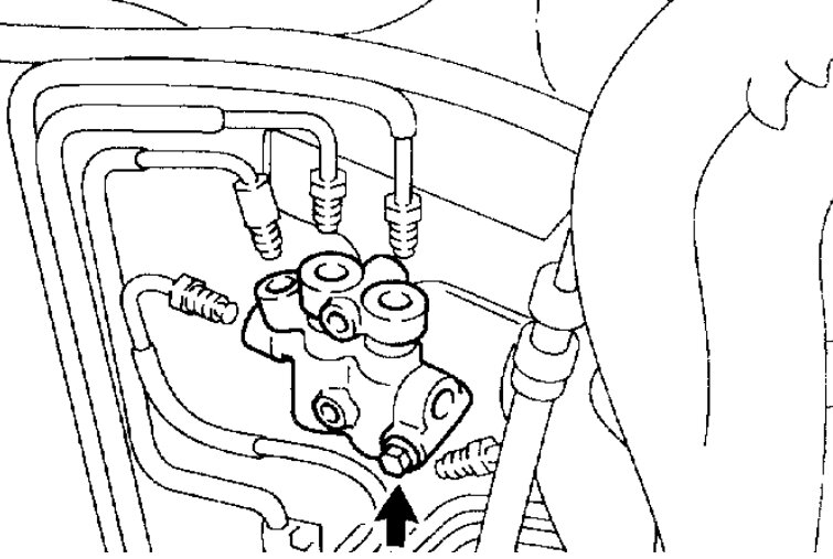

What is the correct part number for the Brake Proportioning Valve for this vehicle?
2003 TOYOTA CAMRY SOLARA
150,000 MILES • 3.0L • 6 CYL • 2WD • AUTOMATIC
MICHAELTHE LOVER
The original brake proportioning valve on this car has 5 ports. I have checked a dozen OEM online parts stores. Nearly all of these site's state that the specified OEM Toyota replacement part is Part No. 47150-33020. However, that part has only 4 ports.
What is the correct part number for a replacement proportioning valve for my car?
Thank you for any assistance you can provide.
The vehicle listed above is an SLE model. Vin: 2T1CF28P03C602965

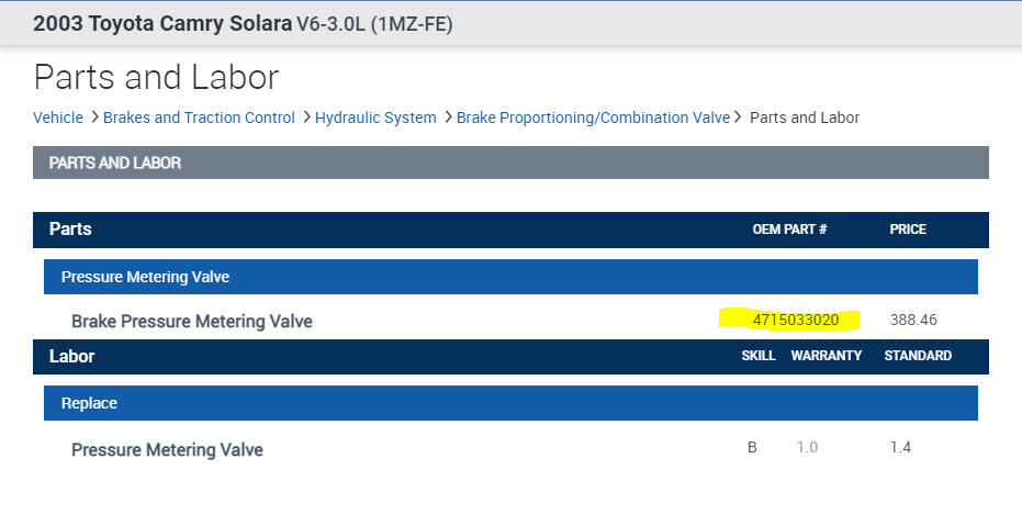

Interestingly, that is the same part number as my manual shows. See pic 1. And yes, it is for 4 lines. When I look under Camry only (not Solara) it shows me the one you need but there is no part number. See pic 2 below.
I did a little more research and "Think" you have a late model 2003 production vehicle, and 2004 parts may have been used. The part number I believe you are looking for is 9041210140. Take a look online and let me know if that is what you have.
