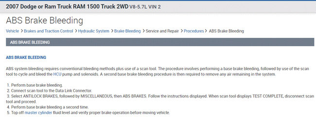

It sounds like you are doing things correctly. I do have a question. When you had a helper, did you have him pump the brakes, hold pressure on the pedal, open the bleeder, close the bleeder and then release the pedal? Also, the automated bleed should have eliminated air from the ABS. Again, did you have the bleeder closed before releasing the brake pedal?
I attached the directions for the automated bleed procedure below. What you did sounds spot on. You may have gotten a bad MC.
Take a look through this link:
https://www.2carpros.com/articles/brake-pedal-goes-to-the-floor
See pic.
