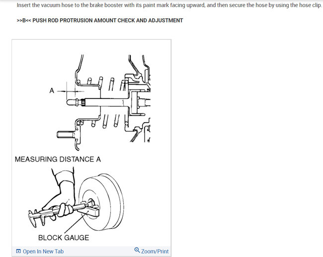

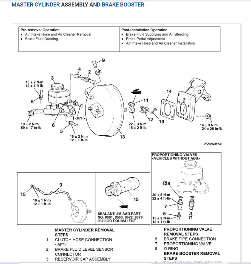

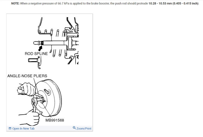

This sounds like one of the wheels has an issue with worn-out linings.
https://www.2carpros.com/articles/brake-pedal-goes-to-the-floor
The fact that the pedal does not work the first time tells me you may have a bad master cylinder. Check the fluid. If it is good, then I would suggest replacing the master cylinder as a start.
https://www.2carpros.com/articles/how-to-replace-a-brake-master-cylinder
