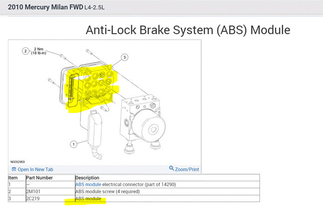

If a module fails, you shouldn't have the brake go to the floor. That would be a serious hazard. Did you recheck the master cylinder reservoir level again? Also, did they happen to mention the module names?
To the best of my knowledge, there is one ABS module. See pic below.

Thanks for the quick response. The said I needed ABS module and HCU.

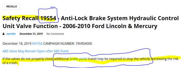

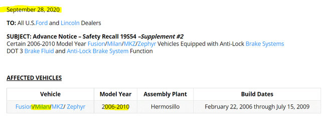

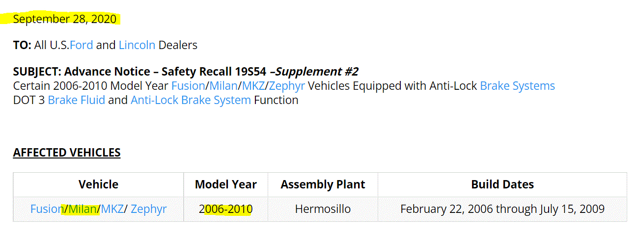

There is a safety recall on the HCU. Was it ever replaced or repaired under the recall? I know you mentioned it was at a dealership. Contact them and request they check if this falls under the recall. Note: The issue with the HCU is certain brake fluids cause the valves to stick open. See pics below. If the HCU is bad, the module will not function properly.
Go to this link for more information:
https://ford.oemdtc.com/4966/safety-recall-19s54-anti-lock-brake-system-hydraulic-control-unit-valve-function-2006-2010-ford-lincoln-mercury
Let me know if this helps or if you have other questions. Also, this recall was published in September of 2020, so it's not that old.
See pics below. Note: I circled the recall number and highlighted the potential effects. You shouldn't have to pay for this repair.

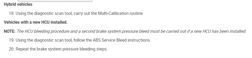

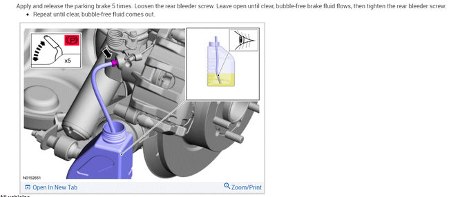

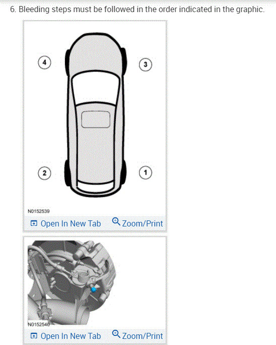

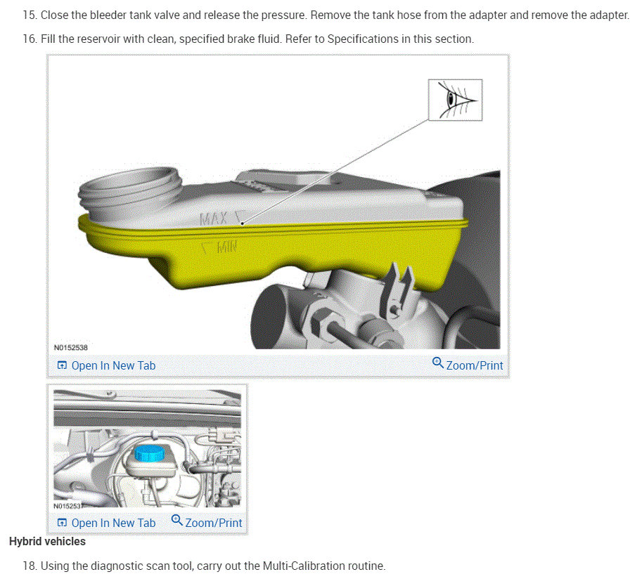

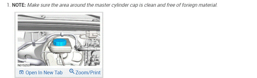

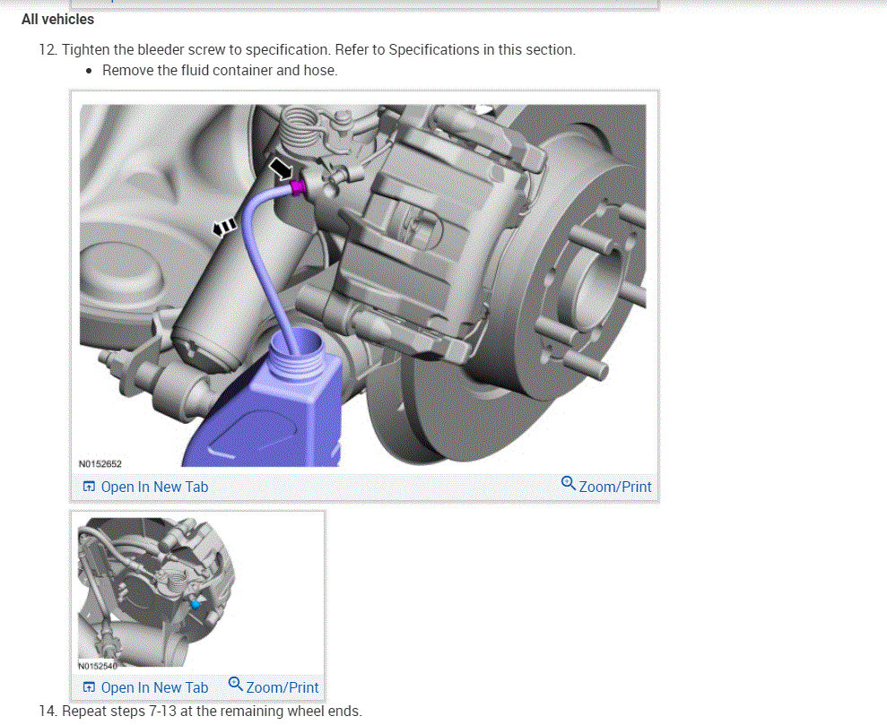

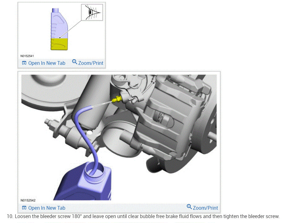

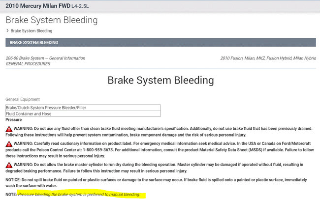

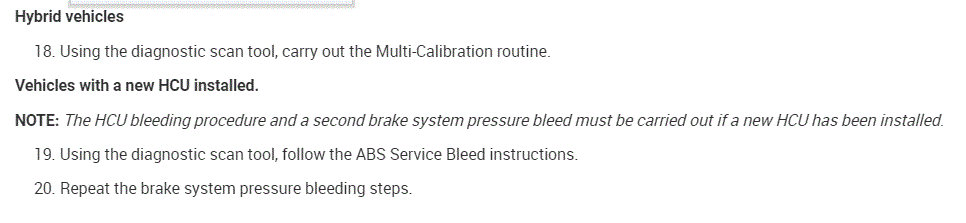

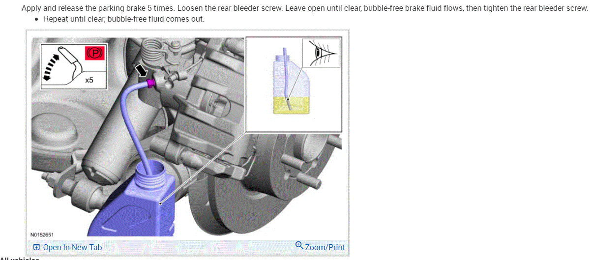

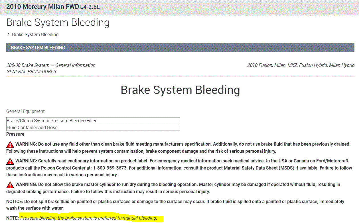

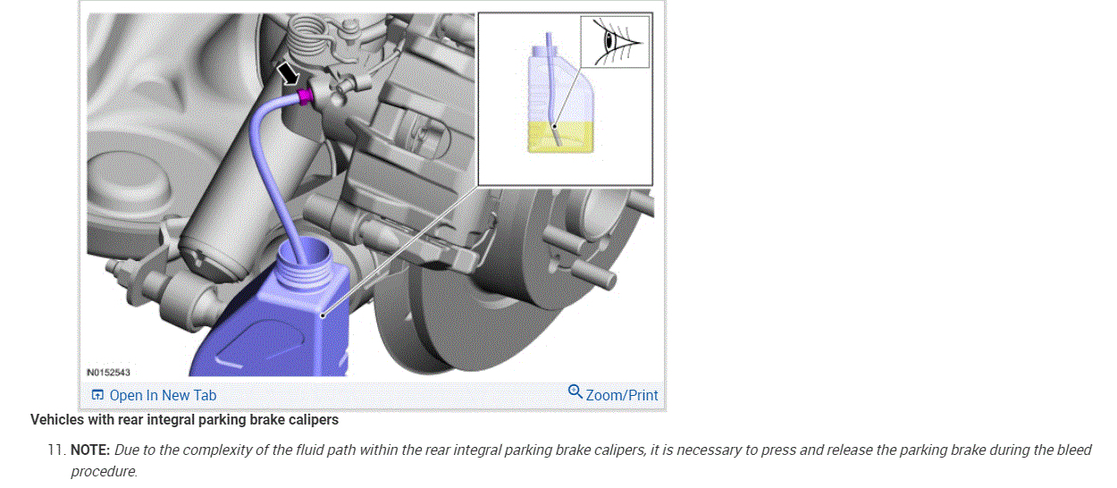

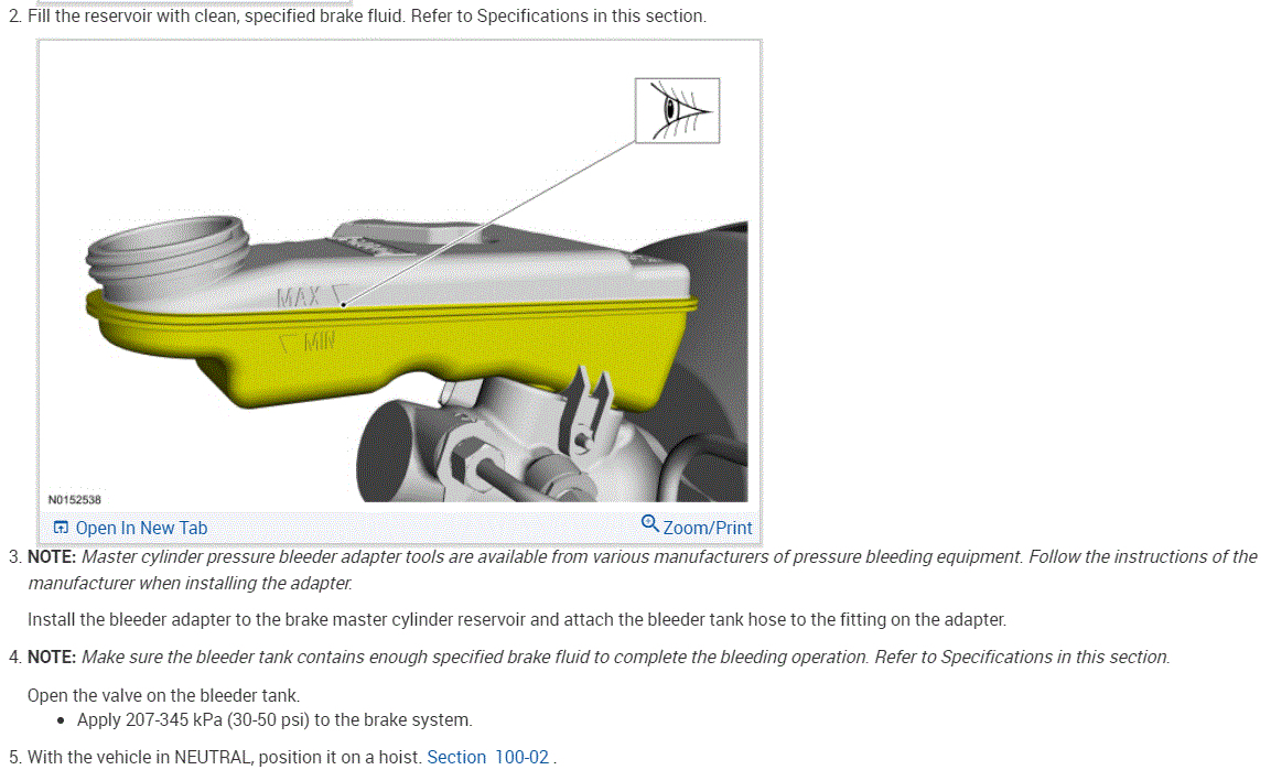

I found the bleeding procedures right from my manual. I attached them below. I suspect you have already performed it this way but wanted you to see it.
Now, if you did it this way without change, then we need to check the HCU. If a valve is stuck open, it may be causing the issue.
By any chance, did you get the diagnostic trouble codes from the dealer that said it needed two modules replaced?
