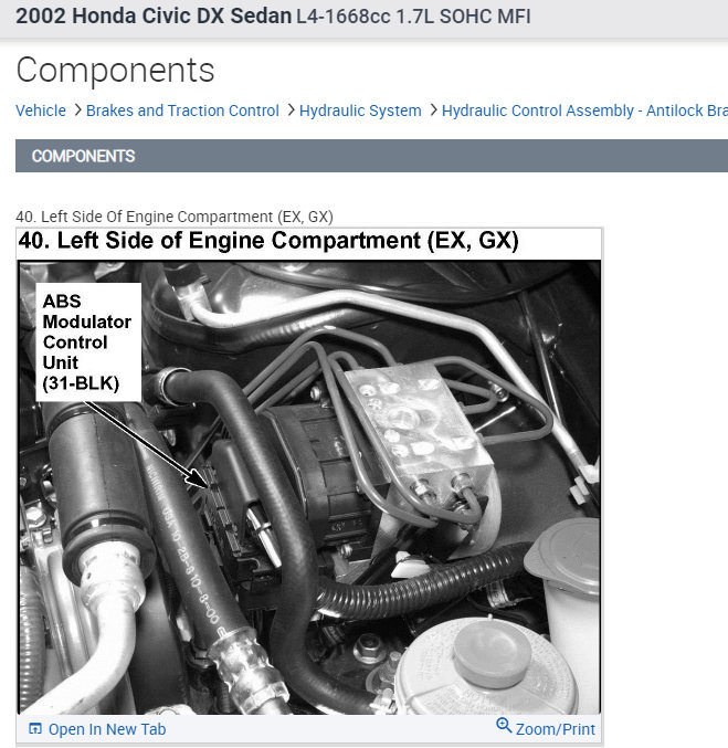

I could bleed the rear driver but not the rear passenger. There's hardly any brake fluid coming out of the brake line. I disconnected it from the wheel cylinder and pumped the brakes.

I only see one connection at the master cylinder for the rear and six at the ABS pump, but they did brake. The brakes were stuck when I installed them, they were too tight in the drum I didn't set them in the grove they where supposed to go.

Right, those two out of the master cylinder should go to the ABS module and then four will come out of the module for each wheel. I wonder if something just got out of alignment and creating this issue.

I figured it out. I disconnected the rear left ABS hose and there was fluid, but it was black. The stuck shoes heated the fluid in the lines plugging the line I'm a clean in with a vacuum.
