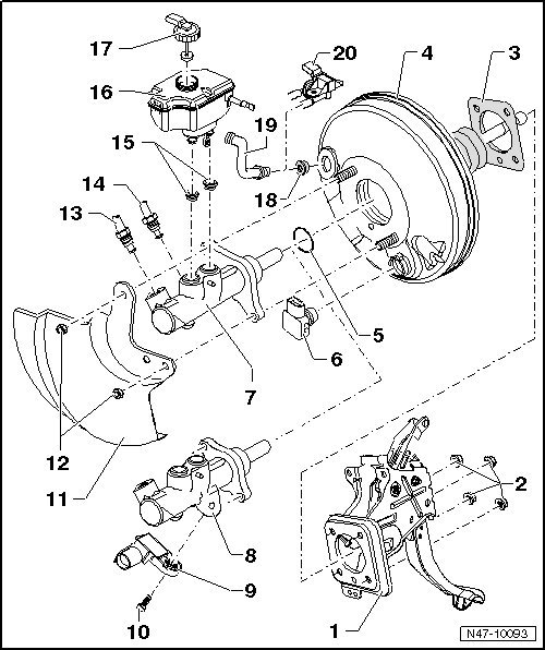

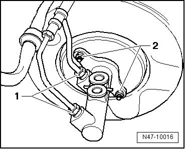

Hi and thanks for using 2CarPros.com. To answer your question, yes. If brake fluid is getting into the vacuum booster, then the master cylinder is leaking. However, that does not necessarily correlate with the brakes getting hot. I have attached an exploded view of the master cylinder and the booster. You will see how they attach. Again, if there is a leak from the rear of the master cylinder, it goes into the booster. If there is actually fluid leaking, the booster is not the problem. The master cylinder is bad and needs replaced.

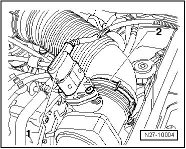

Diesel Vehicles
Disconnect connection - 1 - and remove rear spring hose clamp from intake hose.

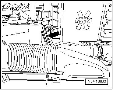

Remove spring hose clamp - arrow - and remove hose from air filter housing.

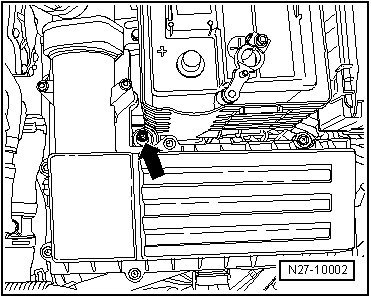

Remove bolt from air filter housing - arrow -.
Move air filter housing upward out of brackets and remove.

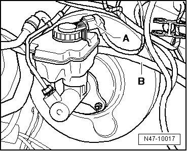

Disconnect clutch master cylinder supply hose - B - with (3094).
Pull off supply hose - B - for clutch master cylinder.
Continuation for All Vehicles
Disconnect connector - A - from floating warning indicator sensor.

Remove the brake lines - 1 - on master brake cylinder, seal brake lines using Sealing plugs (1H0 698 311 A).
Remove the nuts - 2 - from master brake cylinder.

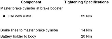

Tightening Specifications

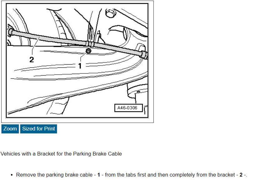

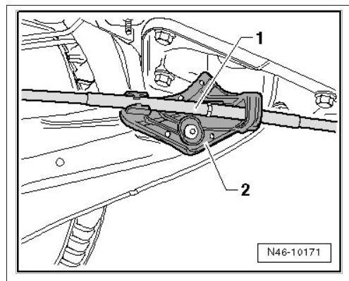

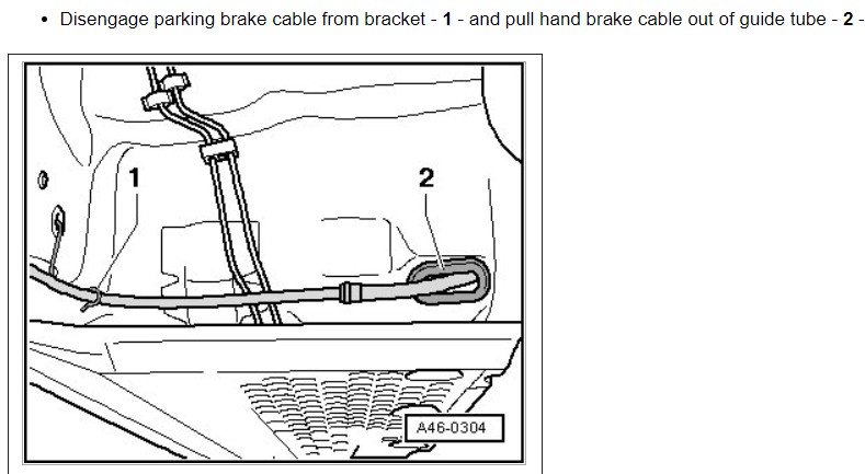

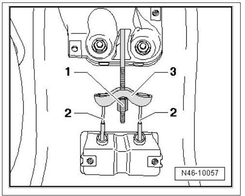

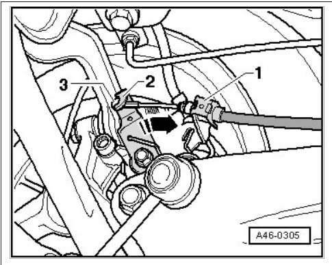

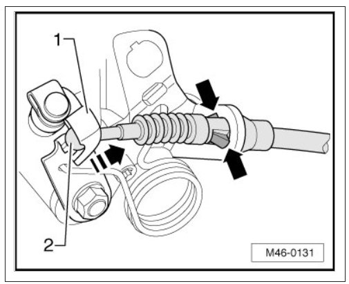

Thanks Steve glad to hear that. I have seen the e-brake cable cause the issue by not releasing fully. Here is a guide to help you replace it.
