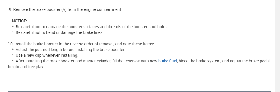

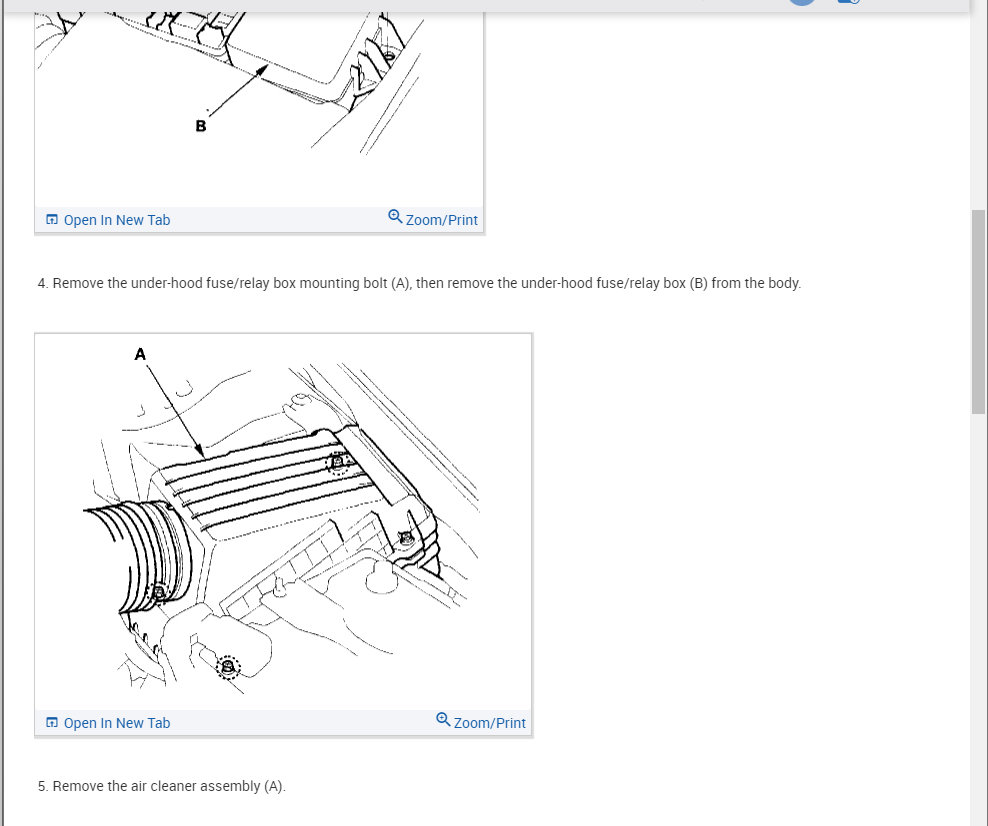

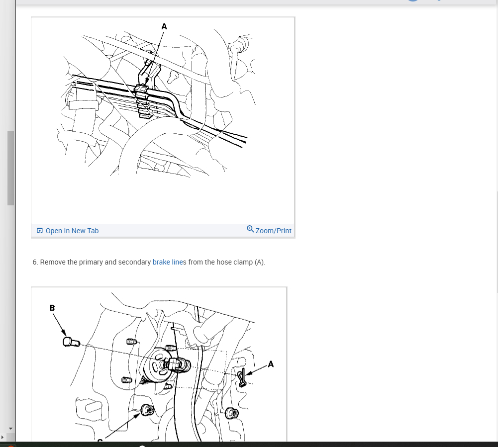

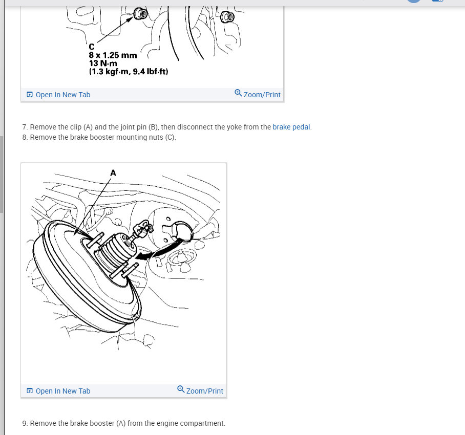

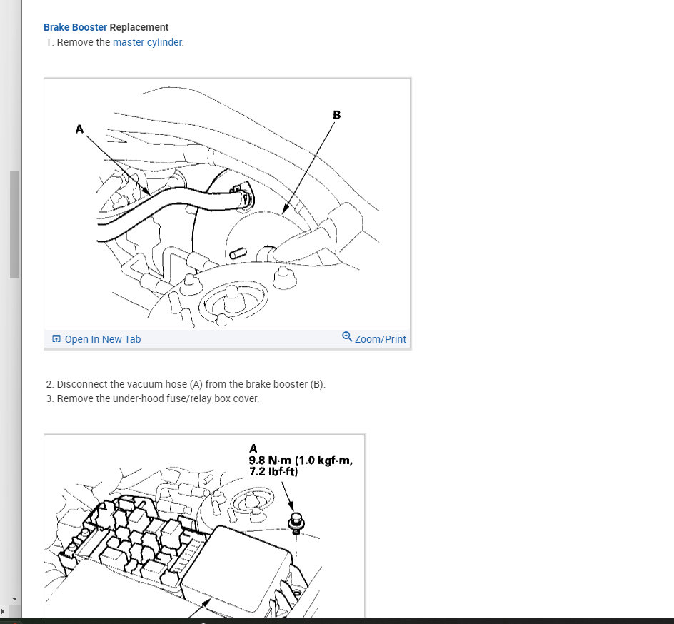

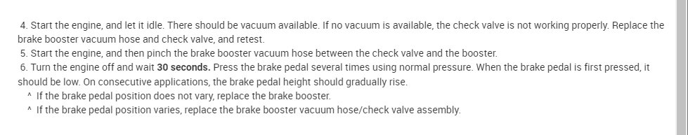

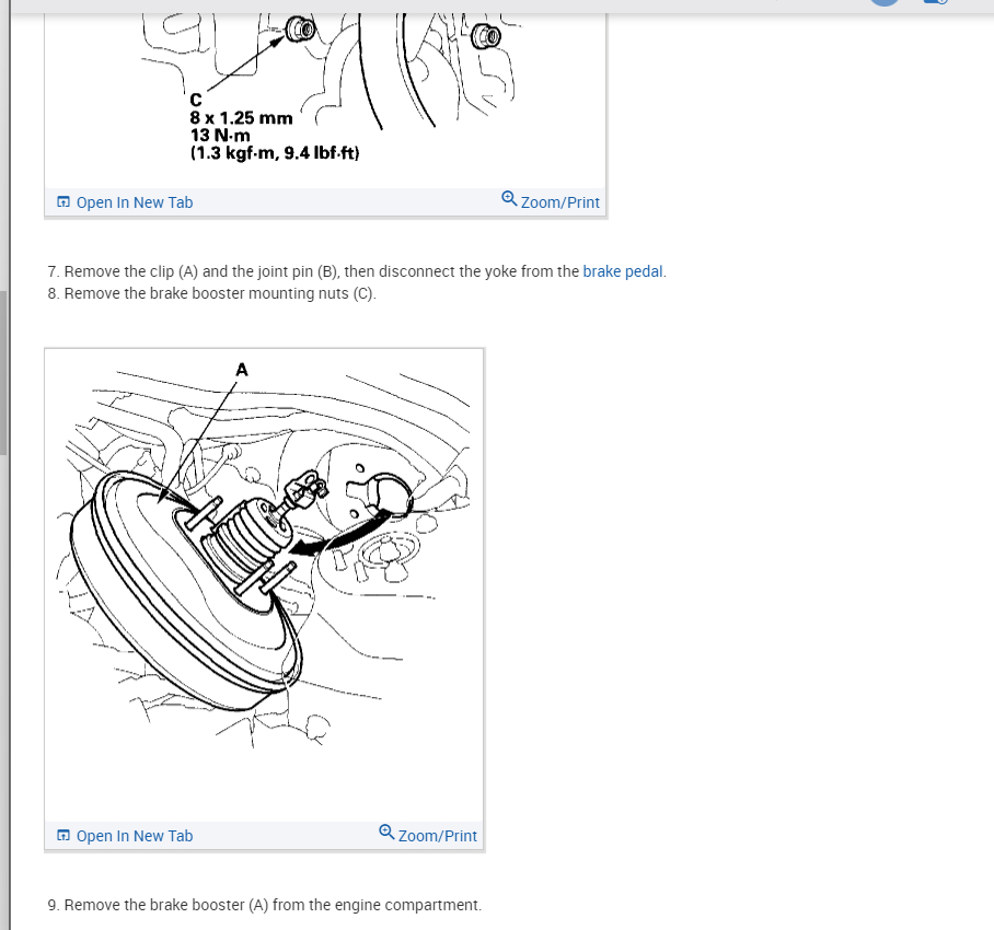

There are a number of things that can cause this but based on what you have done the brake booster is what makes the most sense.
However, here is a guide that will help with this:
https://www.2carpros.com/articles/brake-pedal-goes-to-the-floor

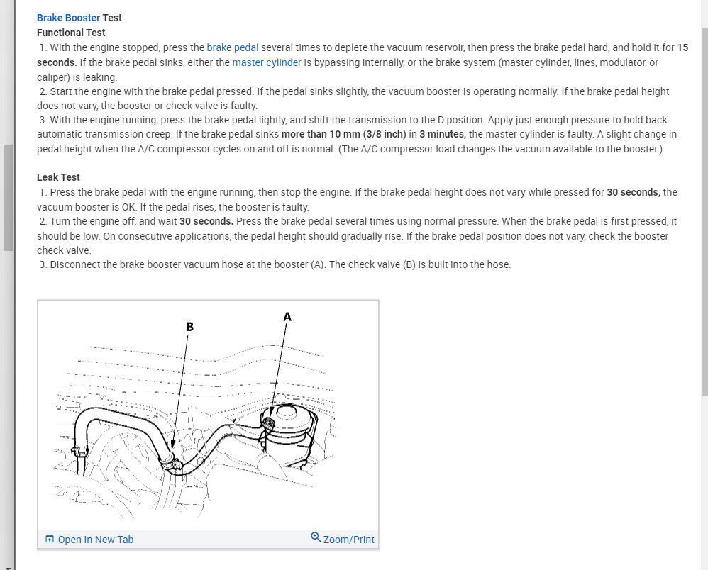

I am attaching the testing for this as well from the manual and the process to replace it as I suspect this is the issue.
Please run through this info and let me know if you have questions.

The test passed in addition, when I" turn off the engine and press the brake pedal 3-times it rises up a little each time. If I disconnect the Power Booster Vacuum line and plug both the engine and Power Booster port will the car perform as if I had regular brakes? I don't understand how the brake pedal can drop so low when not accelerating. Thanks!
Jun 15, 2022 at 11:45 PM
The only connection that the brakes and engine have is the brake booster as it uses engine vacuum.
So, I suspect you have an internal leak in the booster. I understand it may have passed the functional test but that is the only thing that makes sense based on what you are telling me.
When you are not accelerating that is when the engine vacuum is at the highest. So, if the pedal is dropping more than it should before it applies the brakes makes me think we still have an issue in the booster.
