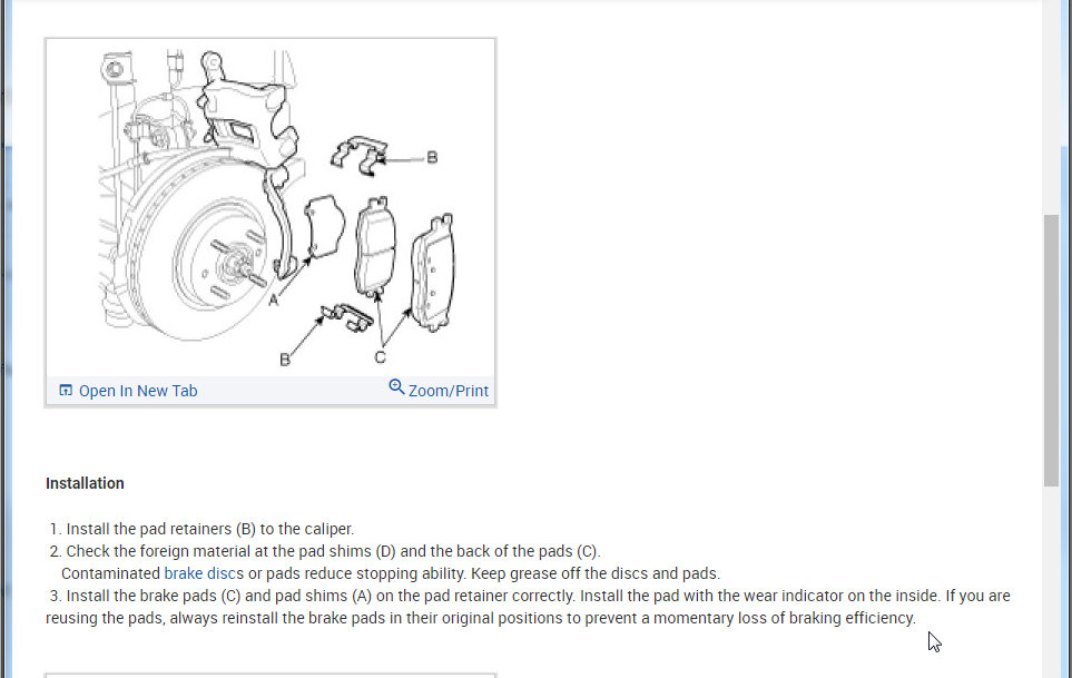

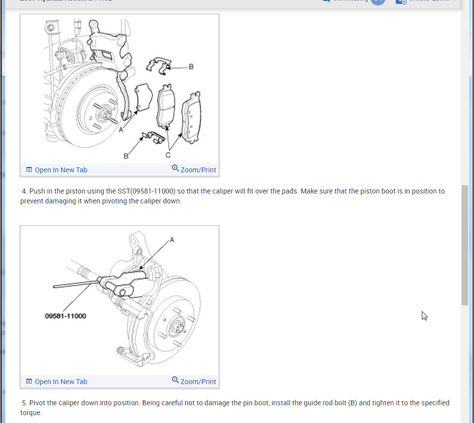

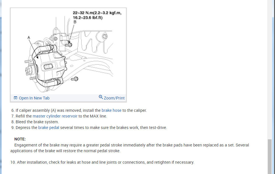

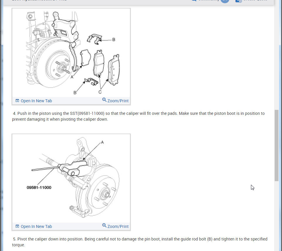

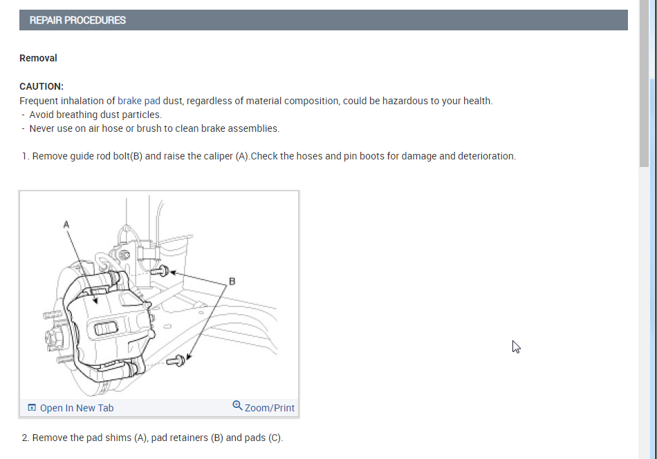

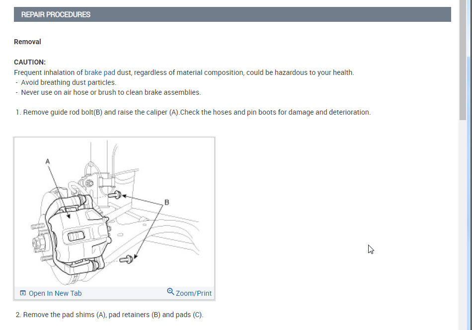

Replaced master cylinder, bled brake lines four times and pedal is still going to the floor. I am lost I think I need front pads.Thank you!
Jan 6, 2019 at 7:19 AM
  • CAR REPAIR CONTRIBUTOR
You could be correct that pads need replaced at this point however, here is a guide that will help with this issue and another guide that will cover how to bleed the brakes in case you are missing something:
https://www.2carpros.com/articles/brake-pedal-goes-to-the-floor
https://www.2carpros.com/articles/how-to-bleed-or-flush-a-car-brake-system

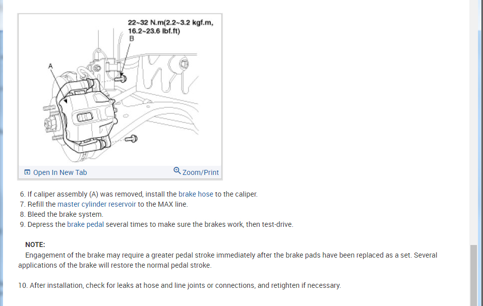

Lastly here is a guide that will help with replacing the brakes:
Below you will find the process on how to replace the brakes from the manual.
Let us know if you have questions. Thanks
