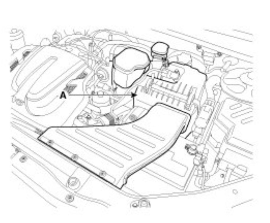

pedal just goes to the floor vehicle will still stop and you can pump up pedal
2013 KIA SORENTO
115,000 MILES • 2.0L • 4 CYL • TURBO • 2WD • AUTOMATIC
JOSEPG
For no apparent reason a bought every 6 month or so the pedal just goes to the floor vehicle will still stop and you can pump up pedal this happens a bought 50 or 60 cycles then it is fine for 6 months or so.there are no external leaks and never uses any fluid.fluid is also clean.when this happens no lights come one no brake pressure light no ABS light no traction control light nothing. And when it is doing it you can test ABS and feel it working.i have replaced front and back pads do to normal wear but never cracked a line or bleeder.before I spend $300.00 on a master cylinder would like somemore input.

If there are no leaks, the master cylinder is the most likely cause Although it is rare to have happen, the plungers in the master cylinder must be allowing fluid to bypass. The ABS won't cause the pedal to hit the floor.
Here is a link you may find of interest:
https://www.2carpros.com/articles/how-to-replace-a-brake-master-cylinder
If you decide to replace the master cylinder, here are the directions. The attached pics correlate with the directions.

1. Remove the air cleaner assembly (A).
pic 1

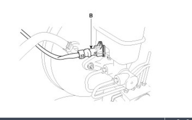

2. Disconnect the brake fluid level switch connector (B) from the reservoir.
pic 2

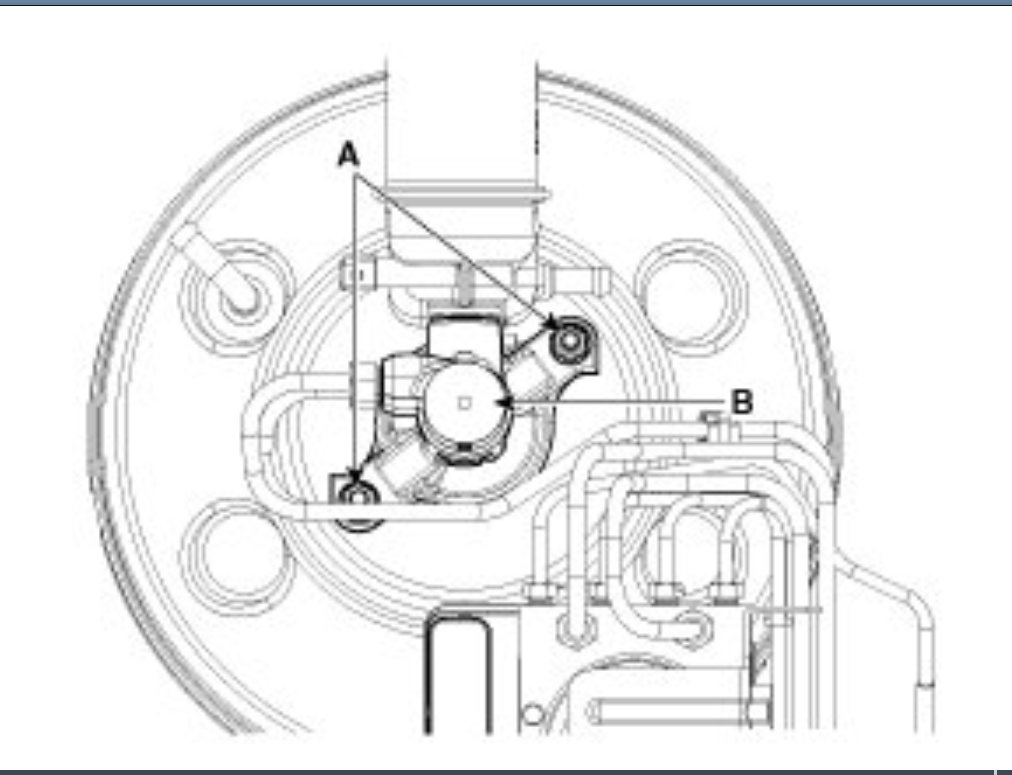

4. Disconnect the brake tube (C) from the master cylinder by loosening the tube flare nut.
Tightening torque:
ESC : 18.6 - 22.6N.m (1.9 - 2.3kgf.m, 13.7 - 16.6lb-ft)
pic 3

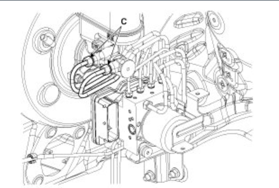

5. Remove the master cylinder (B) from the brake booster after loosening the mounting nuts (C).
Tightening torque:
12.7 - 16.7N.m (1.3 - 1.7kgf.m, 9.4 - 12.3lb-ft)
pic 4

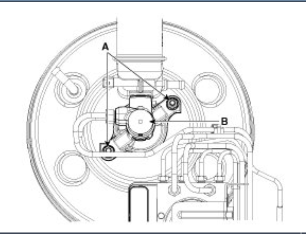

Installation
1. Installation is the reverse of removal.
2. After installation, bleed the brake system.
