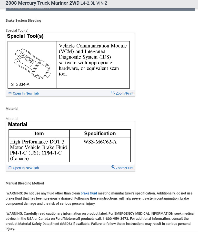

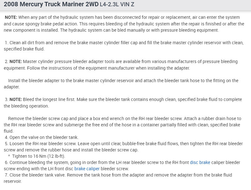

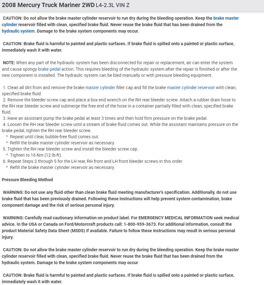

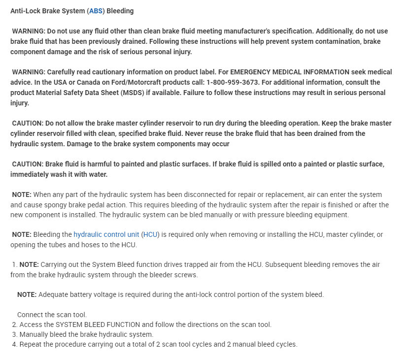

This vehicle does require a scan tool to properly bleed the ABS.
The scanner allows you to open the ABS valves and have a proper bleeding process.
Here is a helpful guide:
https://www.2carpros.com/articles/how-to-bleed-or-flush-a-car-brake-system
I have attached the procedure below for your reference.
Let me know if you have any questions.
Oct 30, 2022 at 2:20 PM
ELIESER PEñA REYES
We already use the scanner to run an OBDII controlled bleeding process. I've already did it two times, and it's still not working properly.
Is it possible that the HCU is damaged? Somehow the pressure releasing valve went all the way always open?
