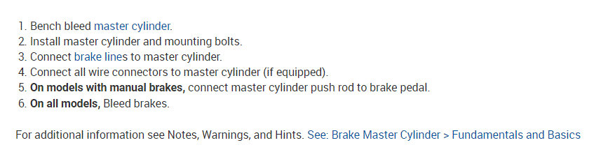

Originally I thought my front calipers were failing causing loss of brakes , replaced those , bled many times and no improvement. Just replaced the master cylinder, being the symptoms all pointed to that being the culprit.
Well we bench bled it , installed it and re bled the front lines again with still no improvement to the pedal.
My brake pedal goes to the floor easily providing 0 brake effort "while making air sounds " and has an extremely slow return rate .
I can build pressure with the vehicle off, but when I turn it on it disappears. When we disconnected the large hose to the brake booster I did gain pedal pressure but it still wont slow the vehicle.

After bench bleeding a whole nother master cylinder and all my lines ,and verifying nothing else is leaking , were convinced the master cylinders I'm buying are faulty . Following every step exactly , they keep end up leaking at the base of the cylinder , between it and the brake booster . Like the rear cylinder seal gives up immediately upon installation.

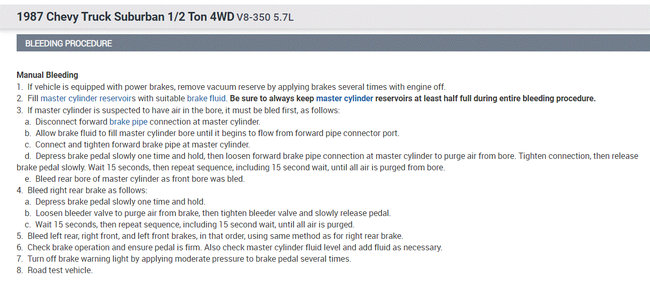

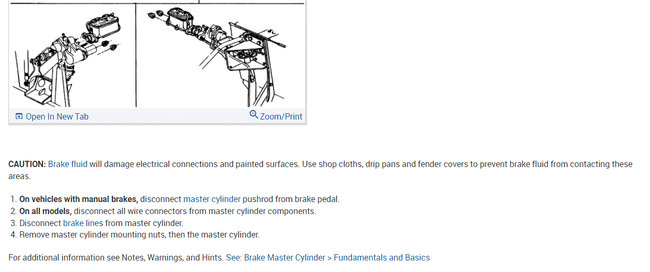

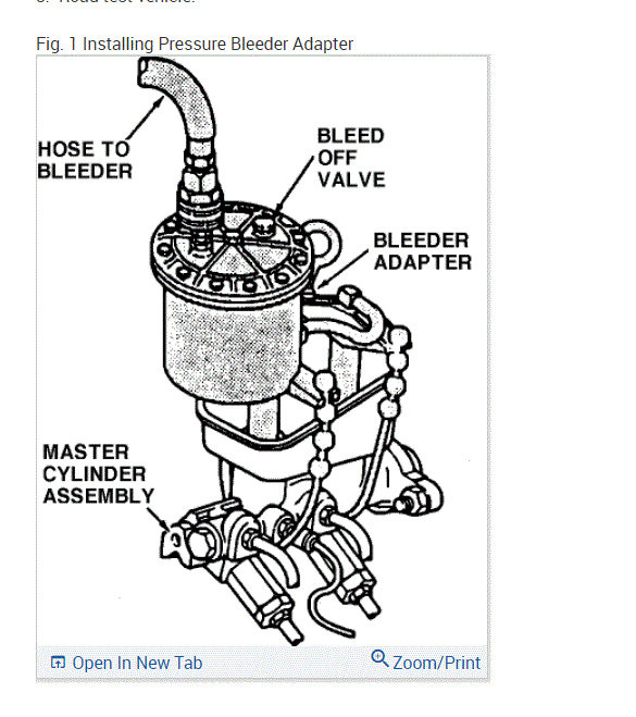

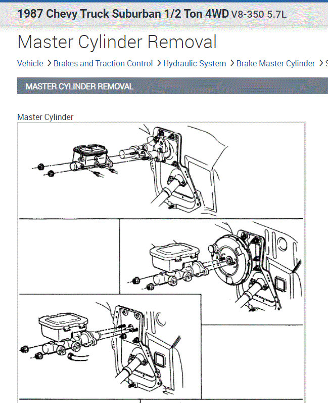

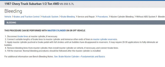

If it is leaking from the rear, you are correct. The rear seal is bad. As far as the hose you removed from the booster, that was the vacuum assist from the engine. With it disconnected, it is like have the engine off. That's why you were able to build pressure.

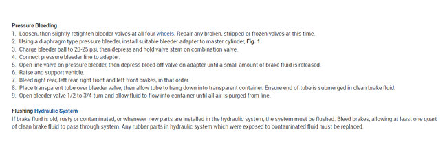

As far as removal and replacement, I attached the directions below from the manual. The last two pics are the procedures for bleeding the brakes.
Let me know if this helps. Also, get a different brand of master cylinder to see if the problem goes away.
Take care and let me know what you find.

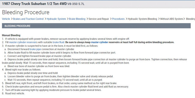

If it's a new master cylinders, fully depressing the pedal shouldn't hurt. When they are old, corrosion and dirt get settled in the plunger cylinder and when the plunger hits those points, they can be damaged and cause fluid to bypass the plunger.
I checked the manual to see if there is anything out of the ordinary, and there really isn't. The manual provides directions for manual bleed and pressure bleed. I attached the directions below.
Let me know Also, you indicated there is evidence of a leak. Are you seeing anything leaking?

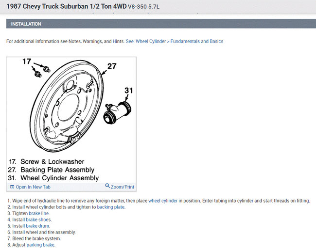

If you start it with the parking brake on, does it stay solid?

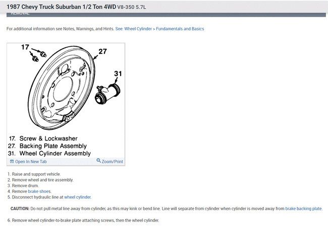

The reason you are likely getting a better pedal is that the brake pads are engaged via the parking brake. This sounds like a bad wheel cylinder. Have you replaced them?
Here is a link that shows in general how it's done:
https://www.2carpros.com/articles/how-to-replace-a-wheel-cylinder
The pics below are specific to your vehicle.
Let me know what you find. If you haven't checked already, pull one of the boots off the wheel cylinder and see if there is evidence of any leakage.

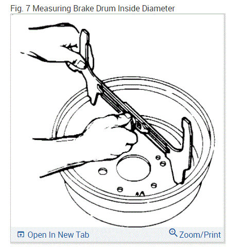

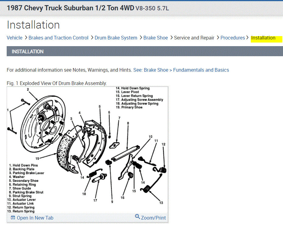

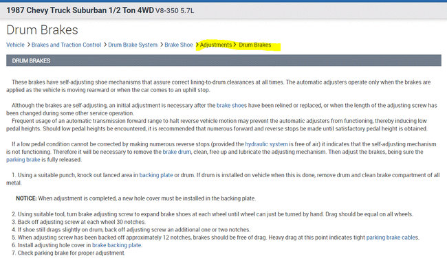

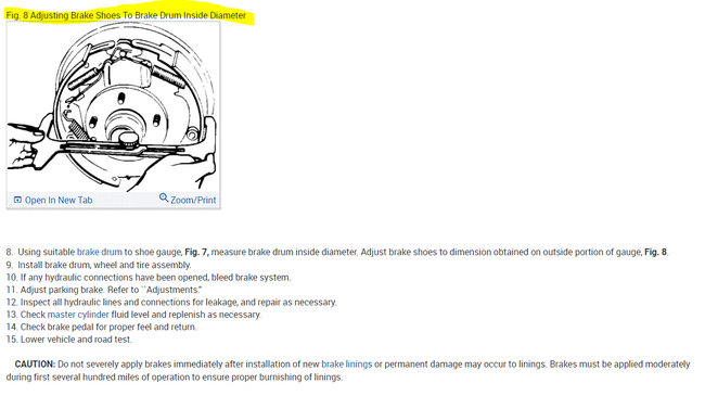

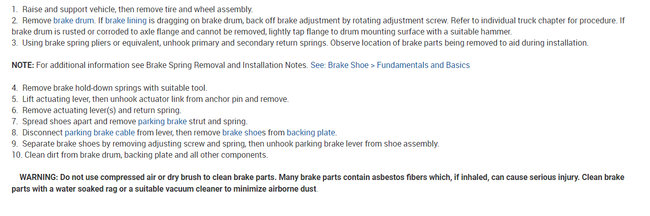

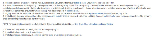

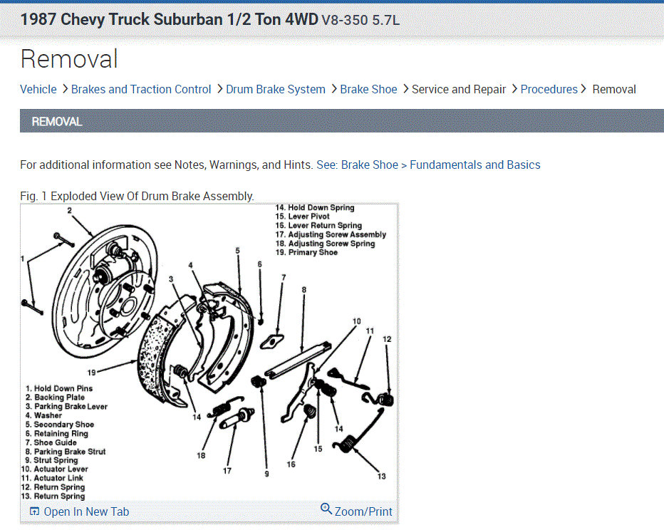

Let me know what you find. Also, here is a link that shows how in general to replace the brake shoes:
https://www.2carpros.com/articles/how-to-replace-rear-brake-shoes-and-drums
If you look at the attachments below, they are the directions specific to this vehicle. Also, I included the adjustment steps.
I have done many of these, so if you run into trouble, don't be worried about asking.
One other thing. If you find a wheel cylinder that needs to be replaced, before you try removing the brake hose from it, wire brush the connector really well and spray it with penetrating fluid. Allow it to sit for a bit and do it again. Otherwise, chances are the steel line will twist and break.

Final update: One last thing I noticed right before I swapped out the last remaining parts "drum hardware kit, shoes, wheel cylinder ". I had perfect pressure with the ebrake on , but would lose pressure once it was released . Thought that was weird . Anyway , I believe the wheel cylinders were the big issue for me. My problem is finally over.
