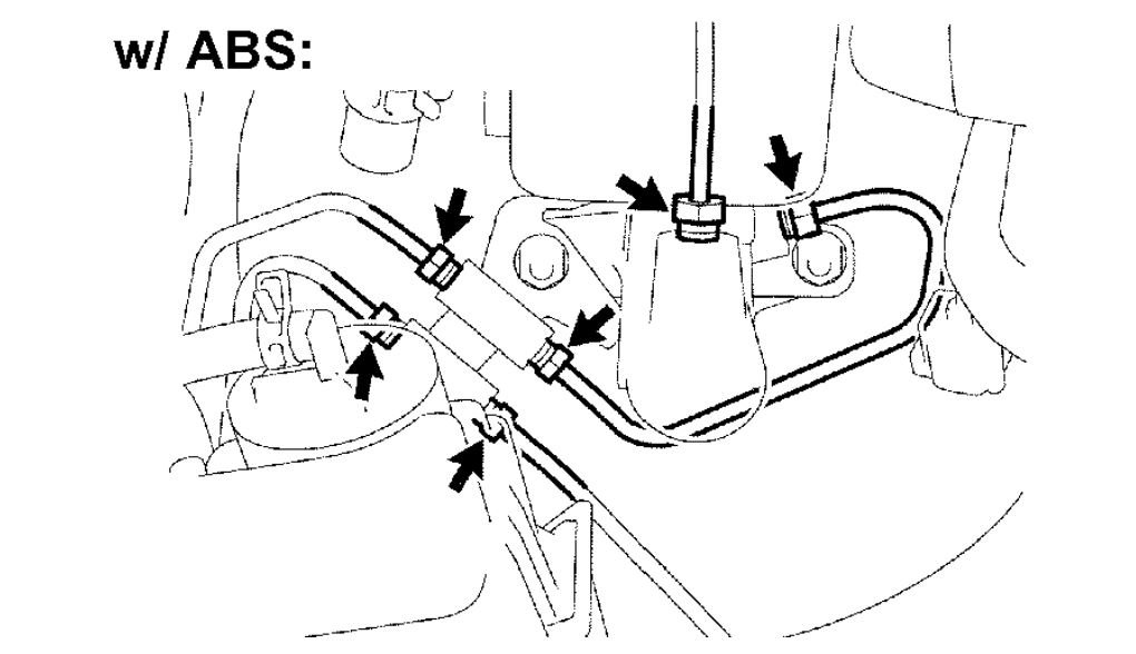

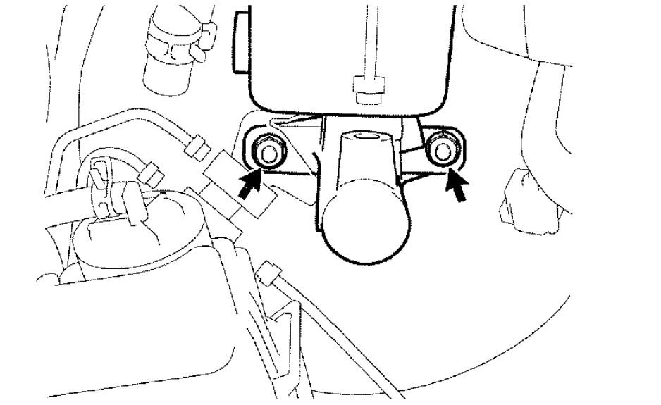

Yes, this sounds like a bad master cylinder.
https://www.2carpros.com/articles/brake-pedal-goes-to-the-floor

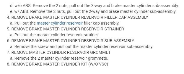

https://www.2carpros.com/articles/how-to-replace-a-brake-master-cylinder
Common for the symptoms you described.

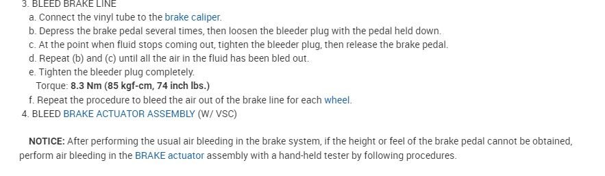

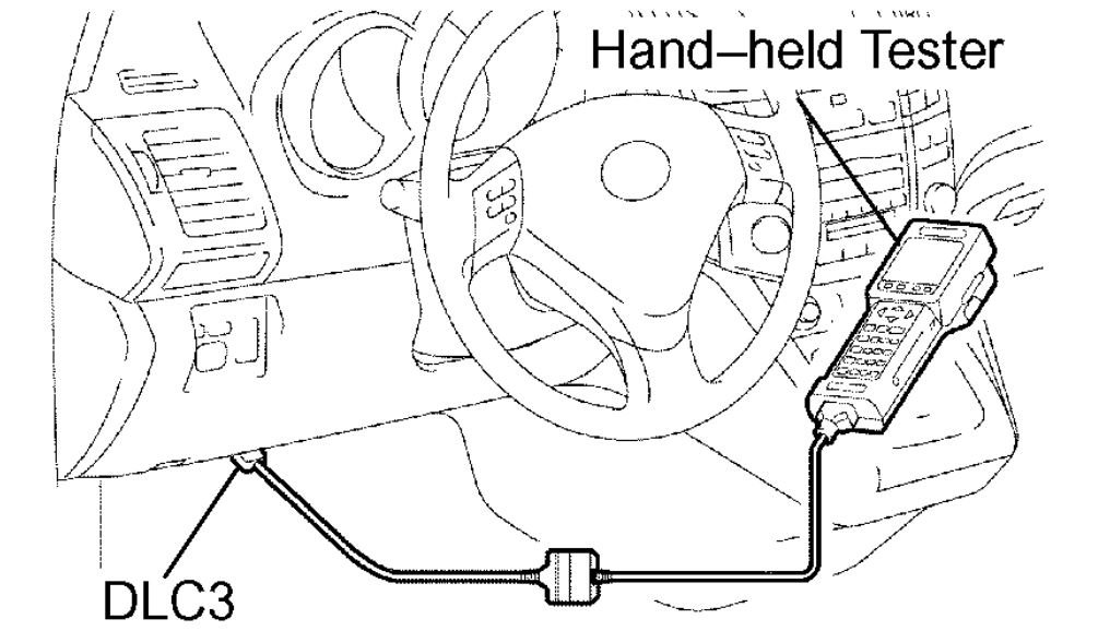

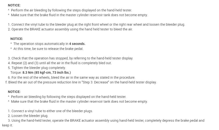

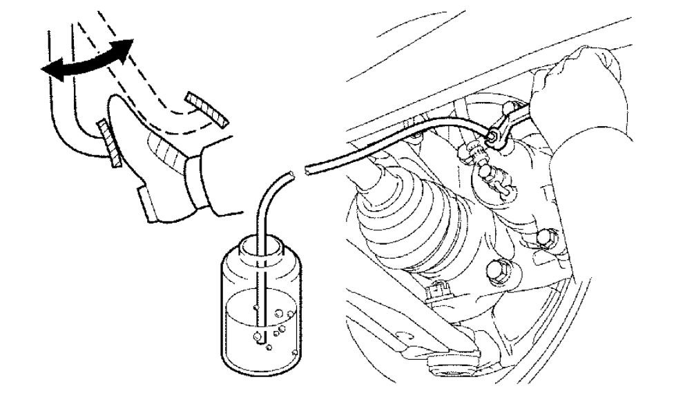

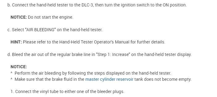

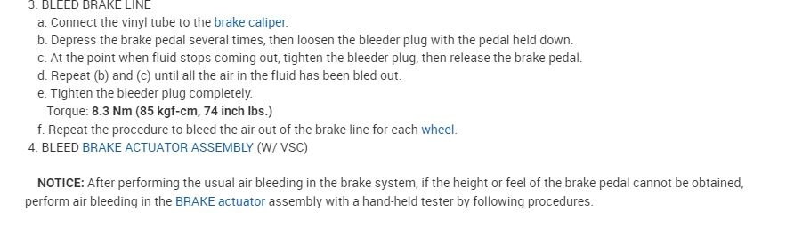

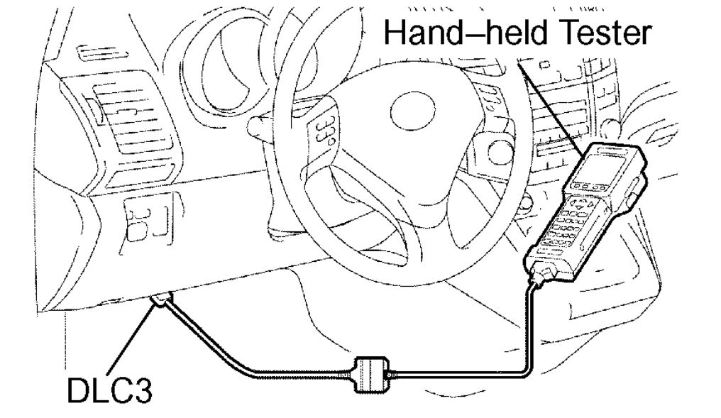

You will need to replace the cylinder, bench bleed the cylinder and then bleed the lines. If you have ABS, you will need to have a scanner that can allow the ABS unit to be bled or you will not be able to get the air our of the lines.
