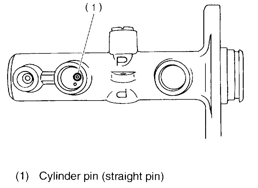

We just had the a new brake power boost unit, new rear drums, brake shoes, and one wheel cylinder replaced (that was leaking) by our local mechanic. Now, when we start the car with our foot on the brake like we always do, the pedal immediately sinks down to the floor. It also sinks down to the floor after coming to a full stop. Otherwise, the brakes themselves feel fine during routine braking when driving. At first, the mechanic used aftermarket brake shoes, and we were experiencing a clunking noise along with a pulsation as I braked from around 30 MPH to a stop, and it was felt in the pedal, as well as the entire motion of the car. I thought it felt like a bad/out-of-round drum, or perhaps a drum with a high spot in it. (BTW, I actually went to Lincoln Technical Institute years ago and almost became an Auto Technician, but went into another field instead, so you can talk tech talk with me.) So, I'm now thinking perhaps the new wheel cylinder he installed might be the culprit? Or, the master cylinder has failed, but I don't personally have time to check it. But the fluid is full in the reservoir, and I don't see anything leaking from it, or from any wheel, or anywhere else. And, the mechanic is basically scratching his head saying, "I don't know what it could be?" What do you think? Thank you in advance for your help! Much appreciated!

Honestly, my first suspect is the master cylinder. The plungers in it use the same area for years. Then, work is done, the system is bled, and the plungers now go to the end of their travel into dirt, corrosion, or anything that has built up. As a result, the plungers are damaged and allow fluid to bypass and the pedal goes to the floor. This past Saturday, I was called in on a similar issue. A brake line ruptured on an S-10. Line was replaced, but they couldn't get proper bleeding and the pedal went to the floor. I explained the same thing, so the tech replaced the MC and after that, the brakes were fine.
If there are no leaks, this is my primary suspect.

2. DISASSEMBLING PROCEDURE
1. Remove reserve tank.
pic 1
2. Remove cylinder pin. (only vehicle equipped with ABS)

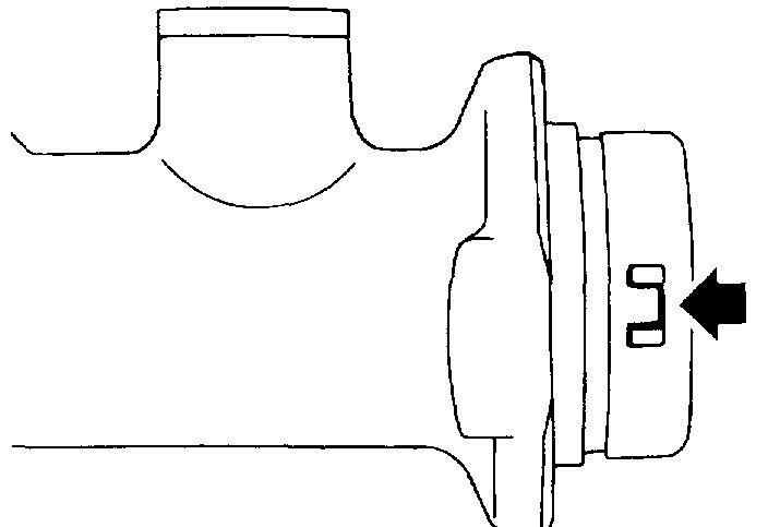

3. Pry up the pawl and remove the piston retainer.
pic 2
NOTE: Piston may jump out from master cylinder.
