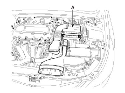

2. Remove the air cleaner assembly (A).

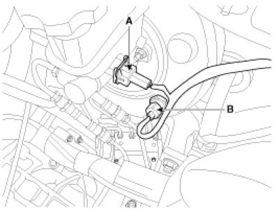

3. Disconnect the brake fluid level switch connector (A), and vacuum switch connector (B).

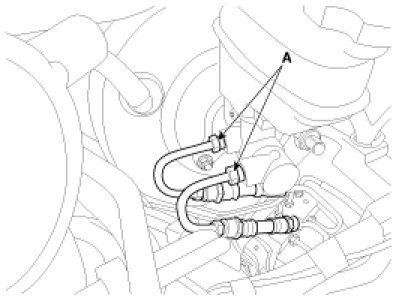

5. Disconnect the brake tube (A) from the master cylinder by loosening the tube flare nut.
Tightening torque:
18.6 - 22.6 N.m (1.9 - 2.3 kgf.m, 13.7 - 16.6 lb-ft)

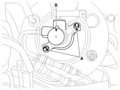

6. Remove the master cylinder (B) from the brake booster after loosening the mounting nuts (A).
Tightening torque:
12.7 - 16.7 N.m (1.3 - 1.7 kgf.m, 9.4 - 12.3 lb-ft)
[2.4 GDI]
pic 6
[2.0 T-GDI]
pic 7

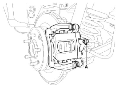

2. Have someone slowly pump the brake pedal several times, and then apply pressure.

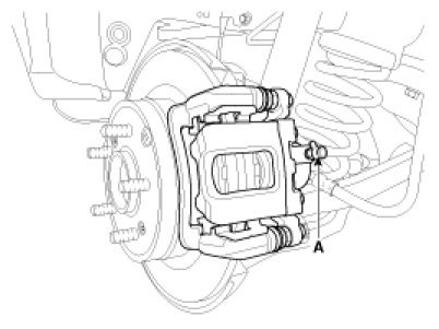

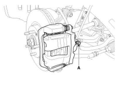

3. Loosen the right-rear brake bleed screw (A) to allow air to escape from the system. Then tighten the bleed screw securely.
Front
pic 8
Rear
pic 9

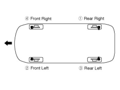

4. Repeat the procedure for wheel in the sequence shown below until air bubbles no longer appear in the fluid.
pic 10
