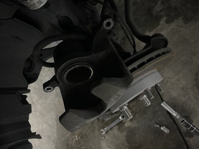

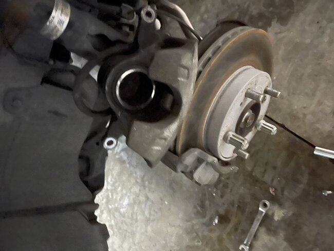

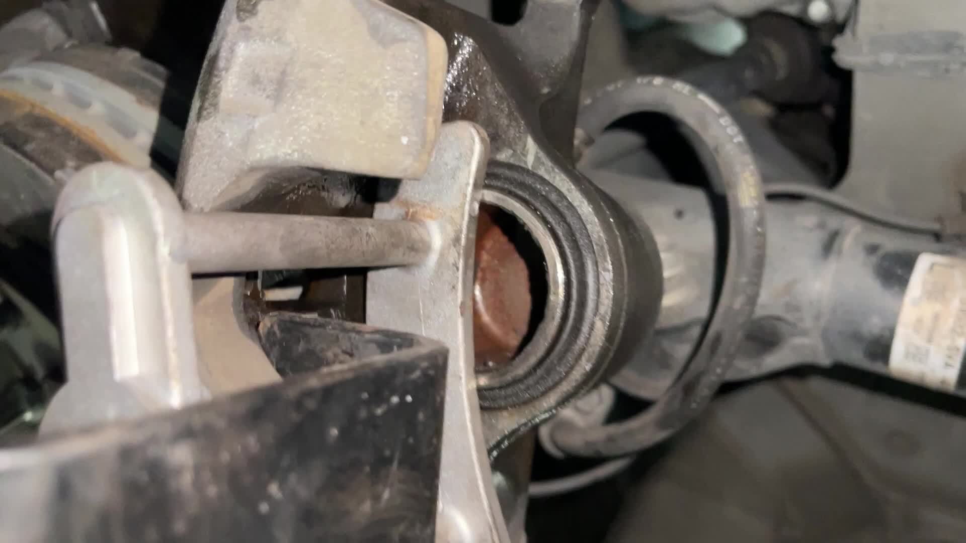

More findings. So after i lifted the car i put it in gear to see what happens and the left wheel was wobbling so bad i thought maybe the wheel bearing is bad. Removed it and it looks like someone just installed new rotors and pads. So i removed the caliper and pressed the brakes and it didnt move, not sure if its a caliper issue or if they opened the lines when they did the work. While the wheel is turning when in drive and while i press the brakes the wheels keep moving have zero brakes.

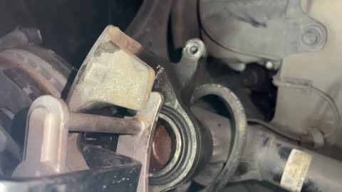

Check this out please.
Apr 18, 2025 at 6:50 AM
  • 55,851 POSTS
No that is not normal, it looks like the caliper can be sucking air back into the system when the brake pedal is let off. I would do the vise grip trick but, on all wheels, to see if the problem is with the calipers or brake master.

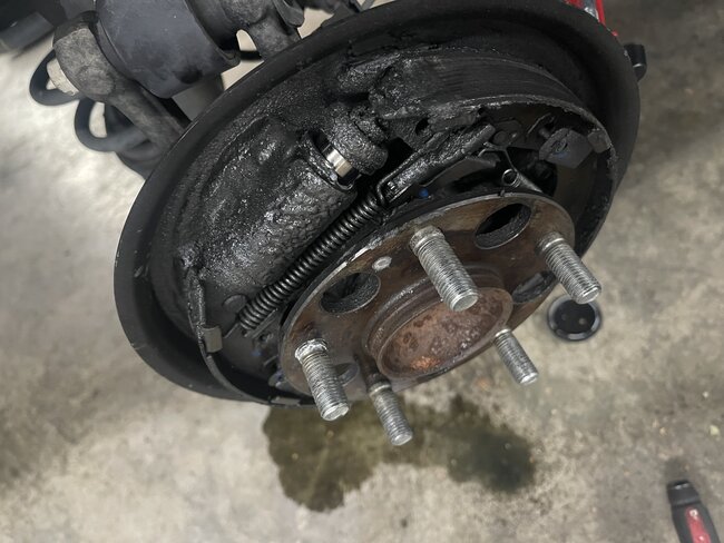

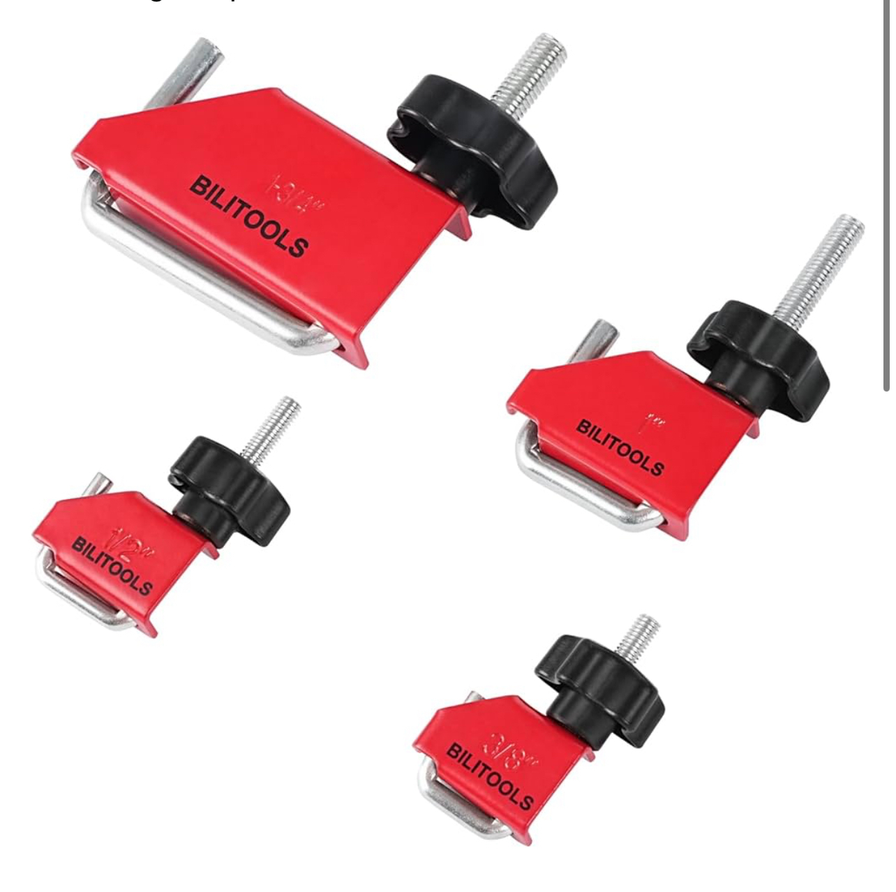

So, i got me a set of these in the picture instead of the vise grips. Once i blocked all 4 pedal gotten better, removed one at a time and when i did it to one of the rears all the pressure went there and i saw it leaking, removed the drum and holy crap lol. That doesn't look good. Leaking and nothing left on the shoes.
Apr 28, 2025 at 7:00 AM
  • 55,851 POSTS
Wow, that is not good, it looks like you found the problem.
Apr 29, 2025 at 2:42 AM
BHAMDOC1973
  • 2,007 POSTS
I am replacing both sides with all new stuff.
