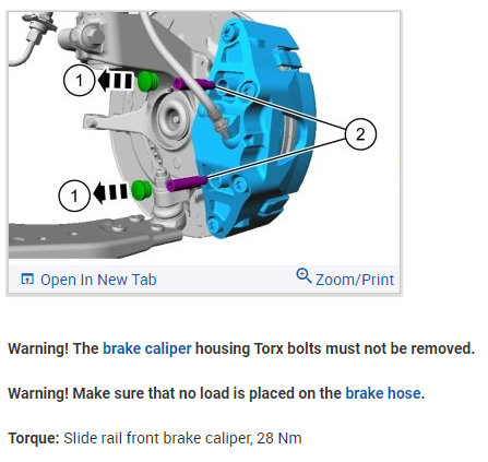

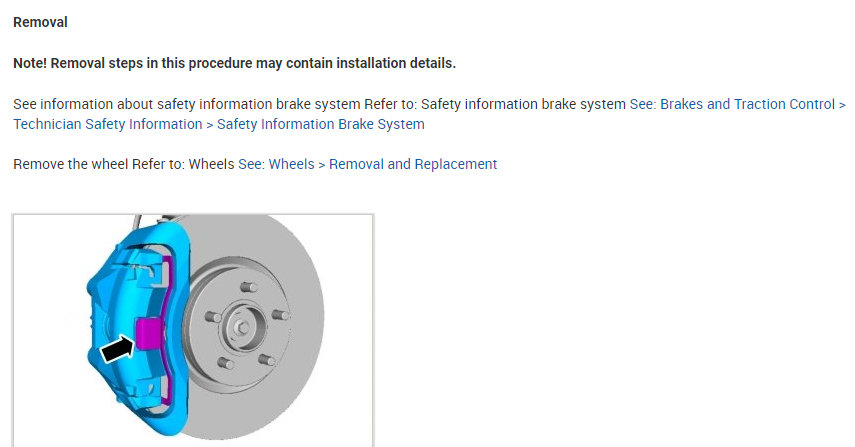

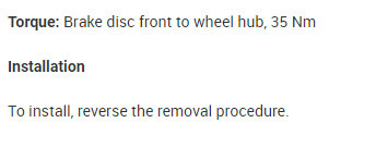

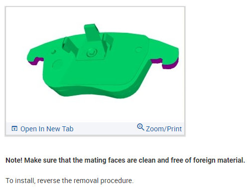

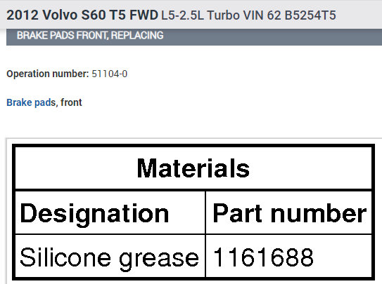

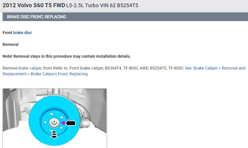

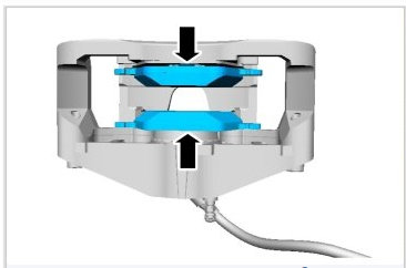

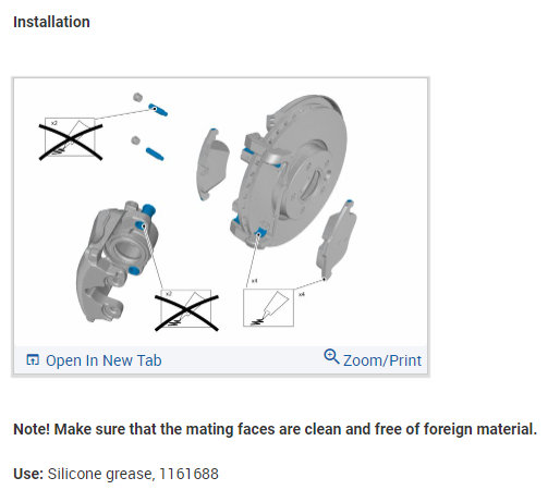

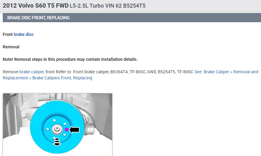

My brake pad came off. From looking at the way the pad "set" I suspect it was not properly installed. I have a new one now. How can I do the job myself?
Dec 3, 2018 at 8:20 AM
DANNY L
  • 5,648 POSTS
Hello, I'm Danny.
Sorry to hear about the improper brake installation. This is the correct way. Here is a tutorial showing what is involved on how to change front brake pads and brake rotors:
I've attached picture steps below on how to change the front brake pads and rotors on your vehicle. Hope this helps and thanks for using 2CarPros.
