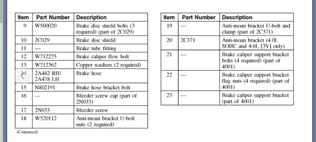

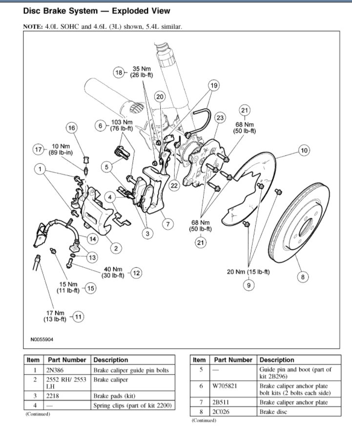

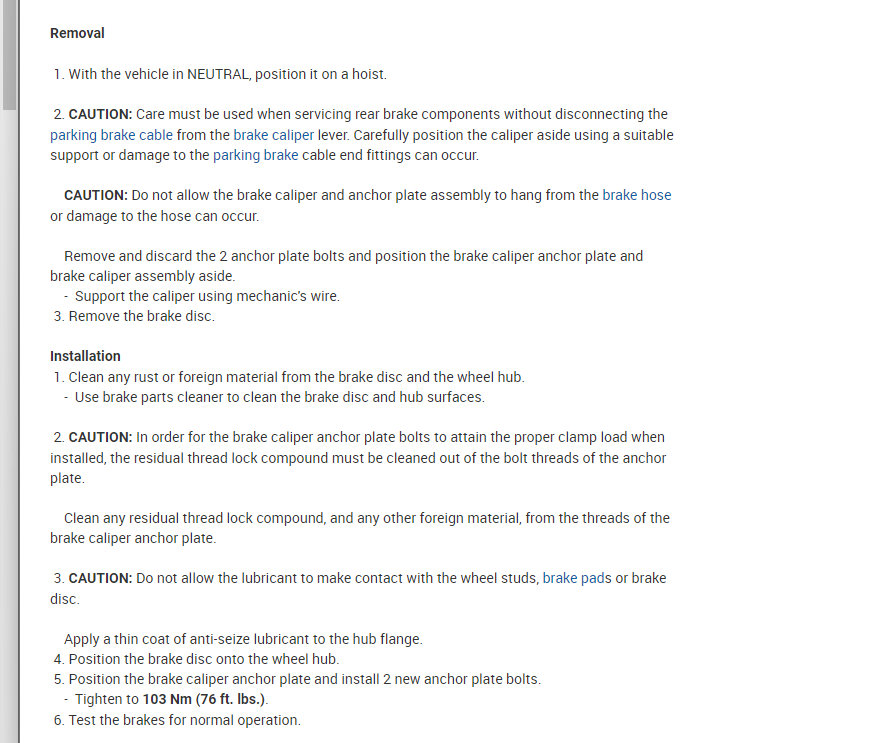

Also, I attached the info from the manual, but it sounds like you don't need it.
