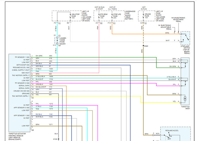

I would start by checking the VEH stop fuse on the left side of the dash, the ETC/ECM and STOP LPS fuse int he fuse panel under the hood, and lastly the CRUISE fuse which is in the left side interior fuse panel as well, this guide can help and I included the cruise control wiring diagrams so you can see how the system works.
Also, did you use and name brake replacement part? Check out the images (below). Please let us know what happens.

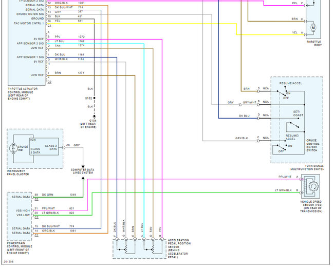

hmm,, nice clue :) Do you have a "check engine" light on? If so, the problem can be the throttle actuator. If not, I would lean towards the switch, this is a connection problem which can be tough to track down. I can provide the wiring diagrams and a guide if you want to test the wiring and connections?
Jul 1, 2025 at 11:36 AM
TSCOTT5
  • 11 POSTS
No check engine light! I haven't noticed any throttle issues, maybe a little odd once and a while at idle when it first starts up, but I might just be imagining that. I was hoping it wouldn't be wiring haha. Yes, diagrams would be great. thank you!
Jul 1, 2025 at 11:52 AM
  • 55,423 POSTS
Yep, it sounds like a loose ground or the switch but here is the check wiring guide and the cruise control wiring diagrams so you can see how the system works and which wires to test.
