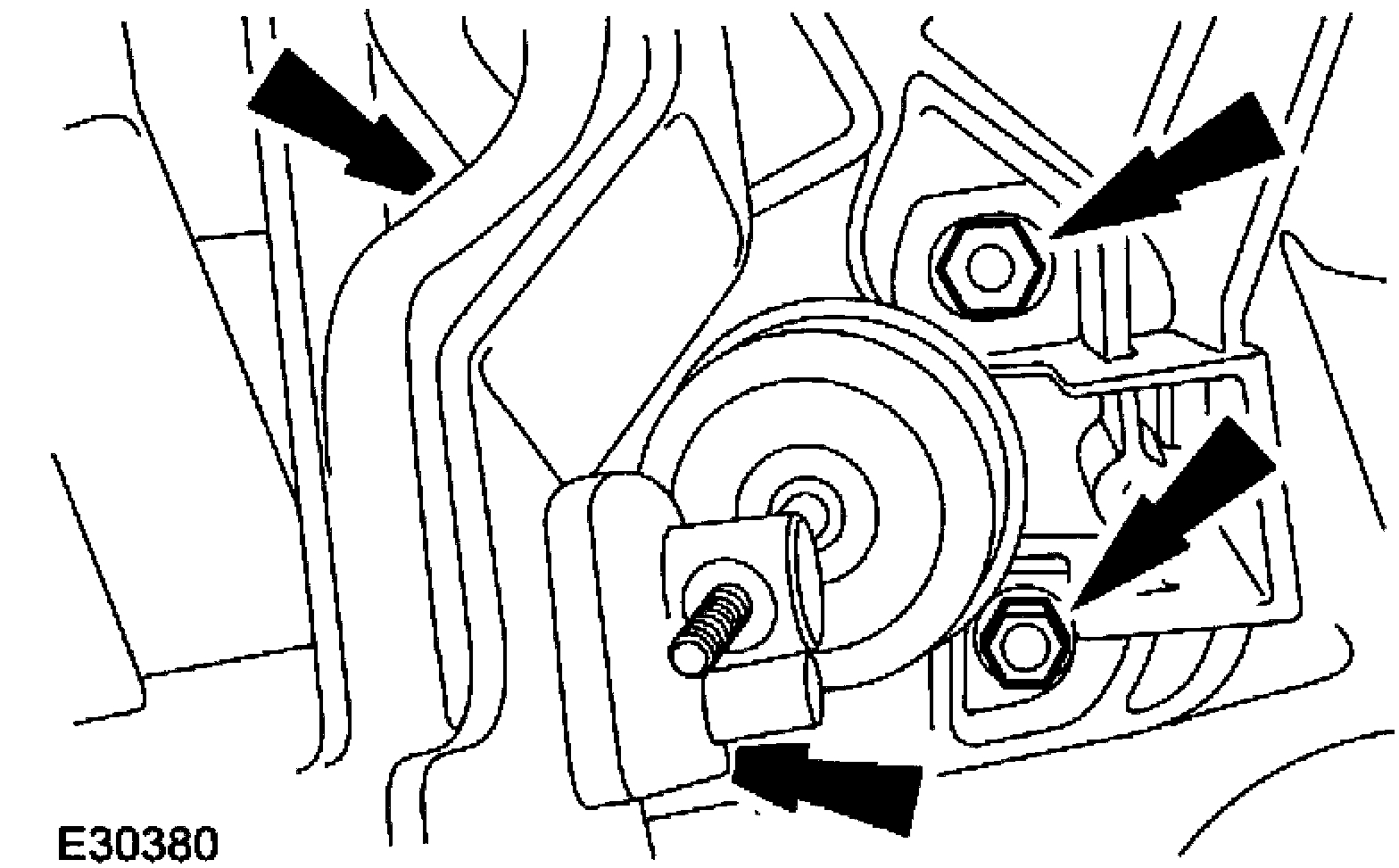

If you determine the brake booster is bad, here are the directions for replacement. The attached pictures correlate with these directions,
_______________________________
Brake Booster
Removal
1. Remove the brake master cylinder.
See Picture 1

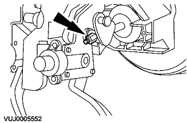

2. Disconnect the brake booster pedal travel sensor and brake booster solenoid electrical connectors.
See Picture 2

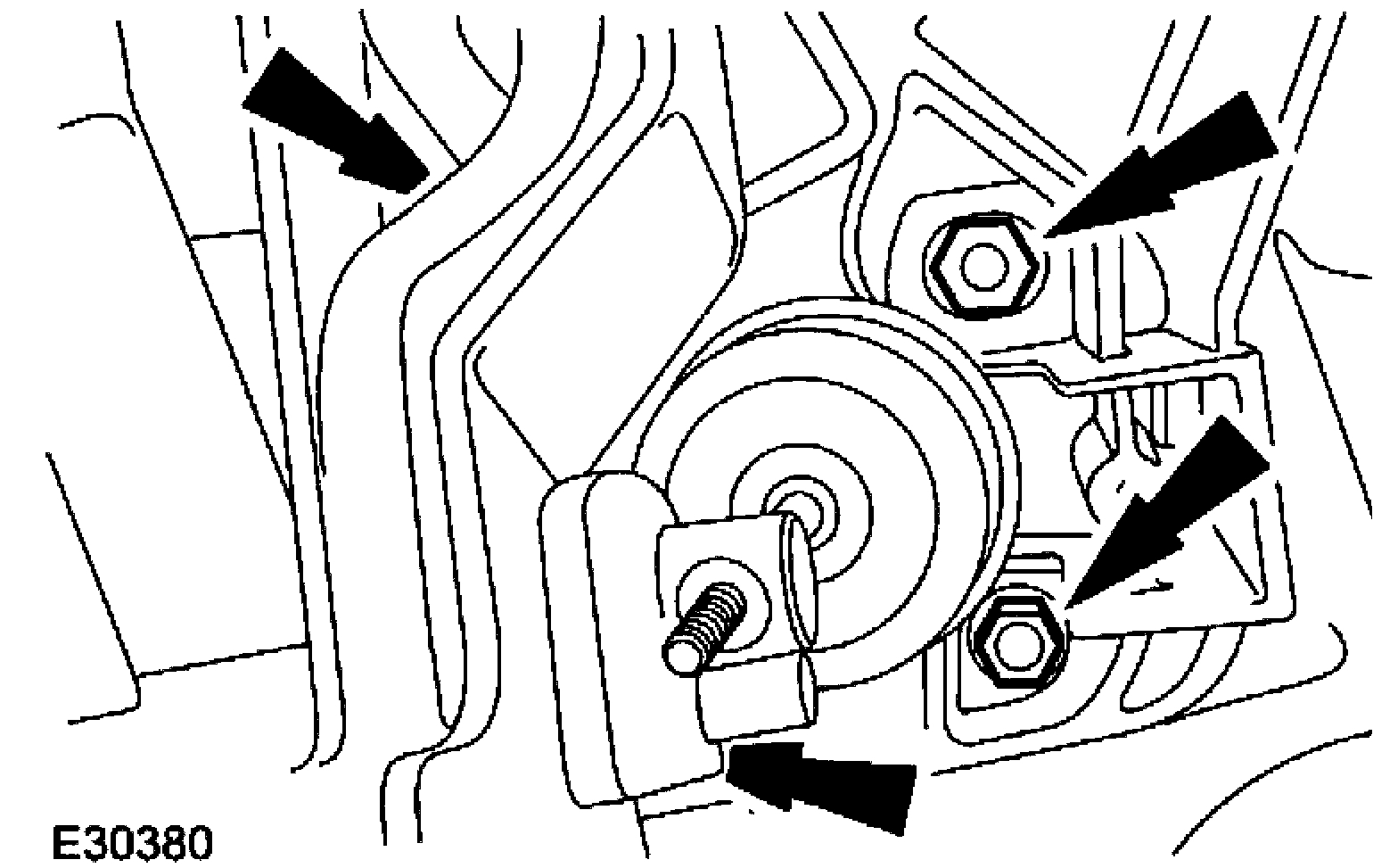

3. Remove the brake booster retaining nut.
See Picture 3
4. NOTE: The non-return valve and vacuum pipe assembly should be removed with the brake booster.

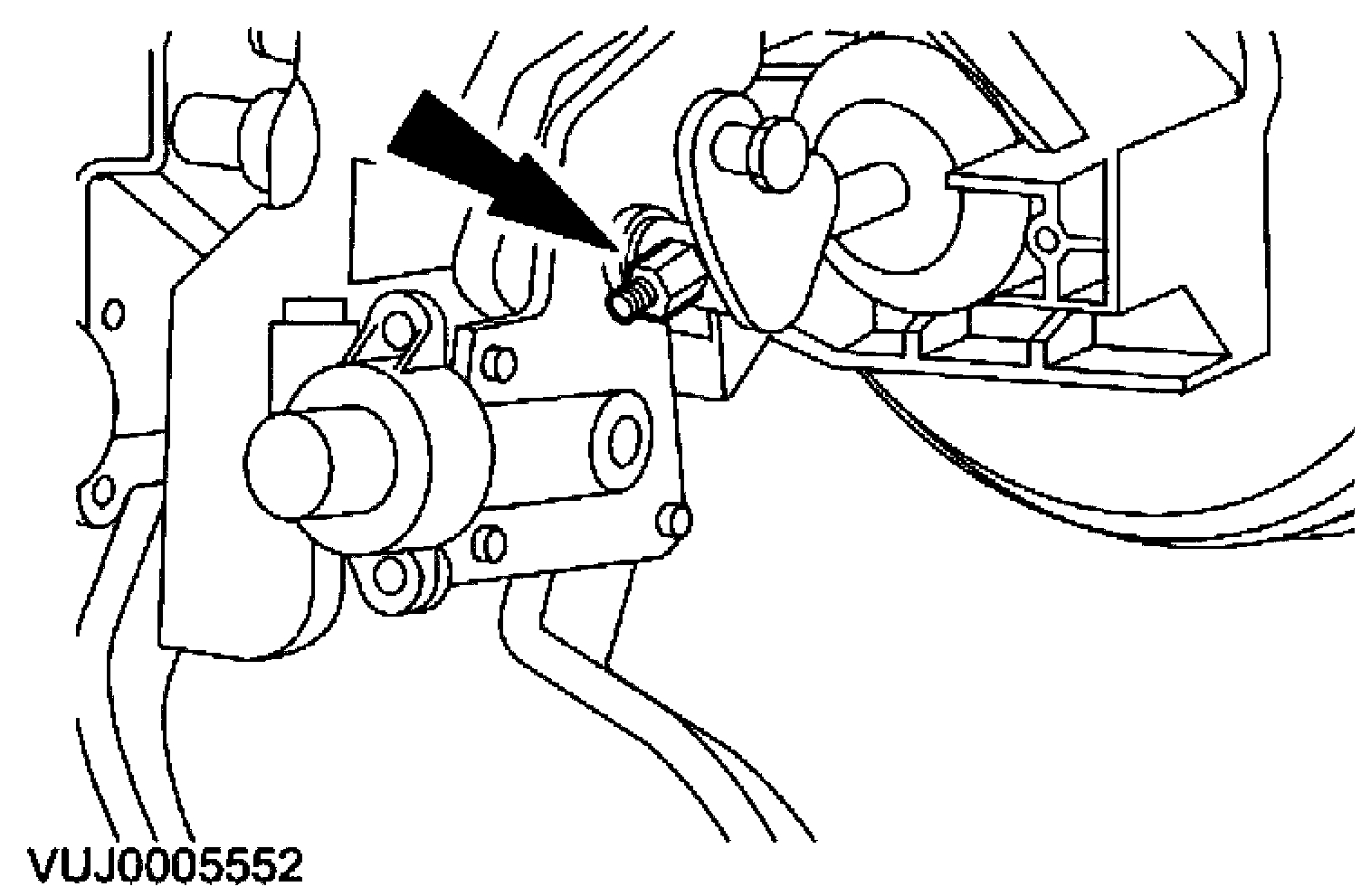

Installation
See Picture 4
1. NOTE: When renewing the brake booster, the non-return valve and vacuum pipe assembly should be installed prior to the brake booster installation.
NOTE: Replace the brake booster/pedal box gasket.
To install, reverse the removal procedure.
^ Tighten to 25 Nm.
