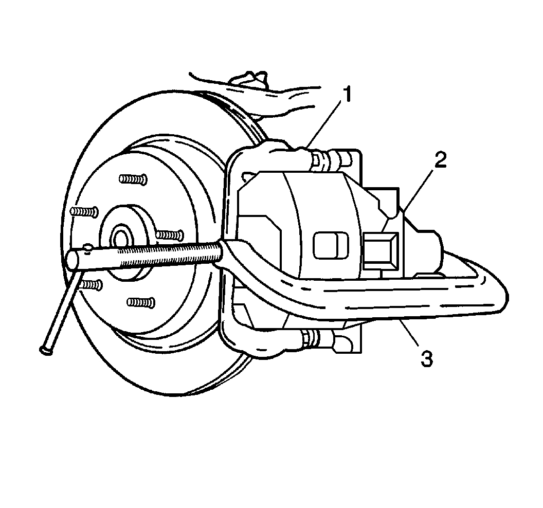

6. Compress the caliper piston enough for clearance. Use a C-clamp (3).

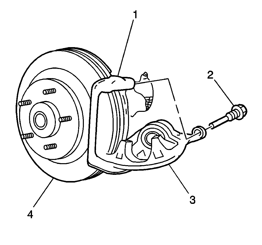

7. Remove the upper caliper bolt (2).
Caution:
Use care to avoid damaging pin boot when rotating caliper.
Caution:
Support the brake caliper with heavy mechanic wire, or equivalent, whenever it is separated from its mount and the hydraulic flexible brake hose is still connected. Failure to support the caliper in this manner will cause the flexible brake hose to bear the weight of the caliper, which may cause damage to the brake hose and in turn may cause a brake fluid leak.
8. Pivot the caliper down in order to access the pads. It is not necessary to remove the caliper.

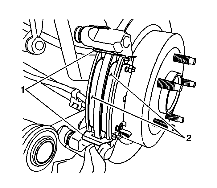

9. Remove the brake pads (2) from the caliper bracket.
10. Remove the 2 pad clips (1) from the caliper bracket.

1. Bottom the piston into the caliper bore.
Use a C-clamp before installing new brake pads in order to compress the piston. Use an old brake pad or wooden block across the face of the piston to avoid damage to the piston or the caliper boot.
2. Install the 2 retainers (1) to the caliper bracket.
Note:
The wear sensor is on the outside pad. The sensor is positioned at the trailing or downward edge of the pad during forward wheel rotation.
3. Install the pads (2) to the caliper bracket.

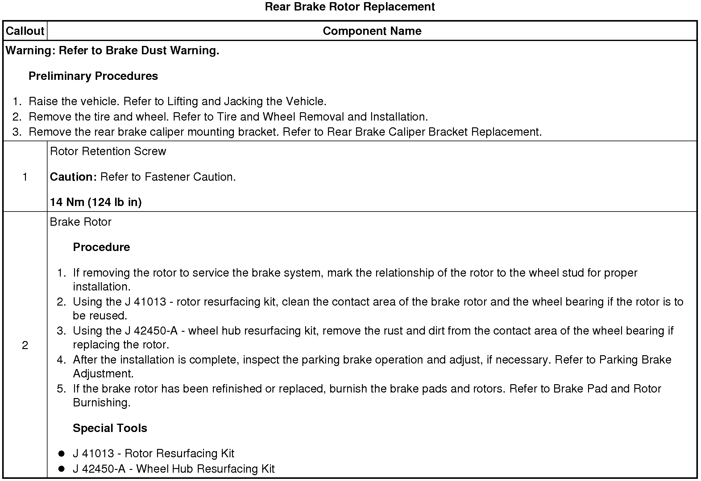

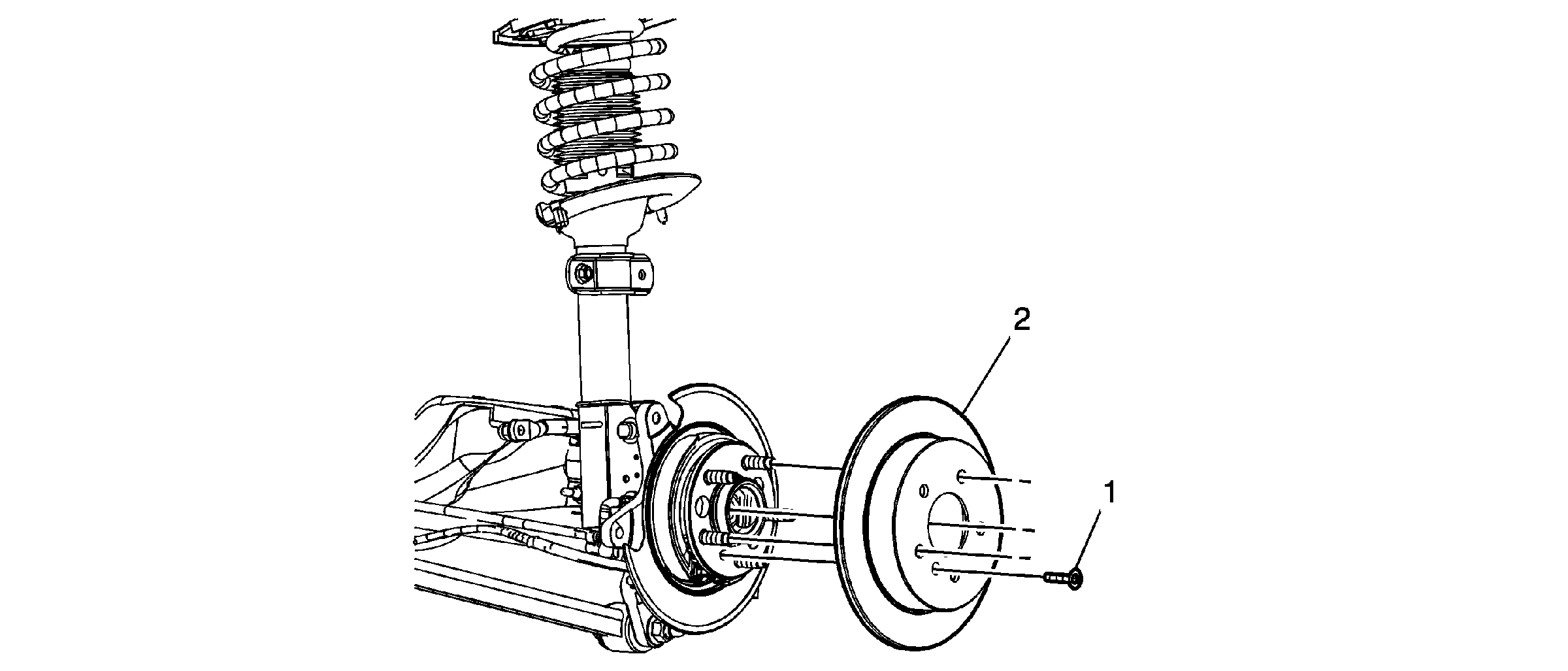

Rotor Replacement
2012 Chevrolet Impala V6-3.6L
Rear Brake Rotor Replacement
Vehicle Brakes and Traction Control Disc Brake System Brake Rotor/Disc Service and Repair Removal and Replacement Rear Brake Rotor Replacement
REAR BRAKE ROTOR REPLACEMENT
