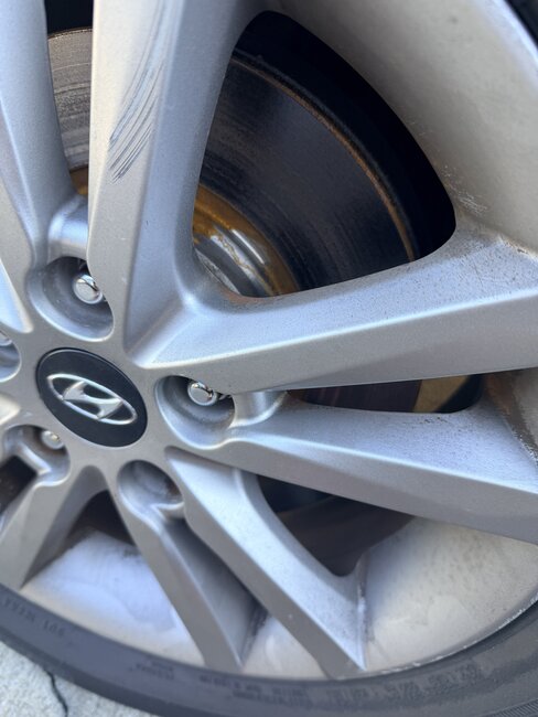

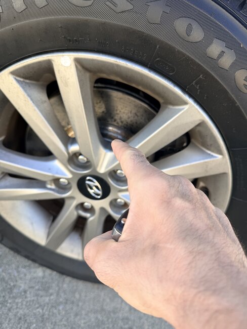

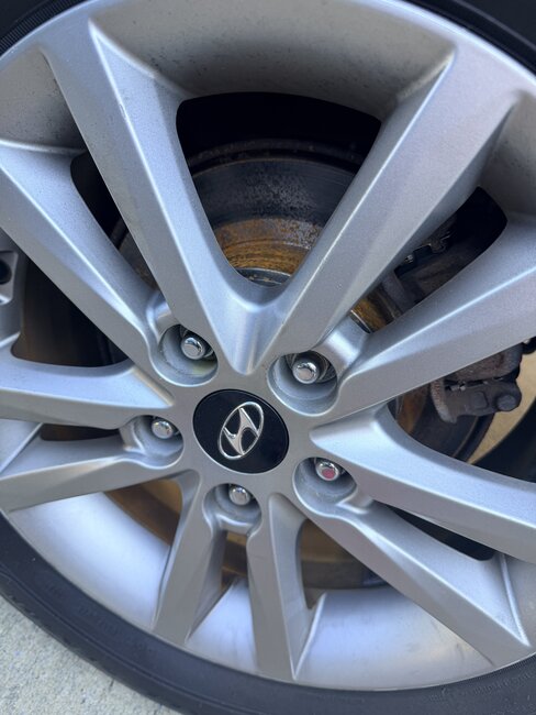

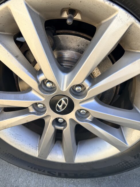

Bought it with shimming brakes. Replaced front brakes and rotors, greased all pins, some of them were lightly sticky, nothing crazy. Also replaced rear brakes and rotors. Since then the pedal has been sinking unless you pump it. Brake fluid is full.
I see that the passenger side rotor hardly has any marks compared to the rest. unless am imagining. Just need another set of eyes and what would the first thing that comes to mind in this case? First picture is passenger front where my finger is pointing, rest are for the other wheels

I have jacked uo frobts and they both stop fine when brakes applied. Regreased pins again just in case. Jacked up rear and applied brakes and both wont move with brakes applied

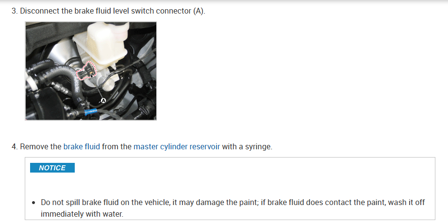

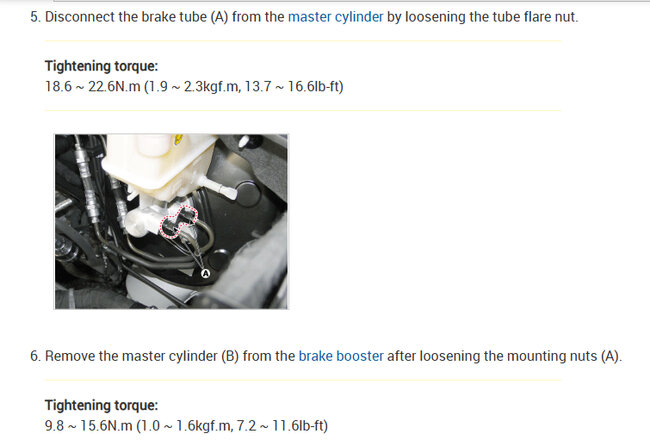

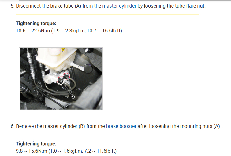

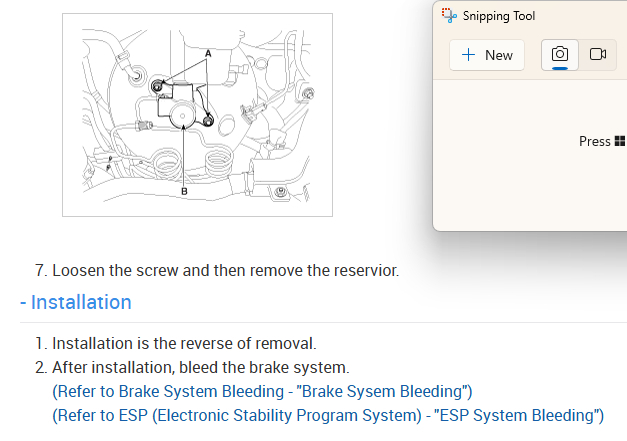

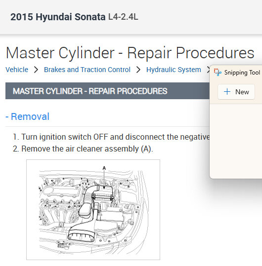

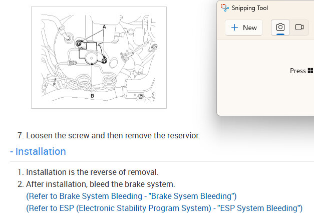

If the brake pedal slowly goes to the floor when you apply pressure, chances are it is a faulty master cylinder. Fluid bypasses the plungers allowing the pedal to reach the floor.
If you are certain there are no leaks, that is where I would recommend starting. Here is a link that you may find helpful.
https://2carpros.com/articles/how-to-replace-a-brake-master-cylinder/
Additionally, I attached the directions from the manual. Let me know if it helps or if you have other questions.,
See pics below

Hmm, hard to believe it went out only after replacing rotors and brakes
