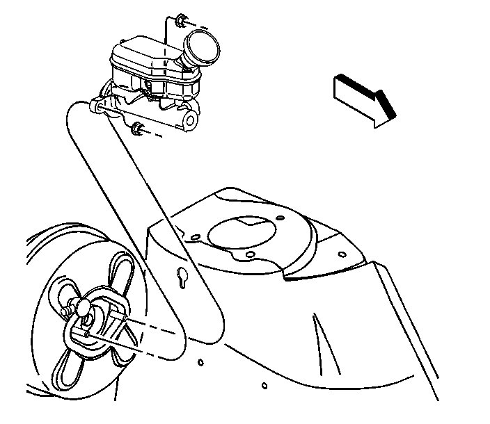

when the engine is on, the pedal goes all the way to the floor
2006 BUICK RENDEZVOUS
160,000 MILES • 3.5L • V6 • 2WD • AUTOMATIC
JESBIRDMOM
I replaced the brake pads. When the engine is off the the pedal reacts as it should, but when the engine is on, the pedal goes all the way to the floor, so it obviously wasn't the brake pads. I didn't see any leaks while it was sitting on the driveway, so I don't think it is any corroded brake lines.
I bled the front brakes, and that didn't seem to fix the issue either. Any idea what could be causing this issue?
Jun 7, 2020 at 11:16 AM
  • 110,240 POSTS
It sounds like the brake master cylinder is bad. Is the fluid level full? Also, you indicated there are no leaks. If it is full and there are no leaks, what is likely happening is the brake fluid is bypassing the piston plungers in the master cylinder. It isn't uncommon. When the engine is off, you don't have the power assist, so you may not be pressing hard enough to cause it to hit the floor.
Take a look through this link first.
https://www.2carpros.com/articles/brake-pedal-goes-to-the-floor
Let me know your thoughts on the above link. If you feel I'm correct and the master cylinder is bad, here is a link that shows in general how one is replaced:
https://www.2carpros.com/articles/how-to-replace-a-brake-master-cylinder
Again, the only way the brake pedal would go to the floor is if there was a leak, excessive air in the system (which wouldn't have happened unless the system was opened) or the master cylinder is bypassing fluid.
Here are the specific directions for your vehicle. The attached pics correlate with the directions. When replacing it, you will need to remove the reservoir from the old master cylinder and reuse it on the new one. I will attach those directions as well. And, the new master cylinder will need what is called bench bleed first before the install. Those will be last.

pic 1
1. Disconnect brake pipes from the master cylinder.
2. Disconnect fluid level sensor electrical connector.
3. Remove master cylinder mounting nuts.
4. Remove the master cylinder.
5. Drain the master cylinder reservoir of all brake fluid.
6. Remove the master cylinder reservoir.

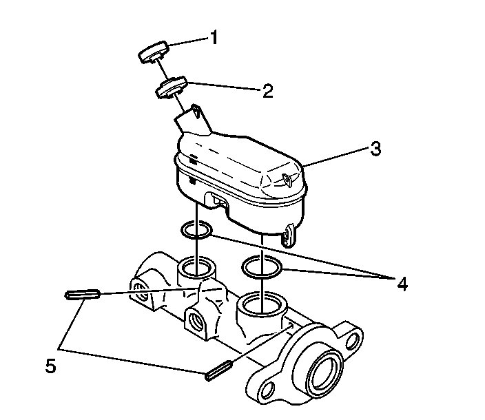

pic 2
1. Install the master cylinder reservoir.
2. Bench bleed the master cylinder prior to installation.
3. Install the master cylinder.
Notice: Refer to Fastener Notice in Service Precautions.
4. Install the master cylinder mounting nuts.
Tighten the master cylinder mounting nuts to 25 Nm (18 ft. lbs.).

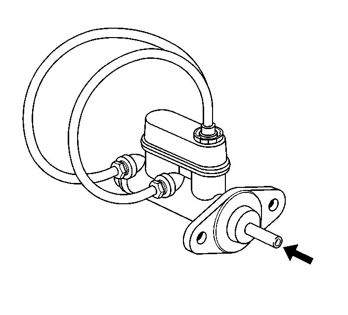

pic 3
3. Drive out the spring pins. Use a suitable punch. Do not damage the reservoir or the cylinder body when pushing out the pins.

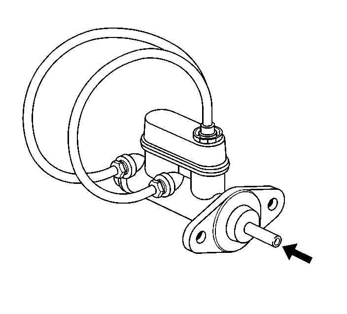

pic 4
4. Remove the reservoir body (3) by pulling the body straight up and away from the cylinder body.
5. Remove the O-rings (4) from the grooves in the reservoir.
6. Inspect the reservoir for cracks or deformation. Replace the reservoir if necessary.

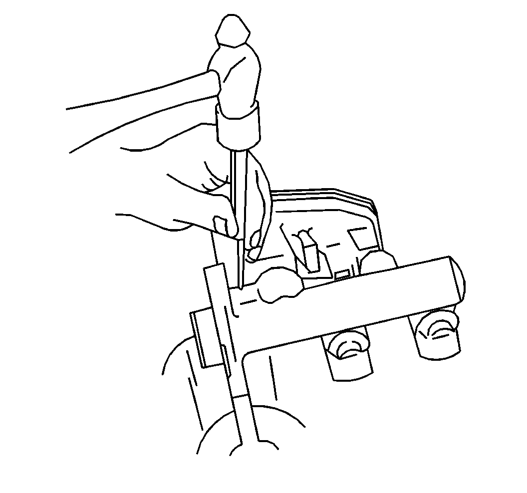

pic 5
1. Lubricate the new O-rings and the reservoir-to-housing fittings. Use clean brake fluid.
2. Insert the O-rings (4) into the grooves in the reservoir. Ensure that the O-rings are properly seated.
3. Install the reservoir (3) to the master cylinder body. Use your hand in order to push the reservoir straight down into the body.
