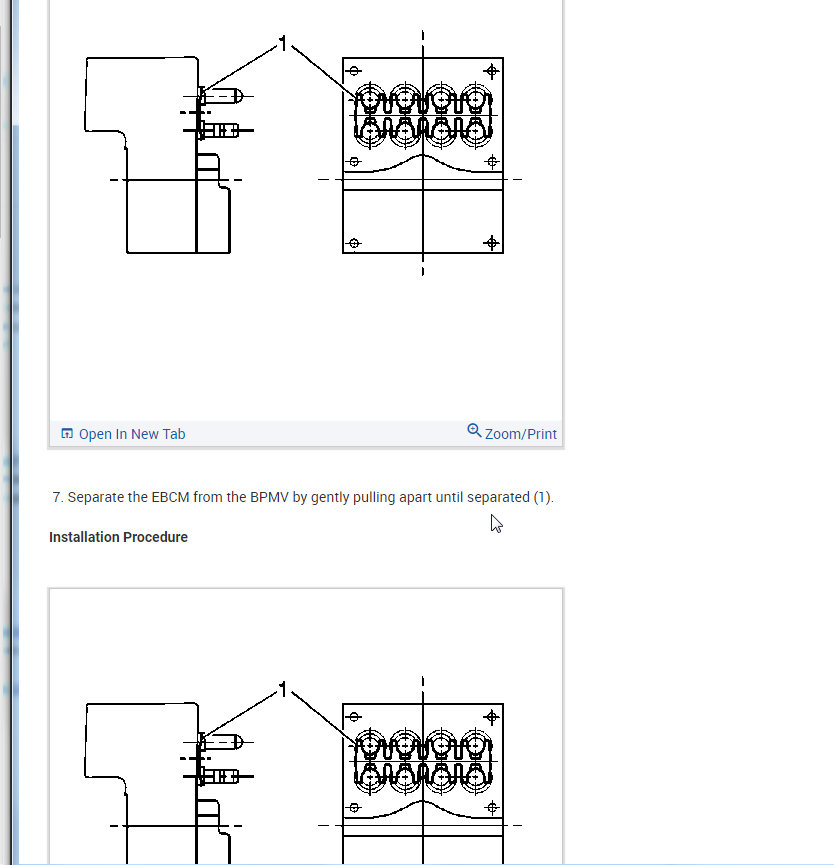

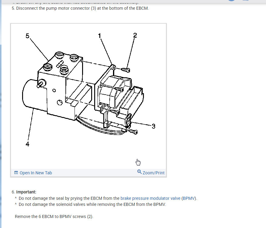

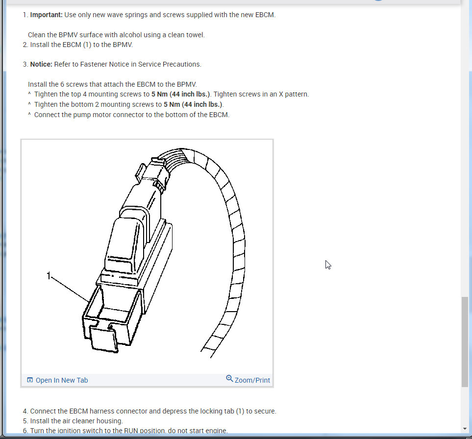

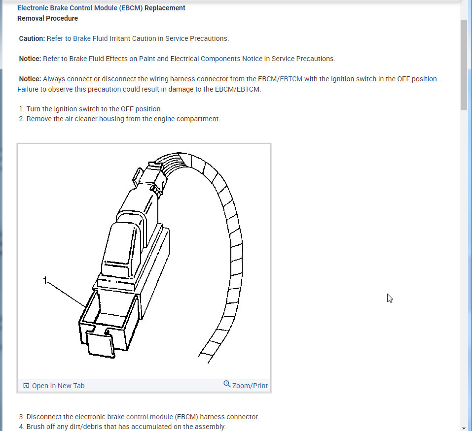

I attached the info below on this but let's start with the codes and go from there. Thanks
