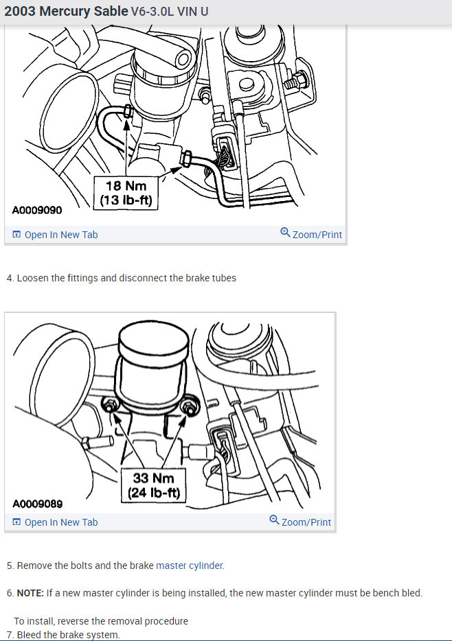

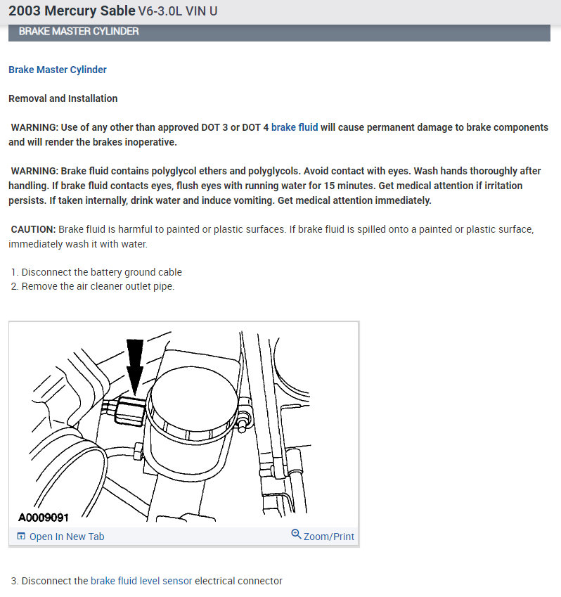

This sounds like you could have a leak somewhere is the brake system or the seals inside the master cylinder are bad and not producing any pressure.

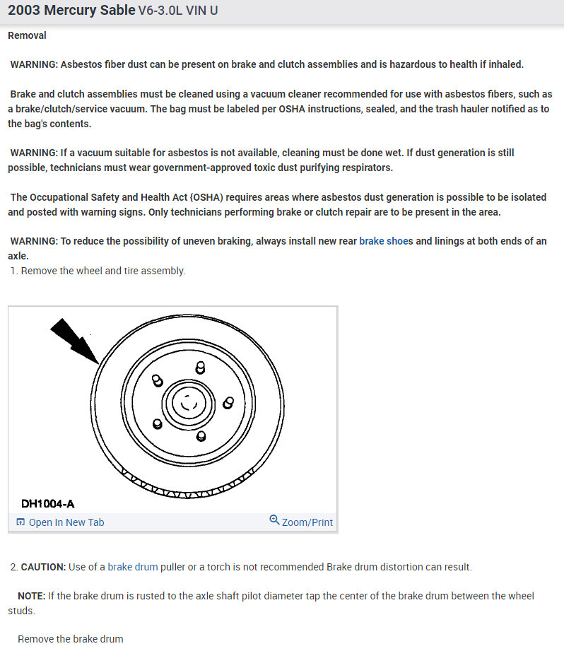

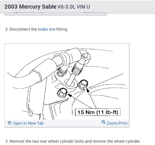

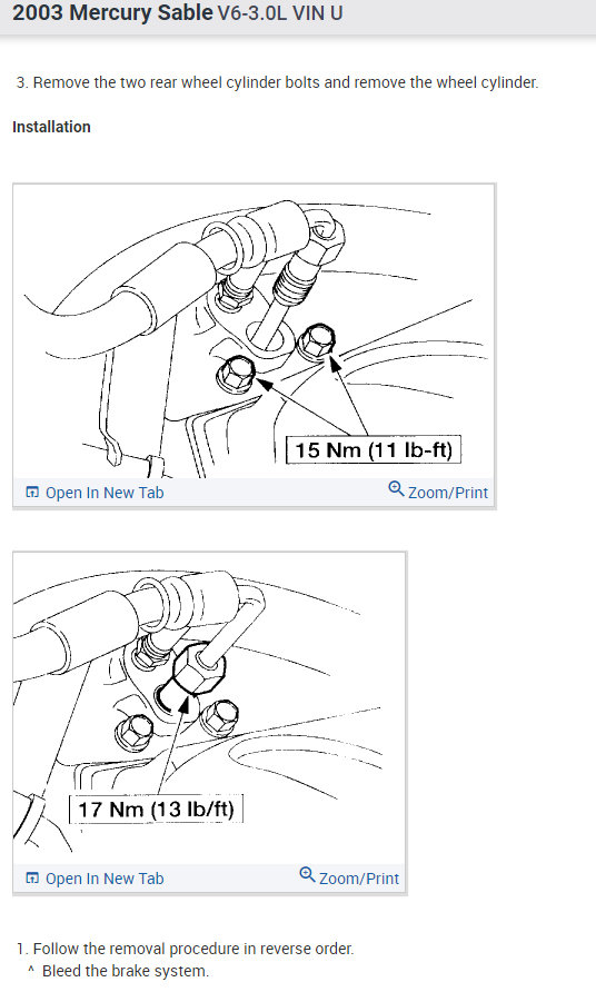

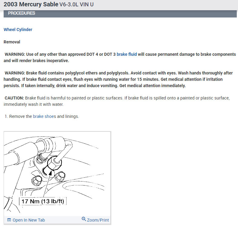

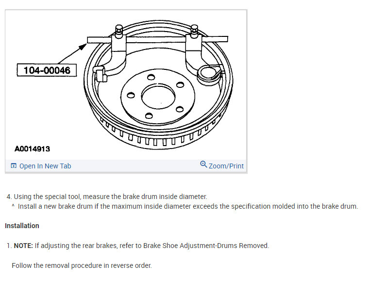

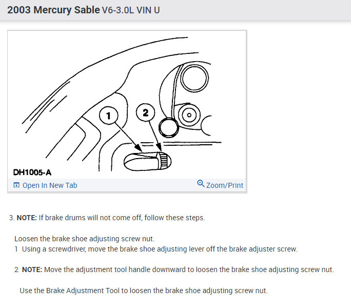

Check all the brake lines for any leaks. Pay close attention to the hoses that goes to the front calipers and the rear wheel cylinders. You might have to remove the brake drum to see if there is any leakage from the cylinder.
If the master cylinder seals go bad it will not allow the brake system to produce any pressure and the pedal will go to the floor.
