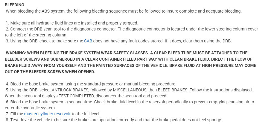

replaced all 4 calipers, master cylinder and power booster. bleed brakes. with car off good pedal. start the car and pedal goes to floor.

Did you bleed the ABS? The ABS portion of the brake system must be bled separately using a bidirectional scanner.
Take a look below. I attached the directions. Let me know if this is something you can do or have done.
You likely have air in the system.
See pic below.

bled the ABS system four times. pedal is a little better but still goes too low.

Did you follow the sequence listed in the directions? It indicates a standard bleed, then the ABS, then a standard bleed again.
What you are describing is either air in the system or a bad master cylinder. I've seen situations where the push rod between the booster and MC wasn't properly seated causing similar issues. Everything went back together easily, correct? Also, before installing the new master cylinder, was it bench bled?
