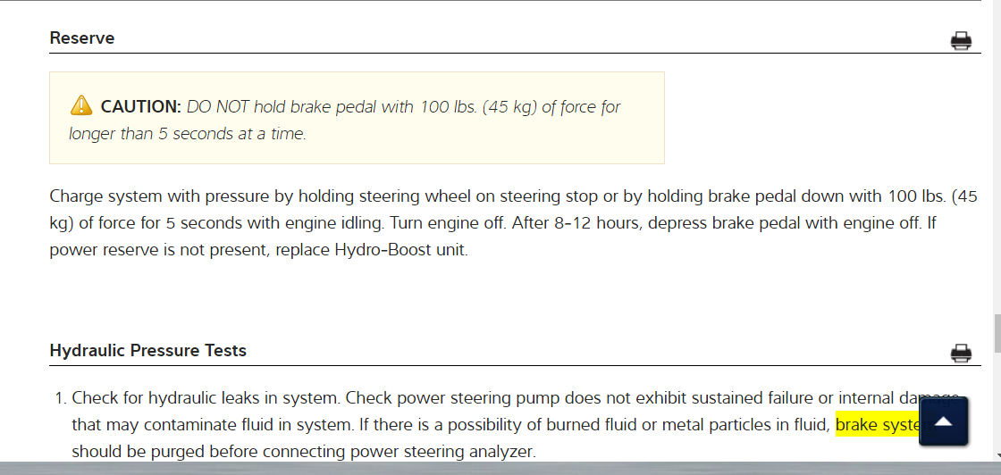

Have replaced front brakes, master cylinder, and have bleed brakes multiple times. Front passenger side wheel bearing was replaced before any other brake work was done. Have been told now to replace brake booster. Is this the next attempt to get brakes working again?

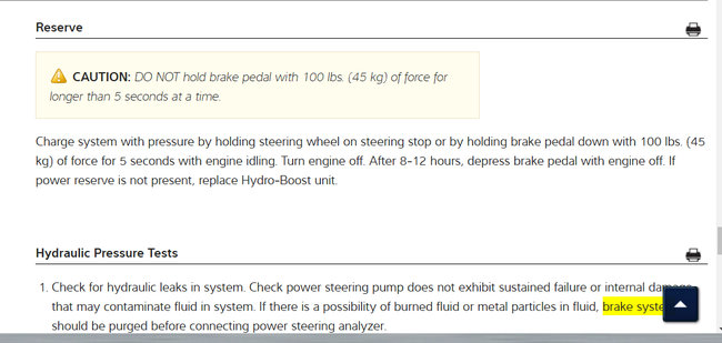

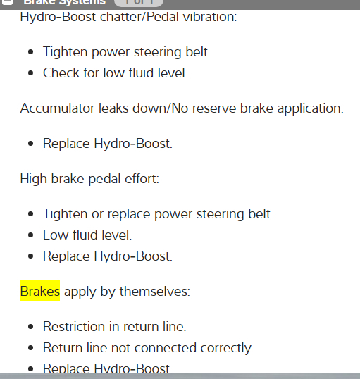

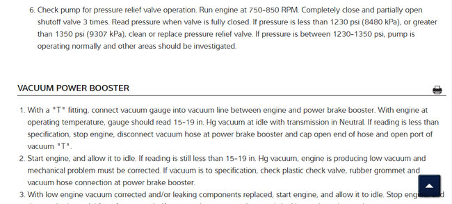

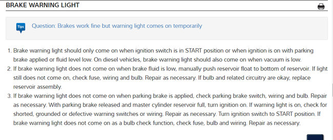

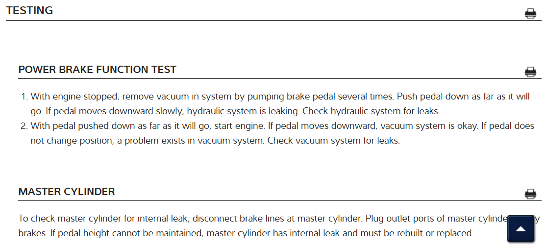

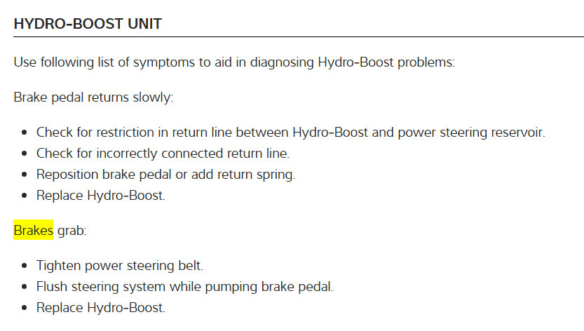

SCGRANTURISMO
  • 4,897 POSTS
Hello again,

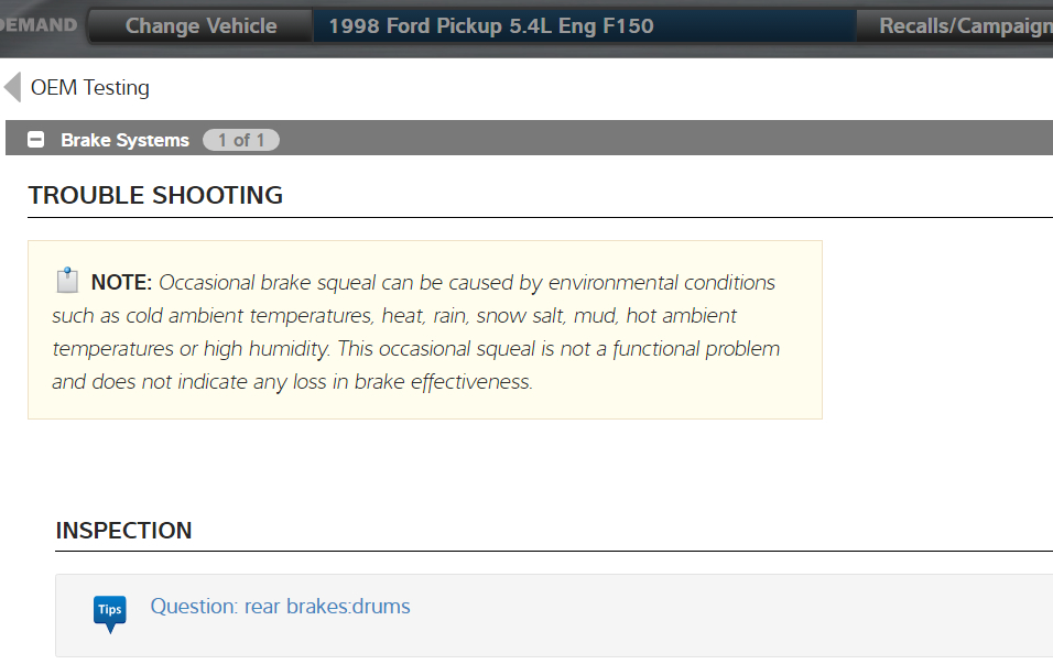

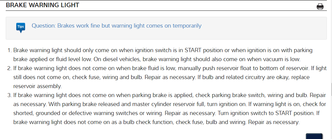

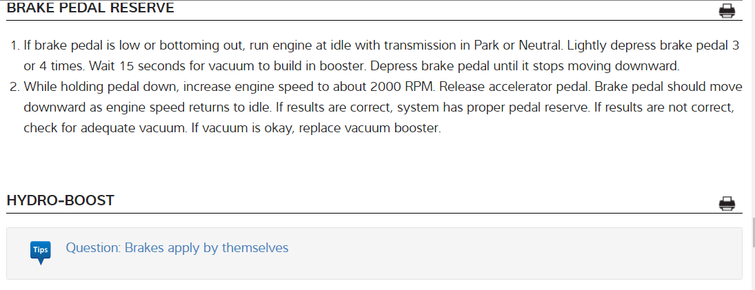

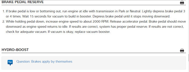

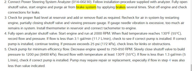

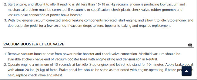

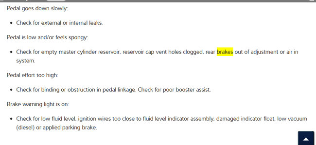

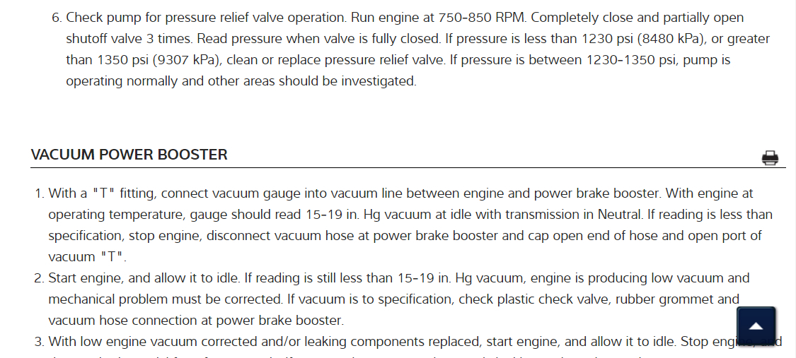

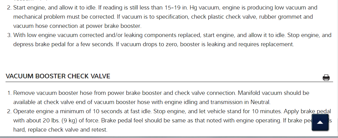

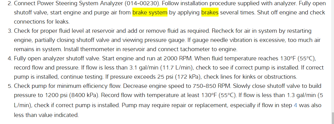

Okay, you are sure you have bled the brakes completely? You had fluid coming out of the bleeder before you tightened it back up? I would suspect there is air in the lines. These guides can help you fix it.
https://youtu.be/w7gUsj2us0U
and
https://youtu.be/WDxvEQrMkBg
and
https://www.2carpros.com/articles/brake-pedal-goes-to-the-floor

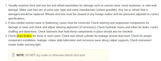

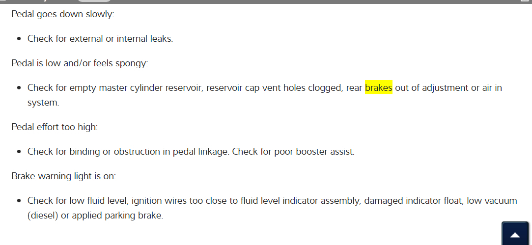

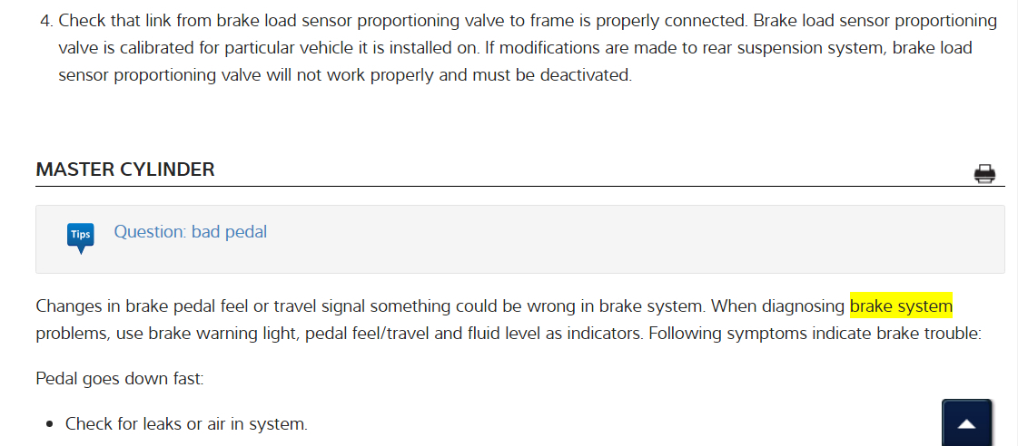

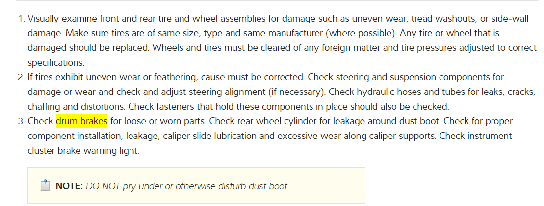

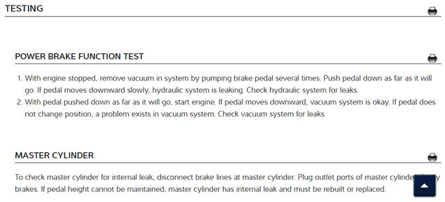

I have included the Ford Factory Troubleshooting Guide for your vehicle's brake system in the diagrams below. Please go through the troubleshooting guide and please get back to us with what you find out, please.
