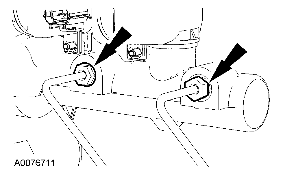

The job started with new rotors, calipers, and brake pads. I did one at a time and once all were completed i began to bleed the brakes in accordance with my manual. My pedal will easily push to the floor. After doing further research all roads ended at a bad bad master cylinder. So i replaced it and bench bled it and began bleeding brakes again. Still pedal pressed easily to the floor. I took the master cylinder off of the booster while keeping lines attached to cylinder. Removed the booster and found it to be noticeably bad due to bad rear seals. So i replaced it as well. Went to bleed to brakes again with the new booster and still brake pedal falls to the floor. I have inspected the brake lines and fittings countless times and still no leaks. I have checked the abs with a scanner and still no codes are given. At this point i have no idea what it could possibly be.

With the engine off, does the pedal pump up? Based on everything you've done, they should work and I believe you already know that. I am going to add the directions for bleeding from the manual to see if there is anything you missed. However, even if there was a bit of air in the system, the pedal should feel spongy at worst. Or if you did anything with the abs hydraulic unit, that would require a different process. I'll add both. One last thing. If the pedal goes to the floor with no resistance, are you sure everything is connected between the pedal and the master cylinder? When you bleed the system at each wheel, do you have good pressure when the fluid comes out? If there are no leaks, the push rod between the pedal and master cylinder is moving and depressing the pistons in the master cylinder, there is no air in the system, and there is no pedal, there is a chance you got a bad master cylinder.
Here is a link that discusses the most common causes of the pedal going to the floor:
https://www.2carpros.com/articles/brake-pedal-goes-to-the-floor
Here are the directions I have specific to your vehicle. The attached pics will correlate with the directions.

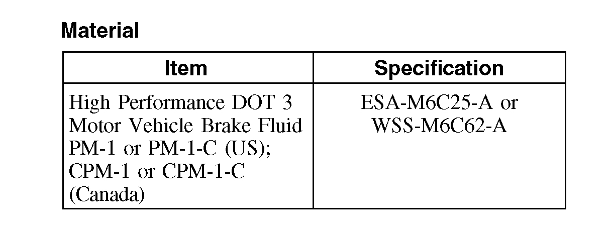

Material
pic 2

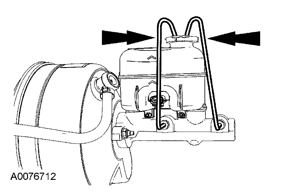

1. NOTE: When a new brake master cylinder has been installed or the system has been emptied or partially emptied, it should be primed to prevent air from getting into the system.
Disconnect the brake master cylinder outlet tubes.
pic 3
2. NOTE: Original equipment tubes are not intended to be used during this procedure.
Install short brake tubes with the ends submerged into the brake master cylinder reservoir and fill the brake master cylinder reservoir with clean, specified brake fluid.
pic 4
3. Have an assistant pump the brake pedal until clear fluid flows from both brake tubes, without air bubbles.
4. Remove the short brake tubes and install the brake outlet tubes.

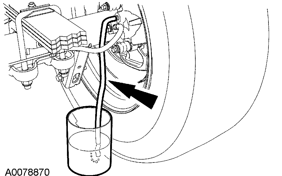

2. Connect a clear hose to the RH rear disc brake caliper bleeder screw and place the other end into a container partially filled with clean, specified brake fluid.
pic 5
3. Open the bleeder screw and leave it open until clear, bubble-free brake fluid flows.

Hey Joe, I am not able to pump up my brake pedal with the engine off to build any pressure. i did however realize a little bit ago that my front 2 calipers were backwards, meaning the bleeder was towards the bottom instead of on top. I have switched them and will begin the bleeding process again tomorrow. i have read a little bit about it and I do not know how much that would have mattered if i wasn't getting any air out of the calipers even though they were on the wrong sides. Rookie mistake i know but i guess it happens to the best of us. My scan tool is not programmed to do an ABS bleed procedure but i'm not convinced there is air in there since i was getting solid fluid flow from the rest of the caliper. I double checked my brake pedal to ensure it was connected to the boost arm, everything was they way it should be. I'll update you with more in the morning.
Mar 10, 2021 at 2:58 AM
  • 110,244 POSTS
HI:
That's the problem. If the bleeder is at the bottom, you will never get the air out of the system. I have money on that being the problem. Let me know if that takes care of the issue. And trust me, you aren't the first one who did that.
