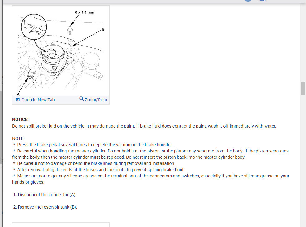

There are no leaks in any of the lines. The master cylinder has been refilled (although it was completely dry), I've owned the car for 5 years and never put any brake oil in it until now. But still no brakes, still goes to the floor. The lines have all been bleed as well. Don't know what else it could be??

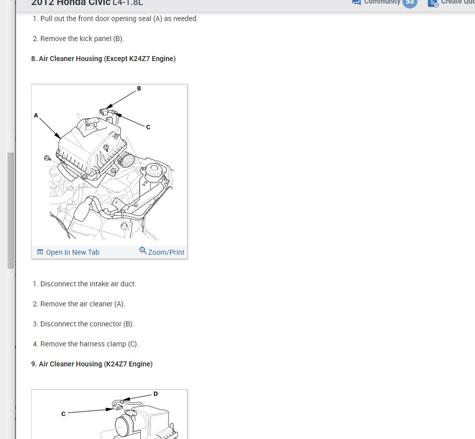

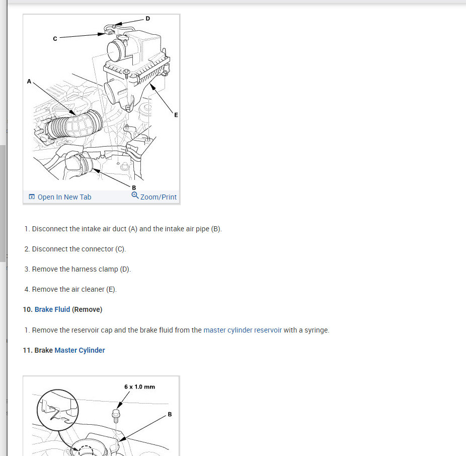

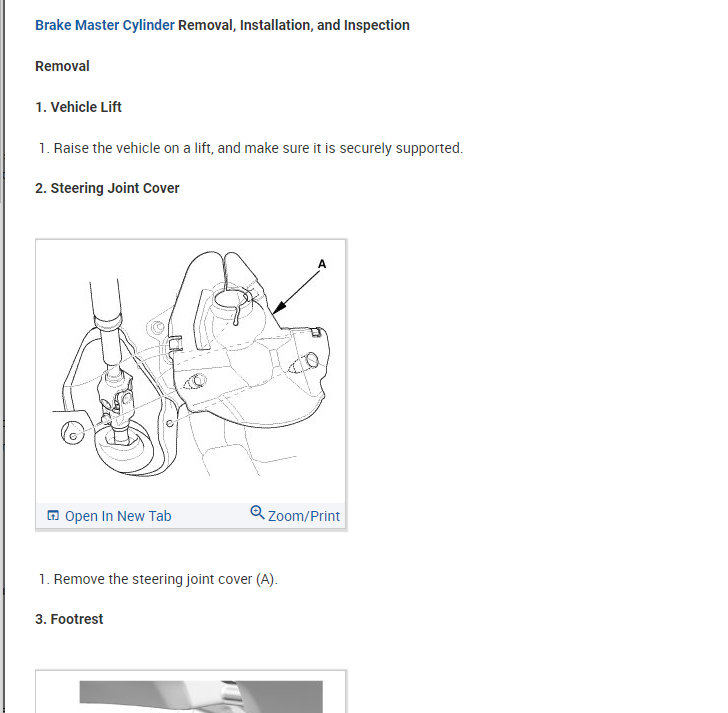

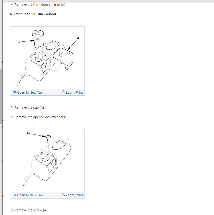

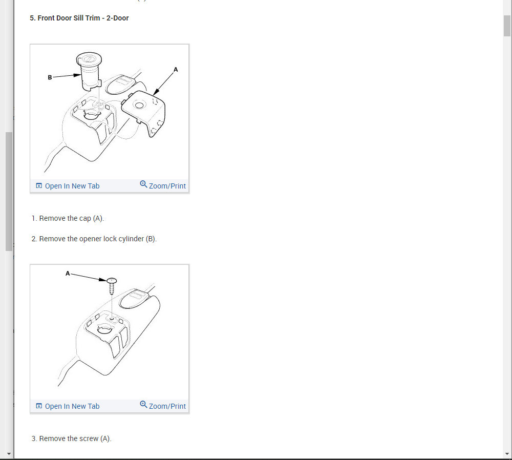

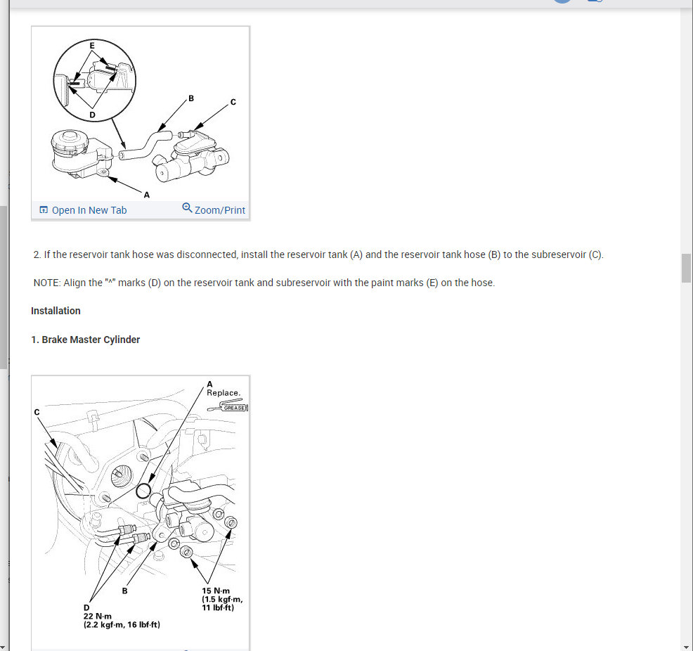

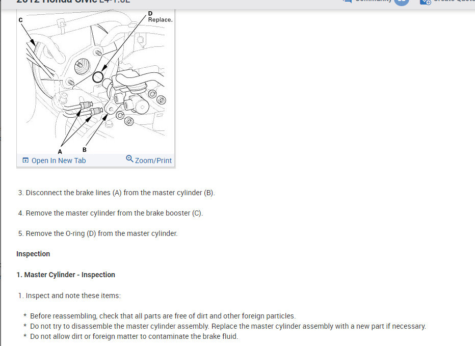

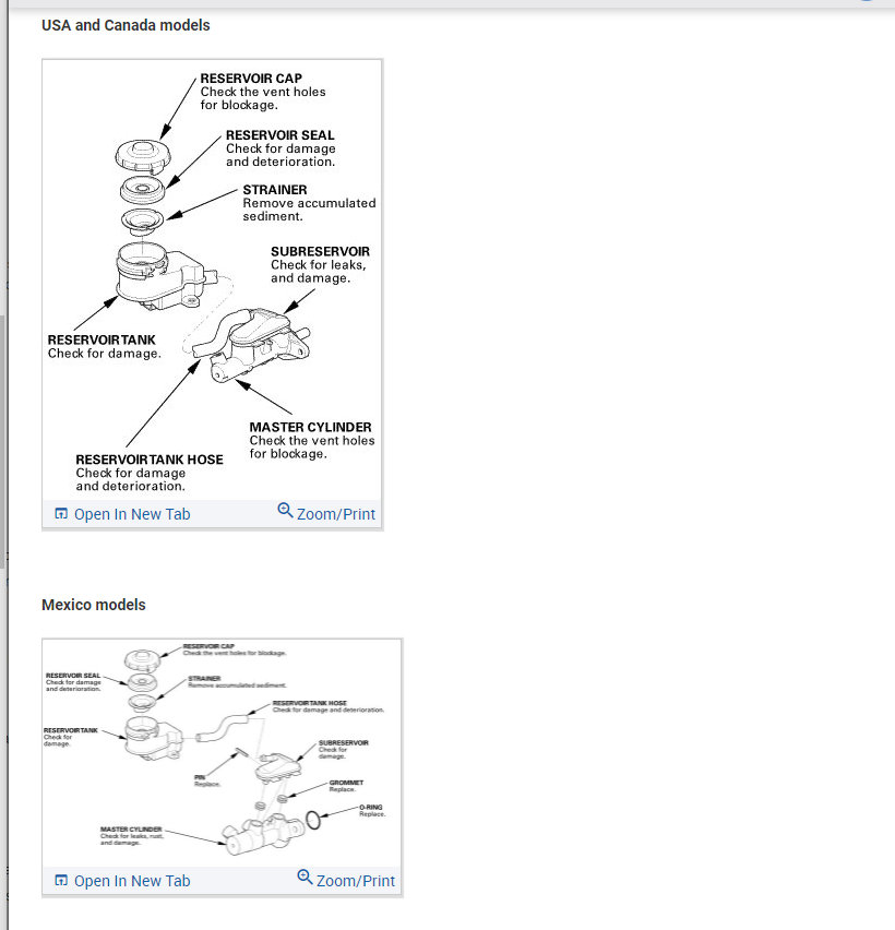

This is a sealed system so the only way the pedal is going to go to the floor is there is air in the lines, there is a leak either external or internal to the master cylinder.
Based on what you have done, you most likely have a master cylinder issue. If you want to confirm this, disconnect the lines off the master and cap the ports. This will eliminate everything but the master so if the pedal goes to the floor the it is the issue.

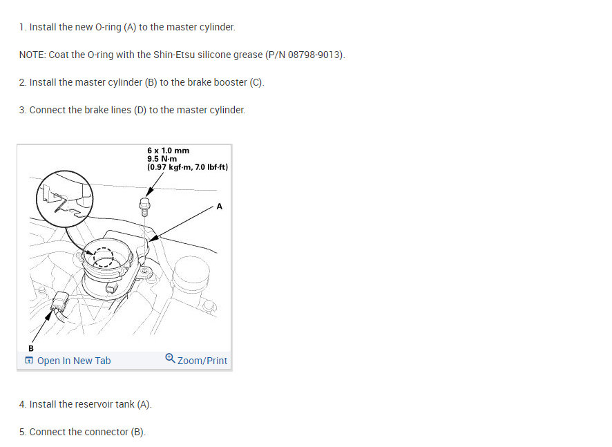

Here is a guide that will help with replacing the master cylinder as I suspect this is the issue.
https://www.2carpros.com/articles/how-to-replace-a-brake-master-cylinder

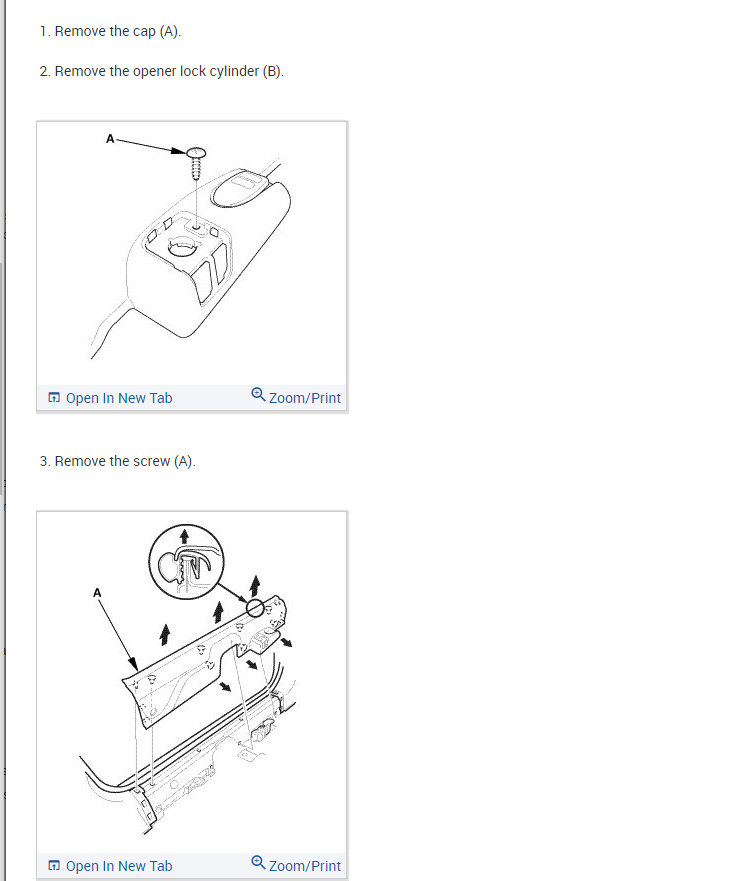

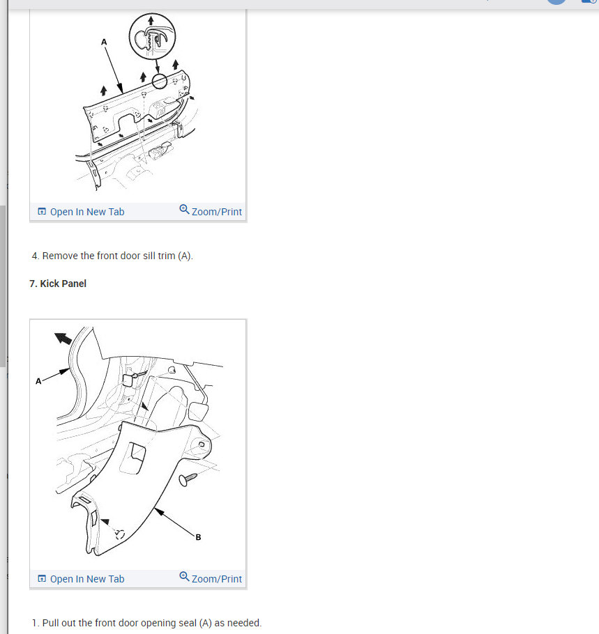

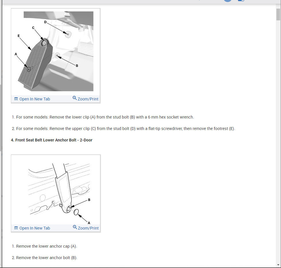

Below is the process from the manual on this. Please let us know if you have other questions. Thanks
