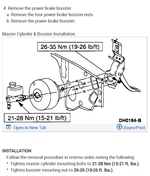

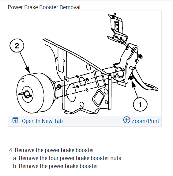

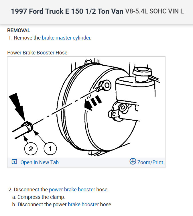

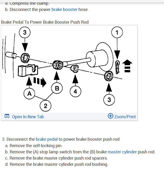

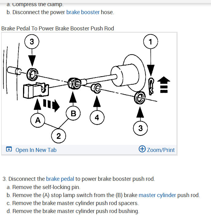

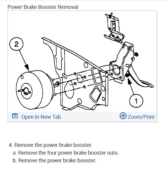

This happens when the brake booster gets moisture inside, here is how to replace the unit which should fix the problem. Check out the images (below). Please let us know what happens.
